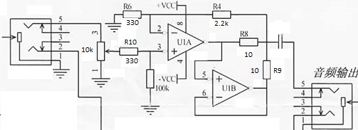

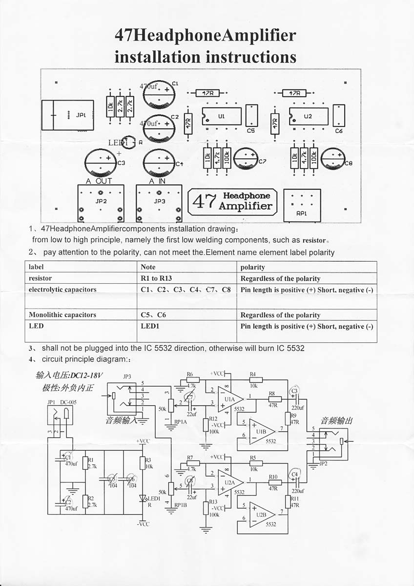

I've looked through the thread but haven't found any mention of using this OPA1622 in a classic 47 amp circuit. This might be because using two op amps is unnecessary for the 1622, although I see Jacken has done four in parallel so maybe it can be a good implementation for basic diyers like me? I also use HD650 so.... I'm curious to try and run them from an LiFePO4 battery pack of about 16.5V. Below are the instructions for the usual cheap kit on Ebay etc. I think I would also like to try a version with a dual rail supply.
I guess the 1622 would like R4/R5 (the feedback loop resistors) to be 2.8K and the R6/R7 to be about 560R for gain of 6? What about the 47R load sharing resistors (R8-11) - what value would be ideal?
Thanks for any/all help!
John, I can now confirm that putting four OPA1622 op amps in parallell works like a dream! When driving 300 Ω Sennheiser HD650, it sounds wonderful. The old version with 2 output driver struggled a bit with high gain, but with four it's working perfectly. Who knew that the HD650 could handle base so well.

Specifically, any comments on this? (Apart from comments on the obviously crude image, for which I apologise - MS Paint only on this machine). I gather a gain of 7.5 will mean R4 needs a small bypass cap of about 100pF? The output coupling cap will be removed for a split rail supply.
