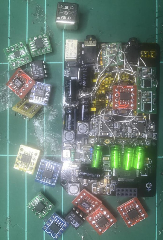

Yes, they are awesome as little building blocks, I probably bought around half a dozen of these by now. And yes, connected to ground.
No, I did not notice change as I never listened to them in their "stock" configuration.
Will post photo later, although it's very guerrilla DIY
Looks good, so if this is a Digital Audio Player
There, 3 OPA1622 in AK4497 based DAP.
the input would be audio files from a storage device and this will do all processing to analogue?
Yes, indeed.
What is on the photo is an analogue board from Zishan DSD DAP, AK4497 based version.
Google it to get some pics and better impression of the features.
Ah so there is another board for SD card, display, controls, makes sense now.
I finished connecting a couple OPA1622 chips to ground and did some comparison to the remaining ones, its certain the voltage divider is not helping performance. I can understand now why the OPA1622 is a good choice for driving headphones directly.
Absolutely!I can understand now why the OPA1622 is a good choice for driving headphones directly.
Especially low-impedance ones, high supply current + low output impedance make it one of the best in class, if not the best.
I have a pair of DIY single-BA driver IEMs, based on Knowles RAB-32257, they sound absolutely atrocious with any source where output protection resistors are utilised, but with OPA1622 they transform into very clean, even, detailed and even have decent bass.
Unfortunately manufacturers could be somewhat conservative and offer aged but tested (and sometimes cheaper) solutions, I wish there was less lag in adoption of something like OPA1622, luckily I can DIY retrofit it into designs that allow for it
