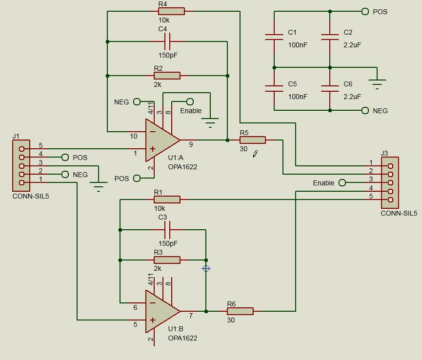

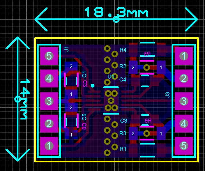

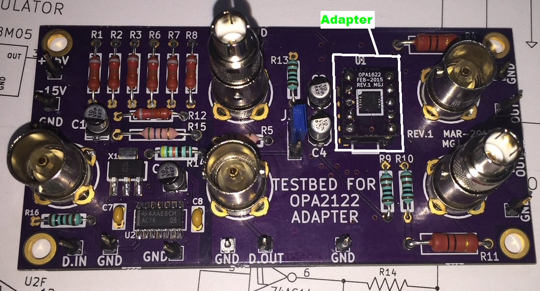

My OPA1622 adapter board is back from fab (OSH Park). The first day's soldering experiments with the VSON packages were unsuccessful; got pin-to-pin shorts in every case. Next attempts will be with a stencil and more tightly controlled temperature profile. The good news is, the test motherboard in post #152 works well. Both the analog and digital signal paths checked out fine using a scramble soldered emulator of the OPA1622 adapter board, plugged into the OPA1622's DIP10 socket.
How far are the PS caps and the feedback network resistors from the chip itself?
If you are addressing the question to me (can't quite tell),
There are eight power supply capacitors, four per rail. Four of them are shown in post #76, as "C1, C2, C3, C4". The other four are shown in post #152 as "C2, C3, C4, C5" (the non electrolytics are on the back side of the board).

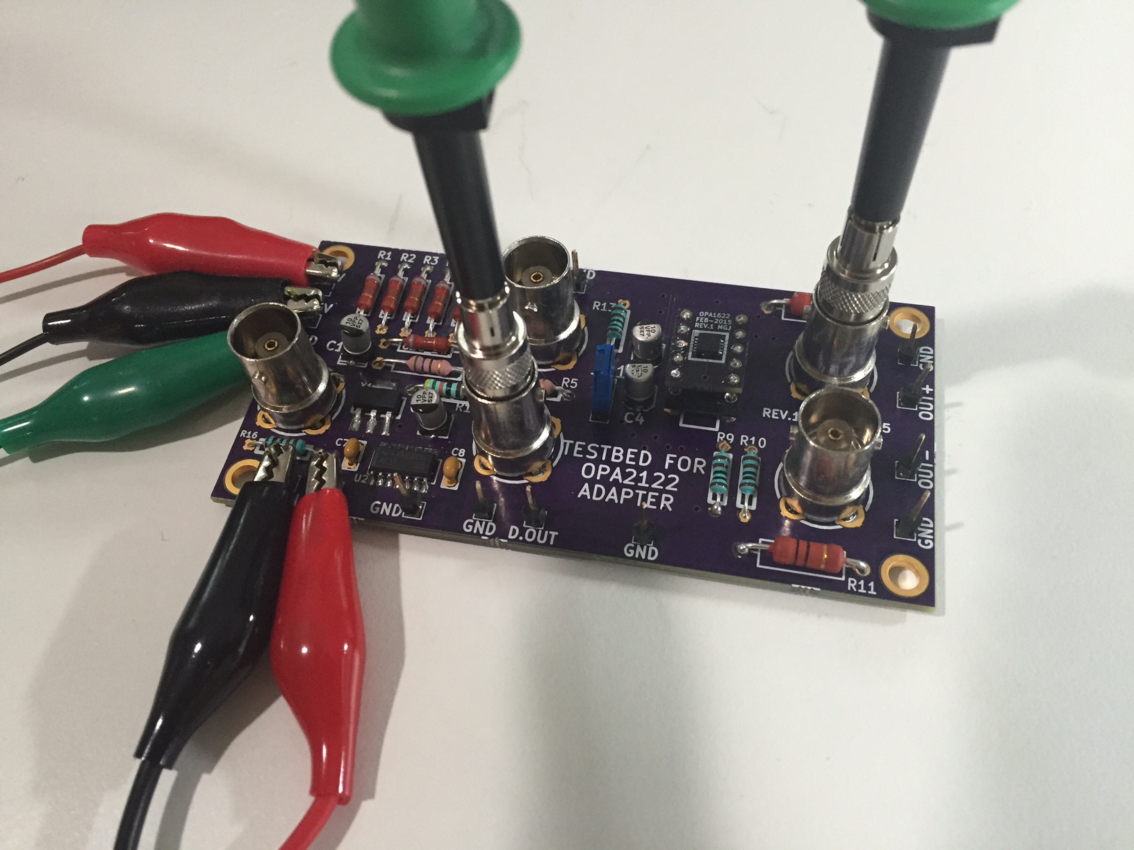

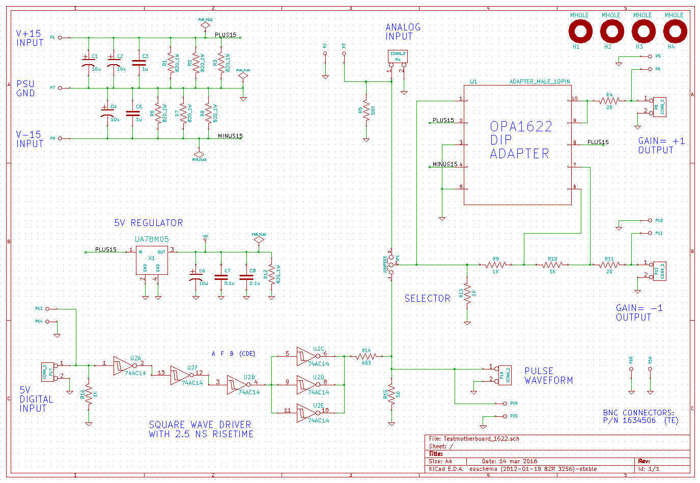

The feedback network is on the motherboard not the OPA1622 adapter board. We shall see whether this is disastrous in real life, or not. That's one reason for using BNC connectors: to search for VHF oscillation with scope and/or spectrum analyzer.
In post #152 the first half of the '1622 is configured as a unity gain noninverting buffer with no feedback resistors at all, and the second half is configured as a unity gain inverting amp using resistors R9 and R10. Both opamp halves include resistors in series with the output pin; those are R4 and R11.
There are good reasons for including all those components from Fig. 60 & 48 of the datasheet.

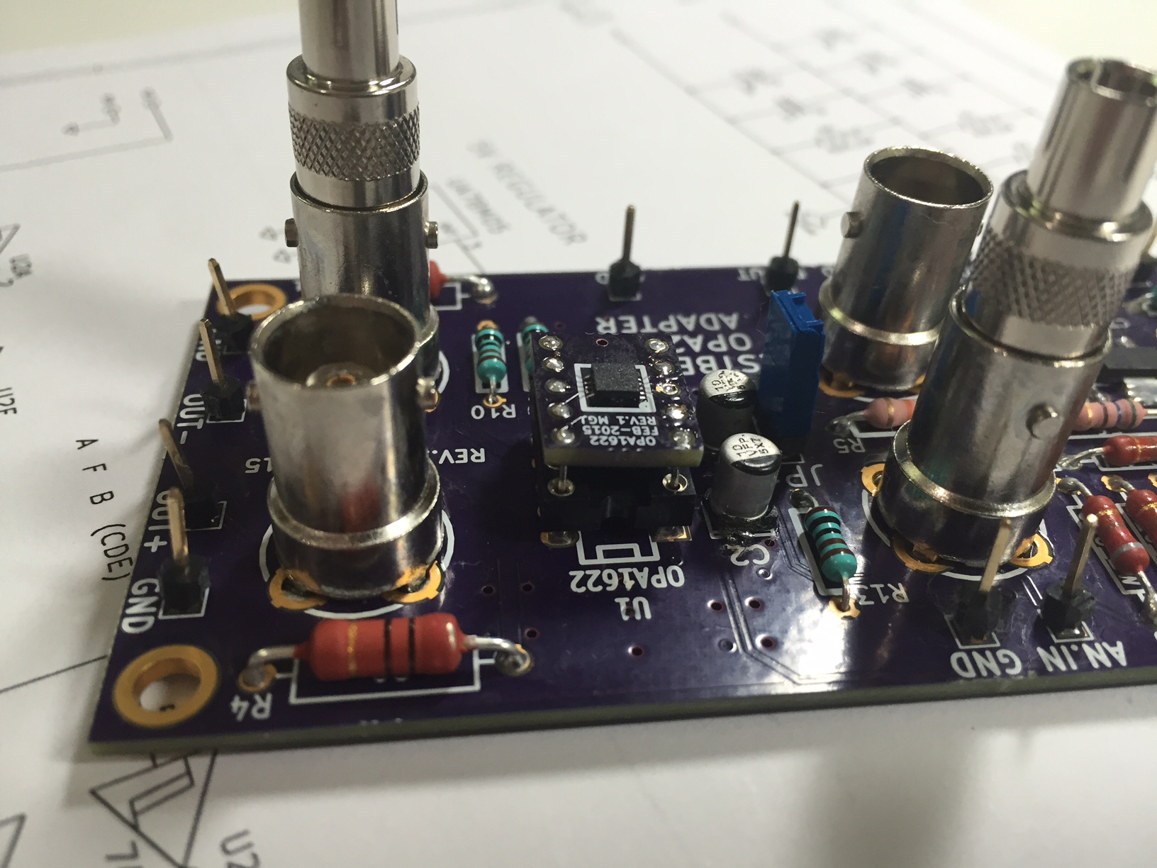

This weekend I discovered that I've got a lot to learn about SMD soldering. I built nine of my OPA1622 daughterboards, which each have a grand total of five SMD parts (4 x 0805 caps + 1 x VSON-10 IC). The yield was eight dead boards and one working board. Ugh!
But one daughterboard does work; here are some photographs. I trimmed the through-hole leads that extend from daughterboard into the DIP-10 socket on the motherboard; they're about 300 mils long. Just enough to seat in the socket and stand off the board so the bottom-mounted bypass capacitors don't collide with the socket.
I used BNC sockets and BNC adapters, to connect my scope probes to the board with very little ground inductance (last photo).

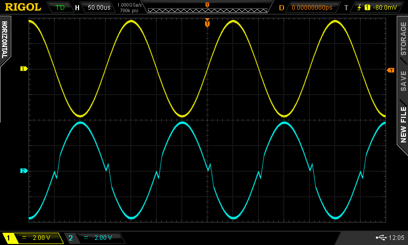

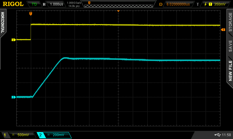

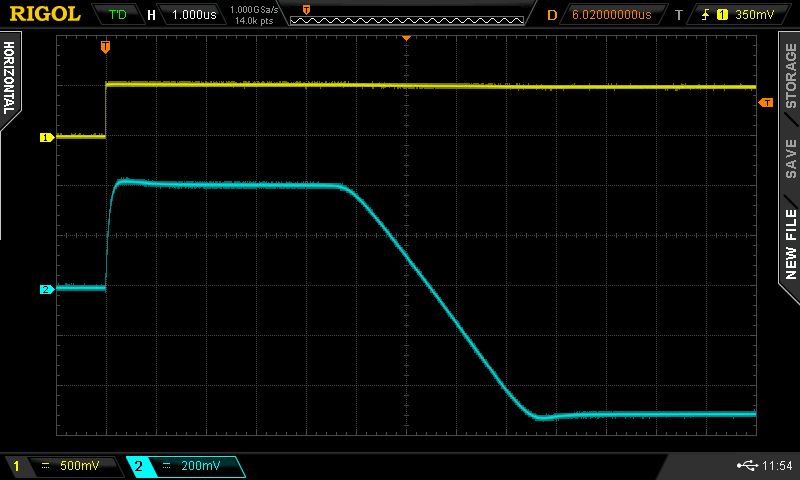

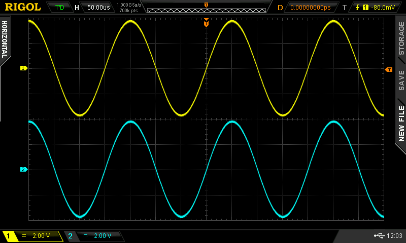

To debug the motherboard I build an OPA1622-thruhole emulator using an LM358 (!!) opamp. Here are the test results. If you ever wondered whether the LM358 is a crappy opamp, look no further.
Why is crossover distortion so much bigger in the inverting amplifier than the noninverting? Because the inverting amplifier drives a resistive load (its 1K feedback resistor, R10) while the noninverting amplifier doesn't drive any load.

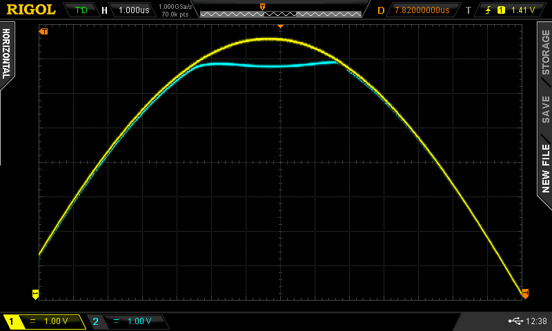

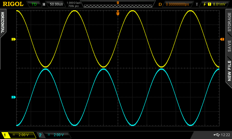

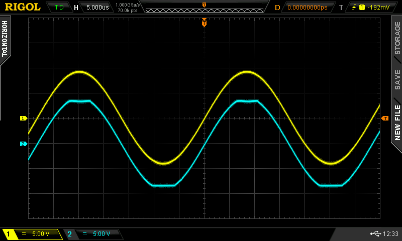

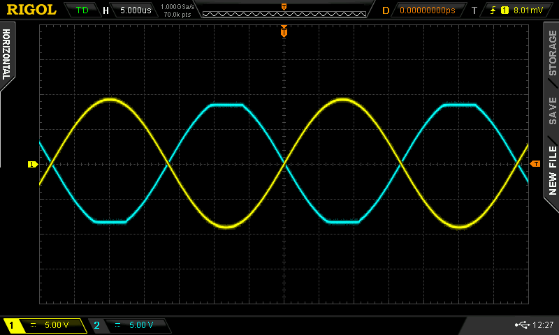

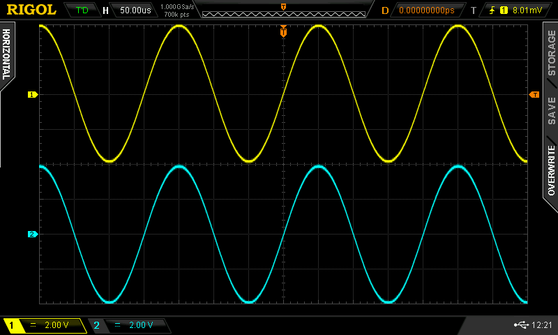

Here's the OPA1622 on my adapter daughterboard, amplifying 5 kHz and 30 kHz sine waves. Input = Yellow, Output = Blue. Supplies are plus-and-minus 10V for 5 kHz, plus-and-minus 9V for 30 kHz. My function generator doesn't pump out very large amplitude sinewaves, so I lowered the OPA1622's rails from 10V to 9V, to force it into clipping. Overload/clipping appears well behaved with no phase reversal on the output.

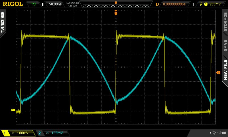

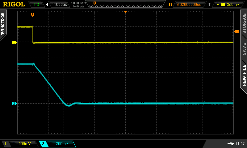

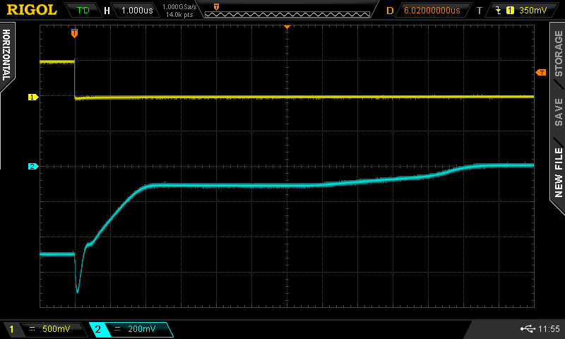

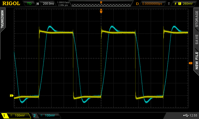

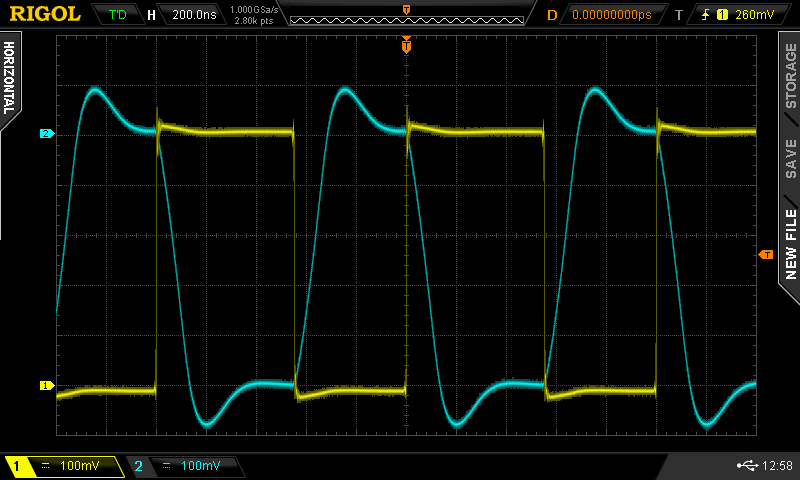

I ran a few square wave tests too. The motherboard generates 5V square waves using a 74AC "Advanced CMOS" logic chip, which gives quite zippy rise and fall times. These are attenuated 10:1 to drive the opamp inputs. Why? To keep the output small enough that it won't fry the input stage of a spectrum analyzer whose max rated input level is +20dBm. In case I ever try that.
The square wave testing was done with plus-and-minus 10 volt supplies.
Square wave response of the OPA1622 was pretty good, but it can't keep up with a 3 MHz squarewave that switches between 0V and +0.5V. Go ahead and calculate a "small signal slew rate" from that photo, if you're in the mood.
Overall, it appears the adapter is working. I don't see any gross instability in either the inverting or the gain-of-one noninverting half (Rf = Rin = 1K).

As they say in the R&D Fab, I've completed another cycle of learning in my SMD soldering process. This time the yield was 3 out of 3 (100% yield), which is an improvement over last time (1/9 = 11% yield). Better (stiffer) mechanical support of the flexible Kapton stencil during paste application, and better temperature-vs-time plus better monitoring, seem to have helped a lot.
I've taped out a rev.2 adapter PCB layout which ought to help even more, plus a rev.2 stencil layout with more attention given to the % coverage of the giant thermal pad underneath the chip. Both the new boards and the new stencil ought to arrive in about a week, and then I'll assemble some rev.2s and test them, to see whether they give the expected improvement.

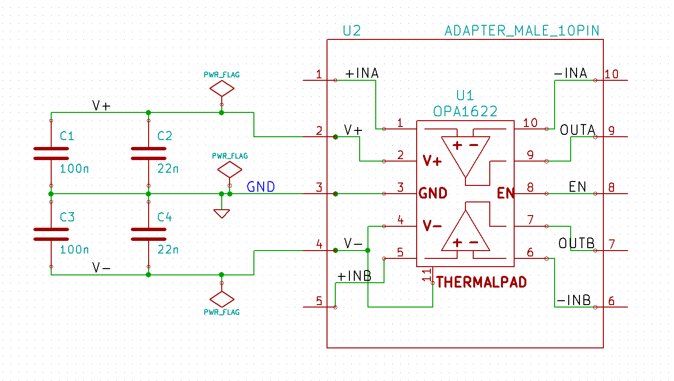

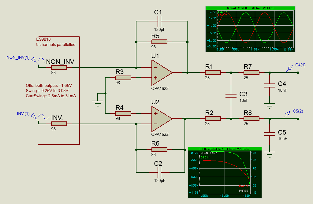

I am experimenting with a DAC buffer. I am using an ESS ES9018 with all 8 channels configured in parallell. This configuration demands the opamp to deliver up to 31mA of current to virtual ground trough the feedback resistor. To handle this current I have been using a LME49600 in the feedbackloop with a MUSES8920 opamp.
After reading this thread and the datasheet for the new OPA1622 it seems that this must be a better and simpler solution. Lower noise, lower THD and enough current capability.
Any comments on this implementation?
There will still be -1,65V DC offset on the outputs. This will be taken care of by an external circuit.

I didn't think the ES9018 required 0V at the DAC outputs to perform its best, and in that case you could put a bias voltage on the non-inverting inputs of the OPA1622 to center the amplifier outputs at 0V.

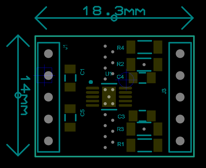

Another breakout for the OPA1622
Thanks for the tip John. I will try to put a low noise regulator as the Vref. I have done some testing with one that gave me from 1,5-5nV/Hz in the 20Hz to 20kHz range. With that noise performance the effect on the amp should not be measurable. It also makes is very easy to supply both single ended and balanced output from just one little 3x3mm chip 🙂
I am so eager to test this chip that I have made my own version of the breakout board as well. I must admit that I "cheated" a little and based my design a little on agdr's nice design in post #200. I hope thats OK agdr.
I used mostly 1206 sized SMD's and without a dedicated pin for the negative input resistor.
I also made the pads for the opamp fairly long. It makes it easier for hand soldering.

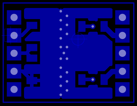

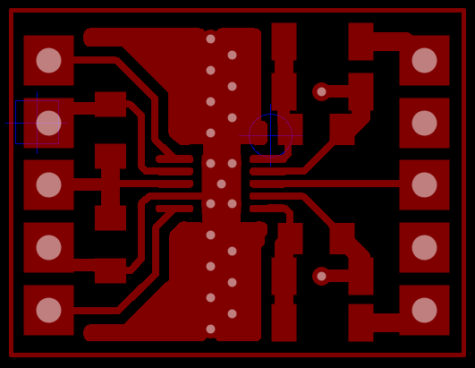

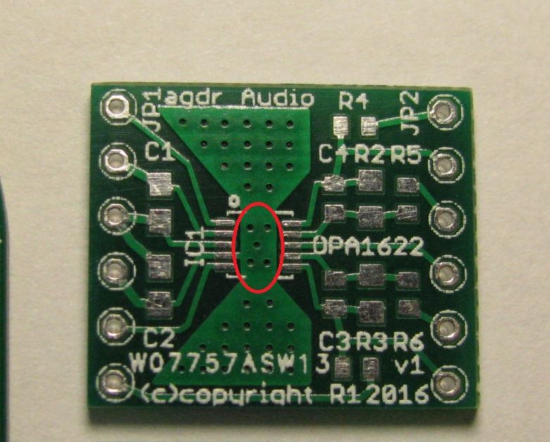

Here is one mistake not to make, below. Be sure you have specified no solder mask under the chip! I missed that one.
On mine I didn't extend the bottom heat sink foil under the SMD parts out of concern for capacitive coupling between the parts via the plane, and/or capacitive coupling from the parts to that Vee plane. The heat sink plane on the bottom looks just like the dogbone on the top. But I'm probably just over-thinking it too! I know the cap coupling [10pF max?] is very small through the 1.6mm board.
I would be curious what johnc124 thinks about the issue. Is it best to have no plane under the SMD parts, a ground plane under them, the Vee/heatsink plane, or does it even matter?
I did find an answer to that question I had a few posts back about whether removing the solder mask over the rest of the heat sink foil improves thermal transfer. I found a TI white paper on thermal pads under chips and it states that the heat transfer is about the same with or without the mask on the rest of the foil. So probably best to leave it on to prevent corrosion over time.
