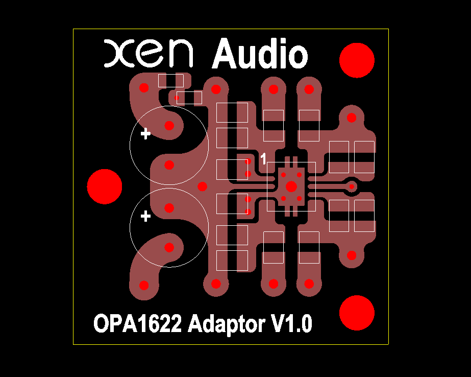

OK, we are tempted to try this out, even though I normally only build discrete.
This is our test board layout measuring 20x20mm.
Will take a few more weeks before we have the first one working.
It uses Susumu 0805 thin film resistors, Panasonic ECHU / ECPU film caps, and Nichicon MW electrolytics.
The thermal pad is connected to a large copper surface on the bottom side.
This can be thermally coupled to a heat sink via flexible thermal pads 20x20x1mm.
Fixation is by 3x M2 screws. They actually take up quite a lot of space.
Patrick

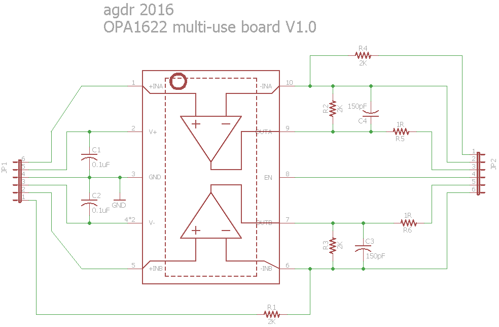

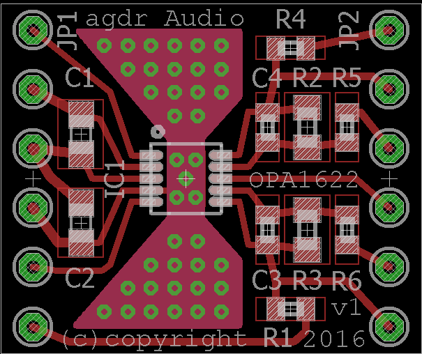

Here is my adapter board entry, in fabrication right now. I'm eager to test. 🙂
Mounting is via Mill Max 342 series pluggable board stacking pins on 0.1" centers, like 342-10-164-00-591000 or 592 for more height. The pins can be soldered on the other end or plugged into single row female collet header strips, or an IC socket. The rows are at a 15.24mm pitch so that a 24 pin socket could be cut in half.
By populating, shorting (0 ohm resistor), or leaving off various resistors it can be configured for any amp:
  • non-inverting
  • inverting
  • balanced
  • unity gain buffer
  • parallel stack (includes pads for optional output balance resistors)
  • pin-by-pin breakout
All the caps and resistors are 0402, except the power rail decoupling caps and feedback resistors which are 0603. Heat sink foil on both sides, nailed by the thermal vias. Size is 15mm x 18mm which just exactly covers the extent of the plastic surrounding the pluggable pins and/or single row collet sockets.
