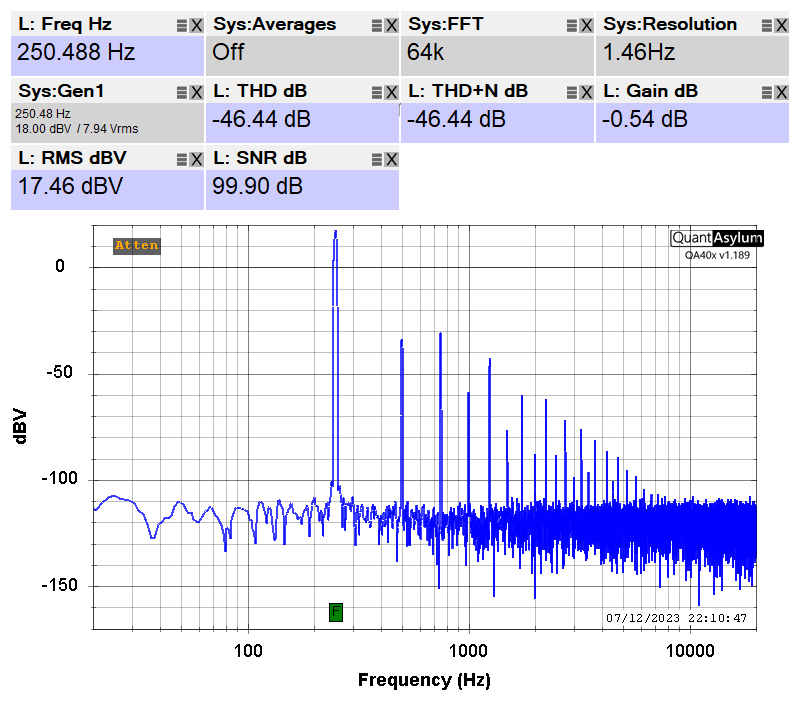

And fun plot, resistor/X7R-cap divider distortion:
So 8V rms gives 0.5% distortion with an X7R capacitor involved! I also tried a regular log-taper carbon-track potentiometer and that showed no obvious signs of distortion which is interesting. Though I think that might have been at a lower signal level.
X7R's may even be microphonic. Try connectiong it across the input and watch the spectrum while exciting it with an acoustic tone. A novel way to add space to a system?
Pot distortion is lower, in some cases much lower. I had to resort to two Radiometer CLT-1's to test pots. (One for the source and the other for the output). A decent pot- Alps, bourns, etc will get to -160dB. An Alpha can be challenged to get much below 120dB.
Yes X7R are microphonic - simple demonstration is provided by most oscilloscopes - turn up to most sensitive setting and tap the BNC socket lightly with a pen/pencil - the wobble on the trace is due to this mechanically coupling to the PCB and the first component pretty much after the BNC socket is the ceramic AC-coupling cap...

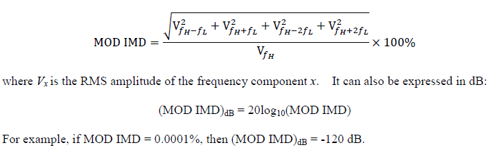

IMD (SMPTE) measurement is IMHO wrongly implemented in QA403 and former QA40x !
I was baffled to find that the QuantAsylum QA403 reports at least 15 dB too good (=false) results on IMD (SMPTE) (60 Hz : 7 kHz, 4:1). QA's data did not correspond to validated IMD measurements with my other equipment.
I found that IMD isn't correctly implemented in QA403 (and also earlier QA40x) measurement software.
Here is why, see "QA40x and IMD Measurements" (https://quantasylum.com/blogs/news/qa40x-and-imd-measurements)
Quote:
"In computing the IMD products, we’re interested in comparing the modulation products relative to the carrier, or 7 KHz tone" And then: "...we can see a single modulation product is 94.7 dB below the 7 kHz, which means 106.7 dB below the carrier." Followed by: "the 2nd order harmonics are 103.7 dB below the 60 Hz carrier, and thus the SMPTE IMD figure would be –103.7 dB or 10^(-103.7/20) * 100 = 0.000653%"
At this point it gets messed up already.
The modulation products must be related to the 7 kHz signal and NOT to the 60 Hz signal (which is 12 dB (= 4 times) stronger than the 7 kHz signal). In the first sentence of QuantAsylum's description it appears that QA refers to the 7 kHz tone as the "carrier" which it isn't. Instead, the 60 Hz tone is the carrier. Nevertheless, the summed up amplitudes of the intermodulation products at both sides of the 7 kHz frequency (depending on the IMD-order chosen) must be related to the amplitude of the 7 kHz tone and the ratio expressed as db.
However, what QA does (latest QA403 software (v. 1.193); it relates the amplitude of the intermodulation products to the amplitude of the 60 Hz tone! This results in 12 dB too good IMD (SMPTE) readings.
Even worse, the summing-up of the individual intermodulation signals is also wrong as QA writes: "There’s another (added: intermodulation signal) on the other side at the same level. These two would sum and increase the overall level by 3 dB of this particular pair."
That's also wrong. Adding a signal amplitude (voltage) of a second signal that is at the other side of the 7 kHz signal (both are + and - intermodulation products of equal amplitude) increases the amplitude level by +6 dB (= double) on the decibel scale, not 3 dB (doubling a power level makes + 3 dB; but doubling an amplitude or voltage level makes + 6 dB)! Hence (for 2nd order IMD) the QA result is too good by +15 dB. And if 3rd and higher order IMD would be taken, the error increases further, because QA's math on summing up amplitude levels got wrong.
In QA's example (see link above), QA arrives at an IMD (SMPTE) of -103,7 dB.
Actually for QA's example it is -94,7+6 dB for only the first pair of IM-components (2nd order), thus -88,7 dB IMD (SMPTE) instead of QA's result of -103,7 dB.
Consequently, the plots from the automatic IMD (SMPTE) measurements generated from the QA40x are wrong.
For a description, how SMPTE IMD is measured correctly, see the manual from AP (Audio Preciscion) https://www.ap.com/technical-library/more-about-imd/:
Quote:
"SMPTE (DIN)
SMPTE IMD is a technique for measuring IMD (intermodulation distortion) according to the SMPTE RP120-1983 standard. The DIN intermodulation distortion technique uses a similar method.
The stimulus is a strong low-frequency interfering signal (f1) combined with a weaker high frequency signal of interest (f2). f1 is usually 60 Hz and f2 is usually 7 kHz, at a ratio of f1_f2=4:1. The stimulus signal is the sum of the two sine waves. In a distorting DUT, this stimulus results in an AM (amplitude modulated) waveform, with f2 as the “carrier” and f1 as the modulation.
In analysis, f1 is removed, and the residual is bandpass filtered and then demodulated to reveal the AM modulation products. The rms level of the modulation products is measured and expressed as a ratio to the rms level of f2. The SMPTE IMD measurement includes noise within the passband, and is insensitive to FM (frequency modulation) distortion."
I would like to see a software update which corrects both major flaws, the wrong reference tone (not 60 Hz but 7 kHz) an the wrong amplitude (= voltage) summing-up on the dB scale (doubling = +6 dB, not +3 dB).
Regards
Reinhard

Different tones sum by power because they are uncorrelated, only two signals of the same frequency add coherently. This is like light and laser light. 1mW red + 1mW green = 2mW. But laser-amplifying the red light to twice the amplitude gives 4mW.
When you have the mixing (=intermodulation) f0 +/- f1, then f0+f1 and f0-f1 are both uncorrelated signals although their origin is the same for both? Not easy to understand.
Nevertheless, IMD is calculated as the square root of the ratio of modulation power, I just saw. That means, +3 dB for taking into account the "other" symmetrical mixing product is correct.
Nevertheless, the frequency to which the mixing products get related by QA's software (i. e. 60 Hz) is the wrong one. Must be 7 kHz.
This is why Fourier analysis works, two tones of different frequency are orthogonal, same frequency are not.

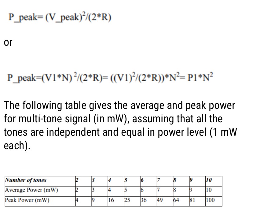

The paper I mentioned makes it absolutely clear how power tones, and therefore the resultant IMD components, add.
It does not make it clearer, if you repeat yourself without giving more meat to the bones.
The paper says "for independent signals". That restriction is not helpful, because it may not apply in certain conditions and then the formula is invalid.
Again:
The signals
A = f1+f2
and
B = f1-f2
are both combination products of a linear combination and as such they are not automatically independent from each other, even if f1 and f2 are independent. And it's that logic that resulted in the different summing, some of the authors applied as I showed.
