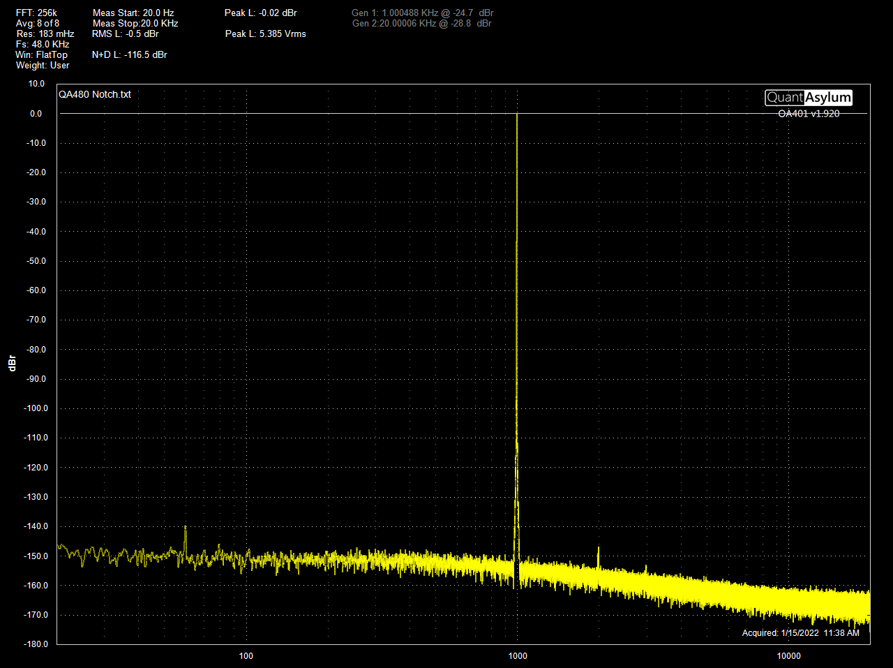

The first plot is the Viktor oscillator run into the QA480's notch filter into the QA401. With the 40+ dB notch, I think this displays the actual harmonic output of the Victor oscillator. As I said, my sample of the oscillator is more than eight years old, and I know his newer efforts give better performance. Amazing work by him.

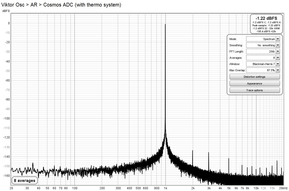

The second plot is that same oscillator run directly into the AutoRanger, which in turn is directly connected to the Cosmos ADC. So, I tend to think that shows what the combination of the AutoRanger and the Cosmos ADC can do, without a notch filter.
Some of the measurements can't be directly compared between the two plots because the filter settings are not the same. For example, the "base" width of the oscillator is different in the two plots. That could be attributable to the phase noise of the clocks used in the ADCs. Or, to the different filters used. Or, the software notch compensation used in the QA480/QA401 combination giving a misleading value of "base" width since the tone level is boosted in software to make the measurement easier to visualize. (The actual phase noise "base" is buried in the notch noise floor.) So, I dunno which has how much effect. I just don't want anyone to think that the Cosmos ADC clock stinks (it doesn't), even though the plots might give that impression. However, the harmonic spectral content should be comparable.
I made these plots at different times for different reasons. For the first, I just wanted to check the spectral output of the oscillator. Much later on I wanted to see what the effect of adding the thermal control system to the Cosmos ADC is, so I performed a before and after measurement. They just happened to be similar. I specifically showed the first so that everybody could see about what the oscillator itself looks like. I'd hoped that would eliminate the oscillator as the source of any harmonics in the AutoRanger Cosmos ADC combination. Guess not.

The spread at the base of the fundamental is a product of both phase noise and the windowing you are using. No analog oscillator will be as good as a digital source. Phase locking or injection locking can help but with significant overhead and some potential degradation in the distortion.

In truth, the biggest difference between the base spread of the QA480/QA401 and the AR/Cosmos is the way the QA401 handles the software equalization of the QA480's notch. The tone is gained up at the notch frequency, but the base spread is not evident because it's lost in the notch noise, which isn't amped up. I looked and found that I had a couple plots comparing the QA401 driven directly from the Viktor oscillator to the AR/Cosmos driven by the same oscillator. Using the very same software (REW) for both, the same sample rate, and the same filter settings, the Cosmos actually is a bit narrower at the base.
Anyway, my whole point wasn't to compare phase noise of the two test set-ups. I just didn't want anybody to get the wrong idea about the quality of the Cosmos ADC conversion clock. Nor to think that Viktor's oscillator was the limiting factor in the AR/Cosmos test. The AR/Cosmos acquits itself quite well, at least in my opinion. A greater than 130 dB distortion dynamic range with no notching is pretty good. A year or two ago, you'd need an AP or something equally expensive to get that result.
