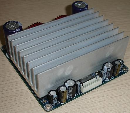

New products were added. One of them, the version v3a of the TA3020 amplifier: http://connexelectronic.com/product...ducts_id/97?osCsid=5u81s5892dspm9g8m0fvpk6ac6
probably the smallest complete TA3020 amplifier which exist. measuring just 100x100x40 mm, is very compact and suitable to use where the space is a real challange.
more details soon.

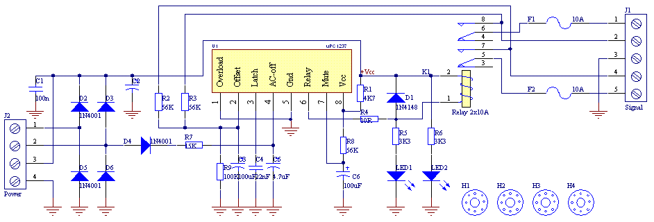

Speaker Protection Circuit is for 2 channels, can be used withstereo amplifiers. can use 10-15V AC power supply or 12-15V DC supply. in case that higher voltage is available only, the resistor R4 connected in series with the relay must be recalculated and C2 must be replaced with a higher voltage one. i can do this on request, when you order the board, if you specify the available voltage.
What is the smallest size transformer that can be used to power the speaker protection circuit, how much current is required?
Also, I noticed that you have added a soft start to your line up. What are the specs and what is required to power that? Will it use the Amplifier PSU or a separate transformer?

Except for smaller size, lower price(V3A) what is the difference between TA3020 V3A and V2? what about sonic quality?
there are few minor differences. on V3a i removed the rectifier bridge, the supply for fan, which was on v2, and i changed the SMPS regulators IC. the sound compared with v2 is similar.
note that due to the smaller size of the board and especially the heatsink, it requires a fan to be able to play high output levels. i can add this on request.
the ideea to shrink this board was to make a very compact and easy to install amplifier module, especially for multi-channel amplifiers, where 2-3-4 modules can be used together.
v3 has the 5V and the neg +10V supply on board, like the v2, but doesn't have the rectifier bridge and the capacitors are smaller value, since was designed to use separate psu.

Also, do you have an answer for col's question about the speaker protection circuit ? "What is the smallest size transformer that can be used to power the speaker protection circuit, how much current is required?"

for the speaker protection circuit, the minimum transformer which can be used need to provide at least 9V AC, which after rectifier and filter will be 12V DC. the required current is 50mA, so the transformer power can be less than 1W.
if different voltage value is available, for example 16V AC, this can be also used, but need to change the resistor R4 with different value which need to be recalculated dependin on the board DC voltage and relay DC resistance (ussualy 270 Ohms). if the voltage is higher than 16V AC, the C2 capacitor need to be canged with a hgher voltage one.
the board also can be used with DC power supply, just connect negative voltage to the pin GND, positive voltage to the pin +Vcc and AC1 for AC detect.
