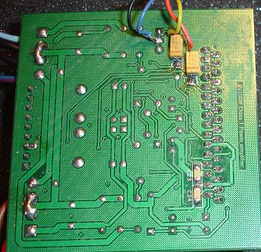

col said:hmm..... this TA2022 project is beginning to get dust on it.
not so fast... i made it last night. the reason why i didn't finished last weekend was that i needed to assembly one empty board and i haven't all the parts. i needed the small inductor and i just got it yesterday, 500pcs. they didn't have on stock and i had to order, since nobody care if u need one or 10 pcs of something (i need just one pcs. the others will wait for some other things).
i will attach a photo where can see what and where need to change. basically need to supply the audio signal directely on the IC on the pins 23 and 26, as close as possible to the IC, avoiding the high power/frequency area.
need to cut the tracks from pins 23 and 26 which go to the input connector, but cut after the connection to the resistors from pins22 and 25. after that need to connect one resistor of 20K (this resistor will determine the voltage gain of the amp) and one capacitor (1-10uF) in series, with + towards the IC and - to the input.
the GND copper pour should be connected as can see in the picture close to the power connector GND and/or Speaker GND.
with this modification i successfully reduced the noise floor with about 17dB compared with the previous value. keep in mind that need a start-up delay circuit or speaker protection circuit to avoid the start-up burst.

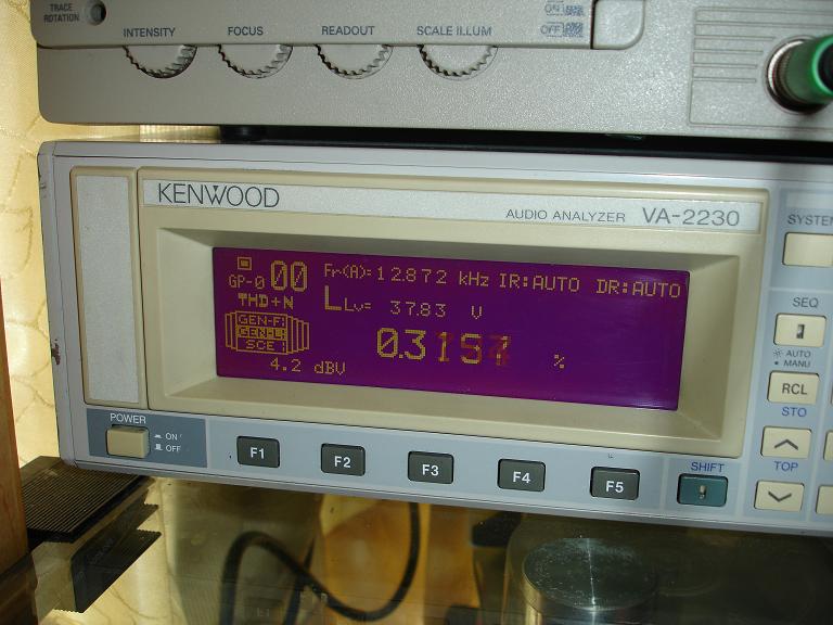

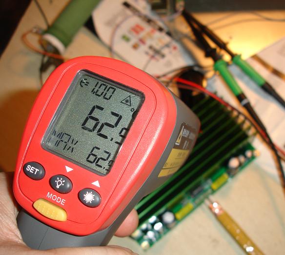

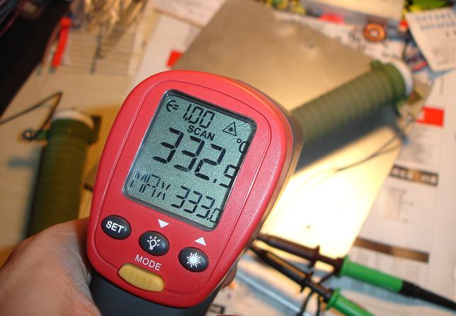

i made few more tests for the TA3020 v2 boards and i made some photos also.
for the power supply i use, 2x45V AC at 10A each.
load resistors are 4ohms at 100W each.
i got 37.8V at 0.31 % THD. in means of power, this is 357 W.

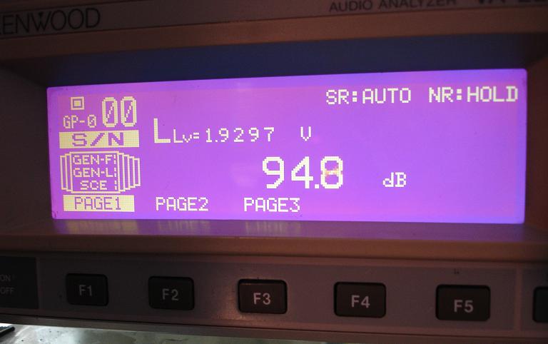

how good is the noise floor with the new TA2022? I need something with really low noise as I'm powering a very sensitive pair of compression drivers in a tri-amp system. I'm currently using the TA3020 but want to move it down to the mids.

i measured 94.8 dB S/N ratio with input shorted with about 30cm wires. should be more if i short the wires directely on pcb. anyway, the maximum S/N ratio for this IC is 102 dB.
