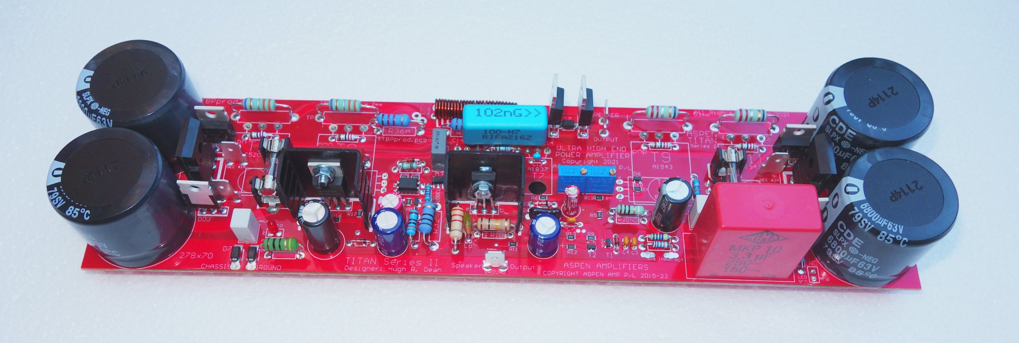

Either the Titan 125 and the Maya 200 would suit your large listening room, and more than suitable for 91dB/watt/metre speakers. It will depend only on style of presentation. The Titan gives breathtaking resolution and dynamics, while the Maya gives huge refinement, scale, and late night listening.
This is the essential difference in bipolar (Titan) output vs mosfet (Maya) outputs. As modules the Titans are $AUD2600 a pair, while the Mayas are $3200. It's AUD, however, so it's about 2/3 these figures in USD.
Both amplifiers have been developed in the last year, the Titan a year back, and the latest V423 Maya, only six months ago. As time goes by I learn more tricks of the trade, and my sound quality incrementally improves. These are my best amplifiers ever, and both have been compared against a 300W Gryphon, a Pass X30-60 and a Pass INT25. These are very good amplifiers and my latest are not embarrassed in any way, shall I say........
The Titan pcb is 284mm x 71mm (one channel) with six output/driver devices to be cooled. The Maya pcb is 254mm x 71mm with two very large mosfet outputs and two on board pcb heatsinks. Both pcbs have a total height of 62mm, but both modules need substantial heatsinks on the Cu side of the pcb. These are drilled, tapped and supplied at sale.
Most of my source is a SMSL DAC D6S, and from normally Tidal or a laptop with high res files. Your SRPP ECC82 will be a very good preamplifier which will confer a very nice tube sound to the system. I find good recordings in 24 bit, at least 48KHz, are markedly superior to 16/44, and my amps bring out the recording process very well. The best word for the sound is 'natural', with no electronic, digital or noisy artefacts at all. Both amps are extremely quite and on my 90dB/watt speakers I cannot tell the amps are on even with my ear in the cones.

Hope you’re well Hugh! Quick question, I have a couple of 300VA toroids in the cupboard, but they’re 33Vac each. I believe they may be a remnant of the Lifeforce modules… would that work?The Titan adopts a highly refined topology with very high speed active devices and current feedback. Full power is more than 125W, but I rate it conservatively with 52V bipolar supplies. Each channel requires a 300VA toroid with two independent secondaries at 35Vac each.
