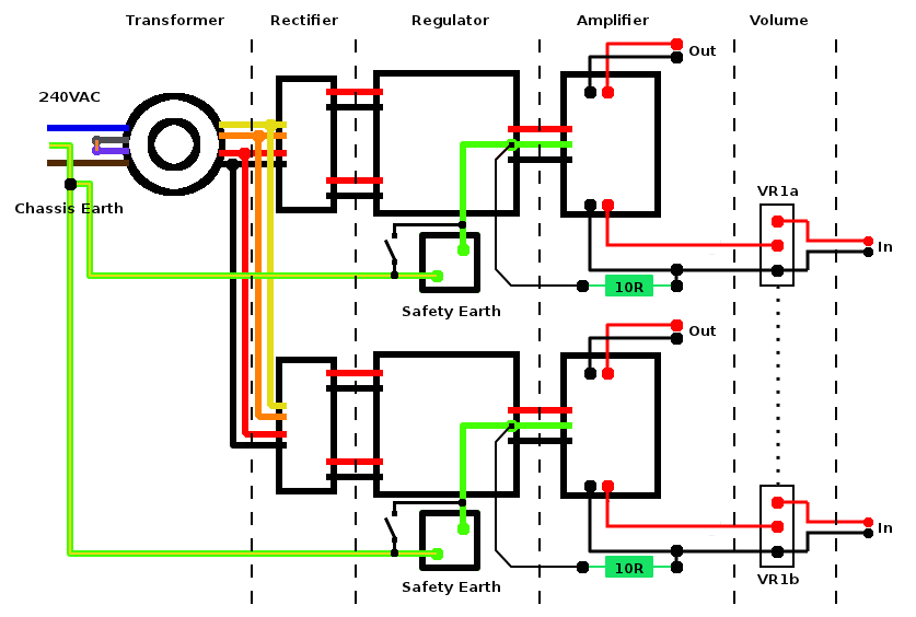

next up, grounding
Just bear in mind that you DO have monobloc amplifiers, even if you happen to put them in a single box. In this case, you do have two zero volt taps--they are the speaker negatives. For the left channel, connect a ground loop breaker circuit from speaker negative to earthed chassis ground. Do an identical copy of that for the right channel.
Hand match the resistors via digital ohmmeter for left and right ground loop breaker circuits of monobloc amplifiers.
And
Hand match the resistors via digital ohmmeter for left and right small signal groundlift resistors of monobloc amplifiers.
and
Remember, your wiring is the same as regulated monobloc.
For a stereo amp, the grounds meet only once; but for a monobloc, the grounds of left and right never meet except for loops breakers resistors at larges signals and groundlifts resistors at smalls signals The totally individualized circuits are what gives the monobloc/dual-mono amplifiers wider sounds.

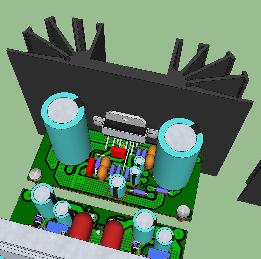

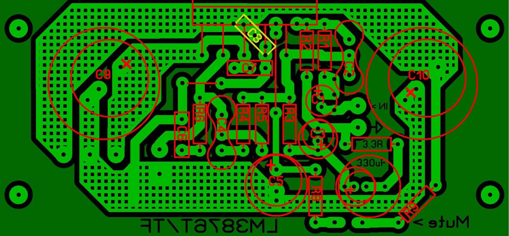

Hi Daniel
Everything duly noted. I now have a new PCB pattern drawn up for the regulator. It is set to take two pair of 2200uF or two pair of 4700uF.
At this juncture, other than finishing the current sets, I will be going for a second build to apply all the changes and improvements with the new PCB patterns. I may even stretch to a pair of toroids to run the future unit at 'maximum' efficiency.

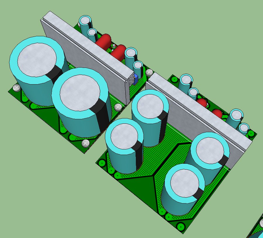

Since you have 4 reg boards, you could just replace the the 10,000uF with 2,200uF on the boards that you already have (simply 1 new drilling per board will adapt the pin spacing without making new boards).
Just don't forget to put 1 pair 2,200uF direct to each Rectifier. That is what allows your cabling to work out right--super short between amp and reg boards, and as long as you need between Rectifier and reg boards.
Count it up:
4,400uF at V+ rectifier
. . . and then cables. . .
2,200uF at V+ reg for left channel
2,200uF at V+ reg for right channel
4,400uF at V- rectifier
2,200uF at V- reg for left channel
2,200uF at V- reg for right channel
That is 8,800uF per each rail, it is fast, and it is plenty.

Rectifiers:
On that list, improvements probably come from 2 sturdy rectifiers and pairs of 2,200uF caps directly upon each of the rectifiers.
Reg boards:
Subjective sound quality versus faster charge--those are such different things.
I am not sure if changing the 10,000uF to smaller would make an improvement or dis-improvement, so do only one channel (leave one channel un-altered) and a-b compare to find out.

I have been running over the basic wiring of the dual mono set up and have knocked up the attached drawing. Is it correct? Assume the 240VAC Supply is socketed, switched and fused.
Other than the main AC switch on the mains I am looking at using a 'soft touch' button to switch the unit on and off. That is a set of relays which toggle on/off at the touch of a single button. My question here is where to splice in the relays. Between Rectifier and Regulator or between Regulator and Amplifier? I am assuming I'll need to switch the +VE and -VE if switching is done between the Regulator and Amplifier. Or is switching the +VeE line between Rectifier and Regulator?

Surround replacement is a preferred fix. The puff of smoke could have been a crossover capacitor, an elderly low voltage electrolytic. Nichicon ES 50v is a an economical high performance replacement for midrange and tweeter use. For woofer use, the 100v models are a bit more sturdy. Also measure/inspect any resistors that are in the crossover.
That mess would increase your electricity bill while also dramatically decreasing longevity. Instead of that problem, I would prefer a nice mechanical switch for transformer primary, so that off means off. If you desire automation, buy either a "smart stick" auto switching power strip or a remote control kit.

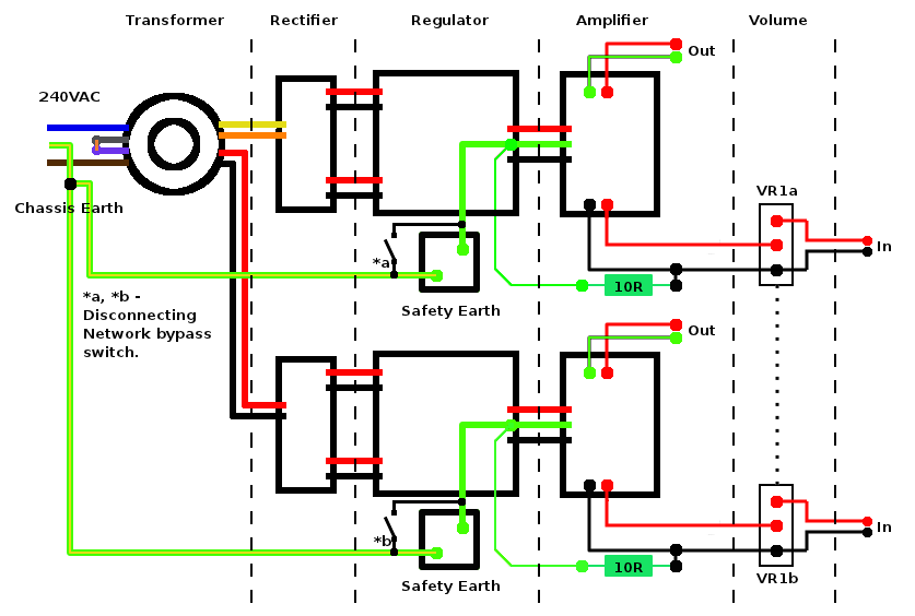

The 'MKII' PCB has been fettled a bit more. The PCB is a little bit deeper allowing the mute pads new position. This in turn makes room for the extra cap and series resistor, as you suggested, for 'enhanced bass ability'. Also extra pads have been added to allow the fitting, track side, of a parallel cap to C1, again an early suggestion by yourself, to allow some experimentation.
To the diagram of the 'basic wiring' I have added a 'ground lift switch' to the safety earth, a suggestion of Andrew's. I am assuming I have all the wiring arranged correctly??

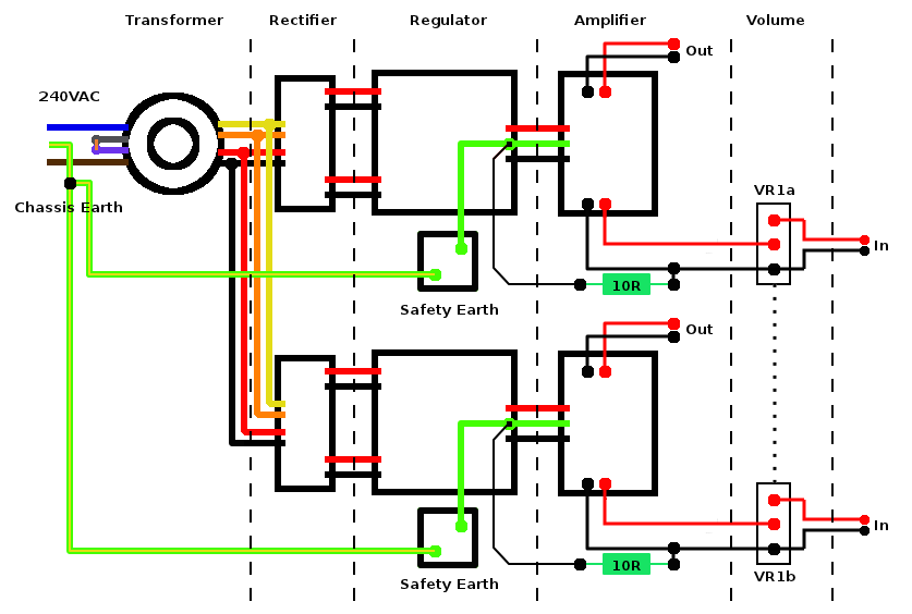

@Daniel - Done the colour changes and duly noted the matching of the resistors.
@Andrew - I see where your coming from. The incorrect naming is my fault alone. I have noted this, on the revised wiring pattern, with the 'correct terminology'.

Currently running both units with both speakers. Other than the issue with the rubber surrounds effecting performance it all sounds pretty damn good!
I have found a supplier, of the 'proper' rubber surrounds, closer to home.
Initial wiring failed to function. Reason unknown at this point. Oddly when I unplugged the mains the speakers fired up for the duration of the capacitor discharge.
Wiring as per my original got things going again so I will have another look at the 'simpler wiring' tonight.
