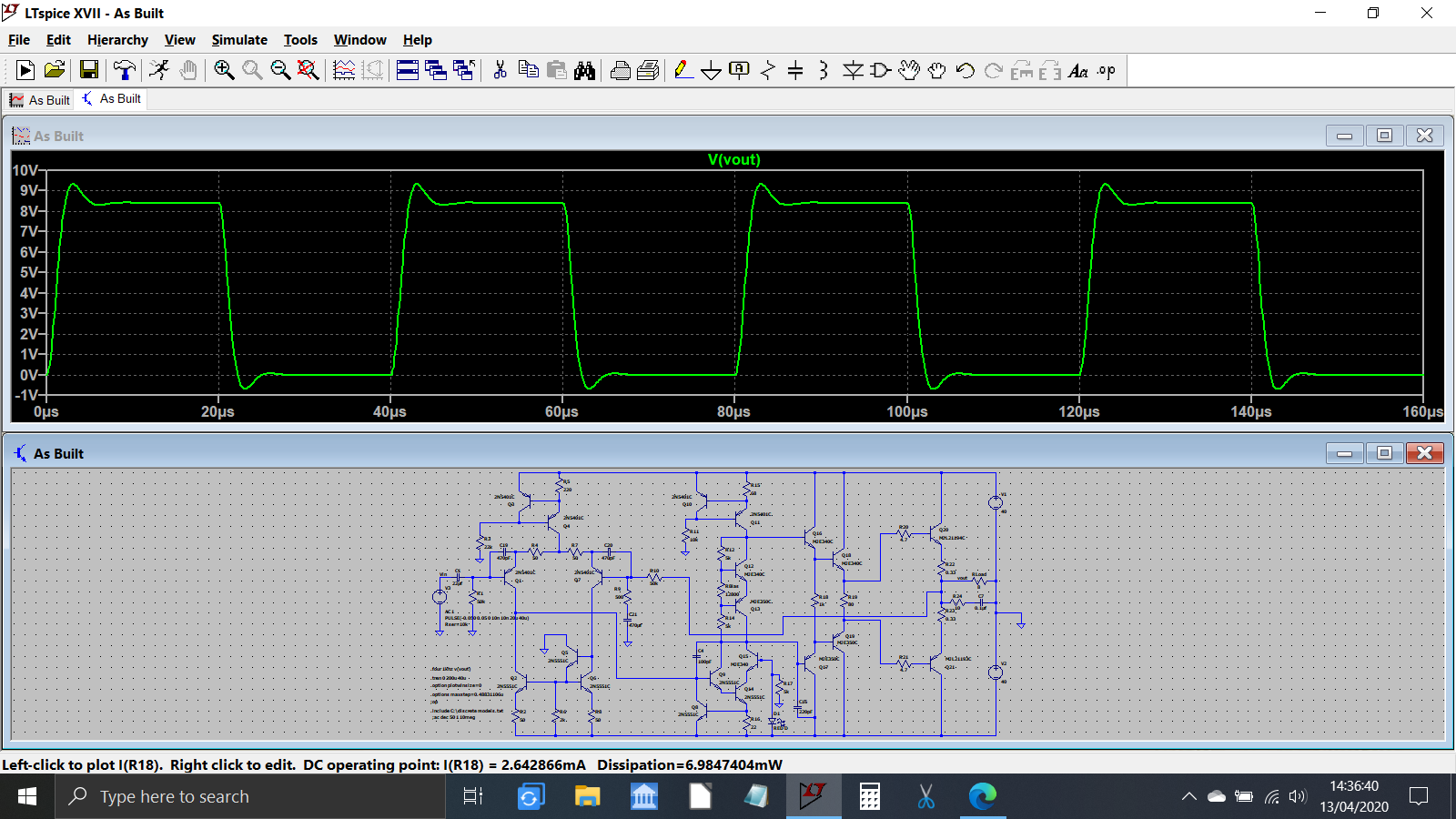

As you wrote, you did SIM as I did.
For sine wave signals I got 0.001% THD in 10KHz what is good value. But if I start to test square wave I found oscilation in falling bord of square wave with a strong over voltage oscillation.
For me it means there is compensation issue in this circuit.

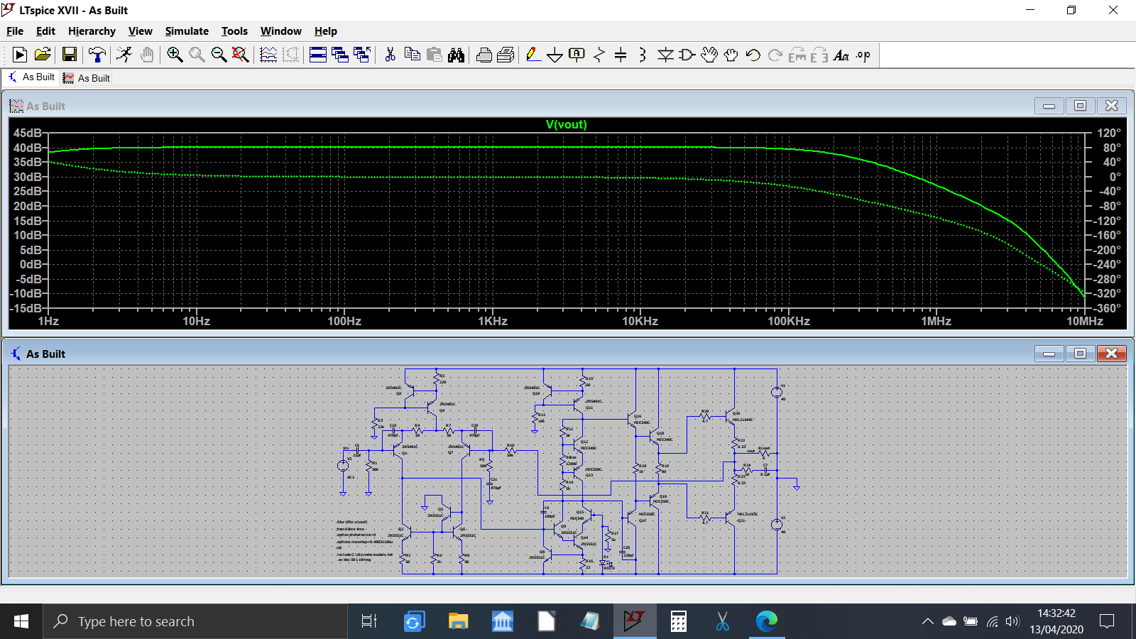

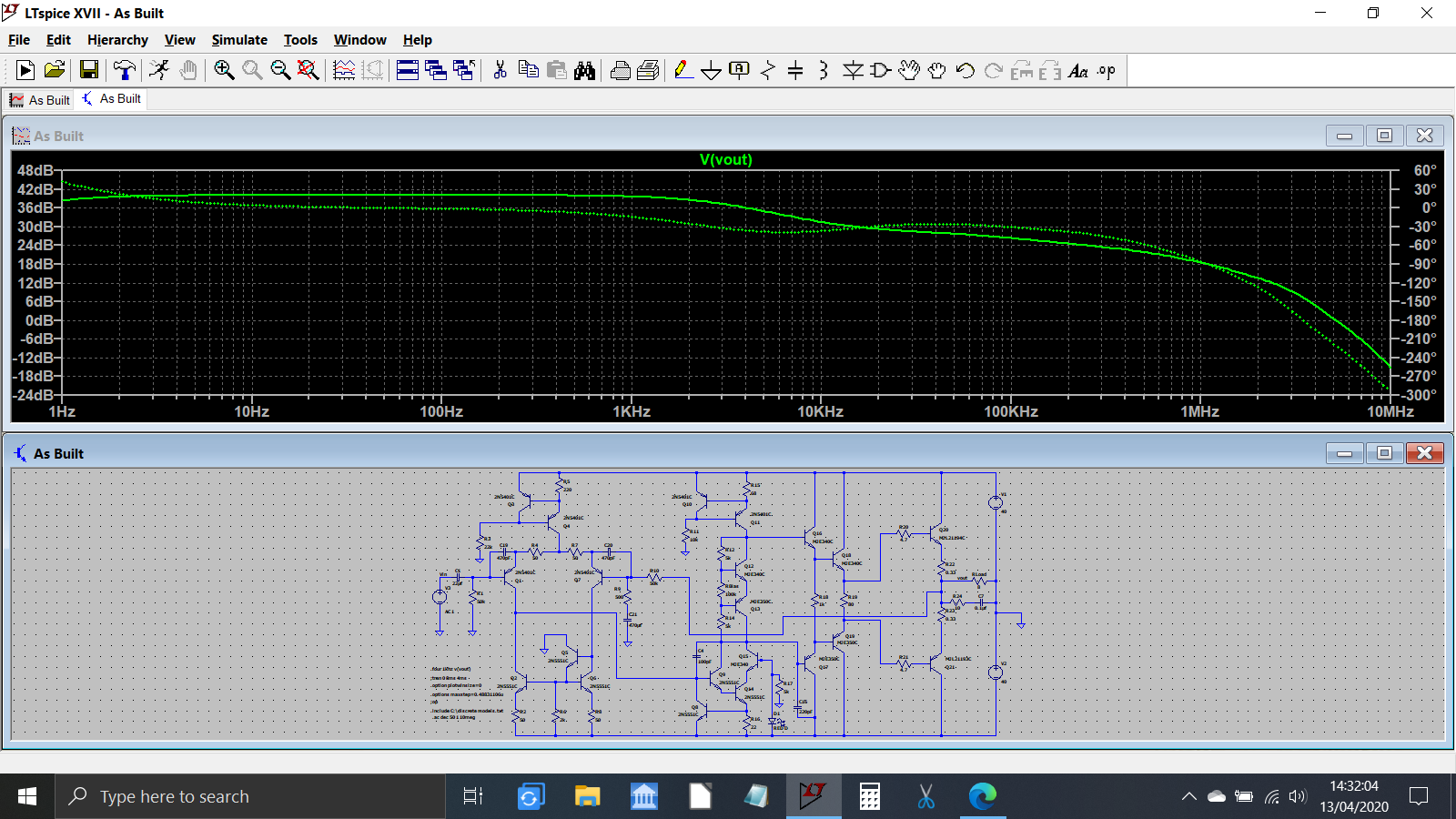

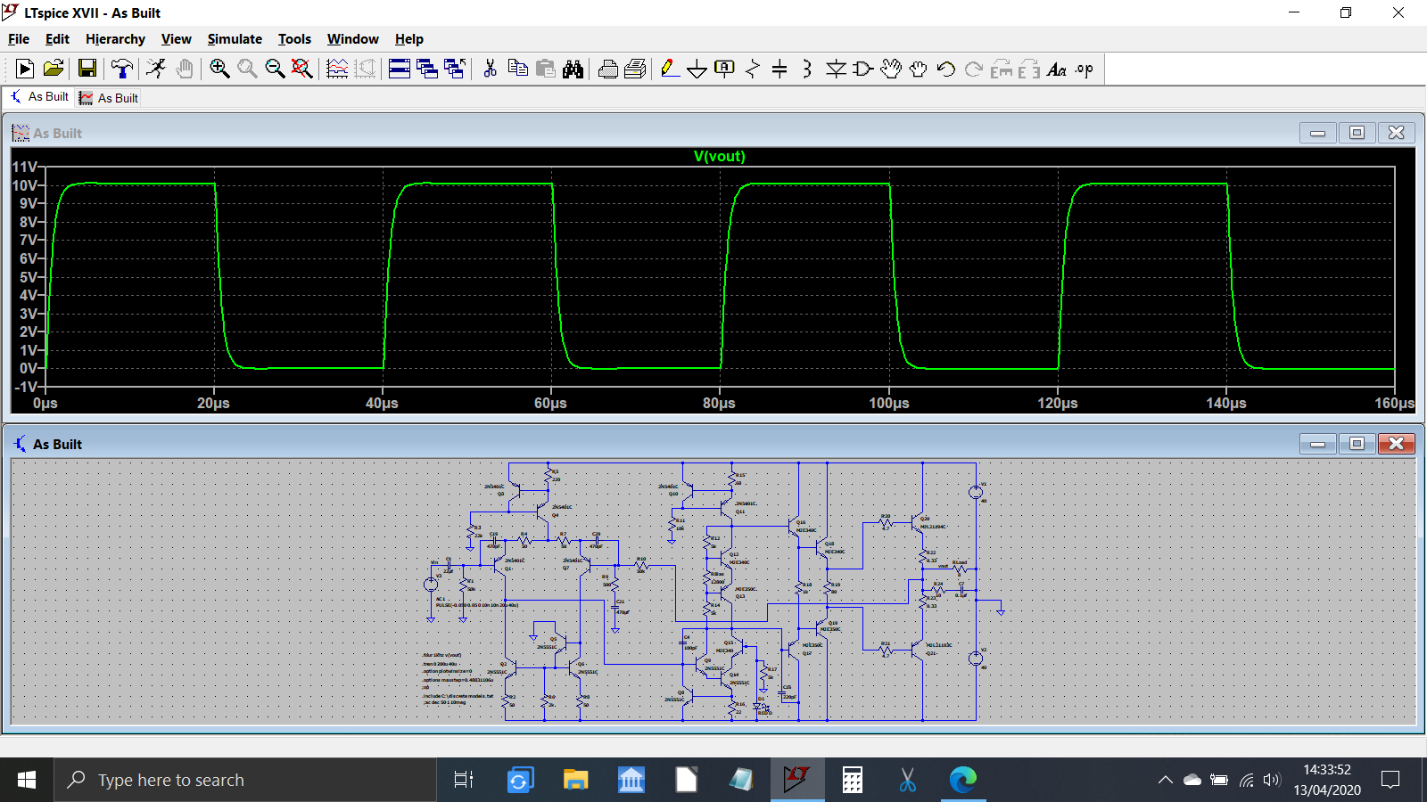

I altered one of my 'Blameless' sims if anyone wants a play. I think its all correct but double check...
The 5k input resistor and those 470pF caps need looking at imo. A proper and well defined input impedance would be desirable.
Its not bad though :) and should be tweak-able.
Mark makes a good point on the bias setting as that does dramatically alter stability margins as can be seen here.
The peaking on the squarewave is when the source impedance is set to 10k.

I think it's worth noting that this will be the power stage of an amplifier. It has (relatively) low closed-loop gain and a low input impedance. It will be driven by the op-amps on the input board.
Mark, I did try increasing the miller cap, but by the time the problem goes away the slew rate is unacceptably low, less than 10V/uS.
Bias is set at about 75 mA.
Someone commented on bypassing R10 with a 100pF cap. That makes this amp go ballistic. I have it bypassed with a 15 pF cap, and even that is a little borderline.
