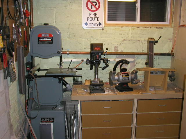

Now we are going somwhere. Maybe Harry wasn't right after all and that discussion would be creative. The picture below shows everything you need to do that kind of work. I have it organized now in a basement but before I was doing everything in a garage.
That's true that every piece of a chassis is custom made, but it's not really hard.
When I started the design of a chassis the heat sinks where the starting point. I can't imagine other way. You build the whole amp around heat sinks. And of course transformer, you have to know how big it's going to be in order to fit it into chassis. I never sit down and draft everything. I just have the vsual idea in my head of an amp and go along. In that case heat sinks determined the height and depth of an amp and transformer determined the width. Nothing to measure. The heat sinks by the way are from R-Theta and I ordered 12 pieces of them. The length I calculated to obtain proper heat dissipation, also didn't want them too short because then the amp would be lower than Aleph0.🙂
Coming back to tools, all you need is a band saw, table drill and belt sander. In 1994 I bought them all for $CAD400. Not all of them were new.
Having decided on the dimentions of the amp I check if all the parts (mostely filter caps, because there are many of them and they big) would fit inside amp and I start cutting aluminium. For that project I ordered plates precut to the width from local aluminium manufacturer, I just had to cut them to the length and finish the edges which I did on a belt sander. As you see on a picture I modified my belt sander by installing oversized mdf table so 90 deg. angles are not a problem. The bars to mount mosfets where the only parts I had done through a friend. I still remember Nelson writing about making friends with metal shop workers. After cutting and drilling was done I sanded the surface of the plates on 3" belt sander using lots of WD40 and they were ready for anodizing. Anodizing cost me $100.

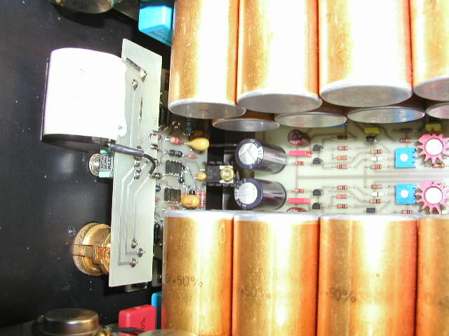

When designing PCBs I wasn't concentrating about the equal spacing of the resistors and caps but about functionality. While designing the front end board I already knew where the input jacks are going to be, from which side the wires from PS would be coming and where the output stage was. So I planned accordingly. I also decided on double sided boards to make connections short. The trimpots are located between the board and chassis. The holes in the back of the chassis allow adjustment without opening the amp. That was very clever in Aleph0. I did my first A75 according to the article in Audio Amateur. In order to change the bias and adjust DC offset I had to open the amp. But then the temperature of the mosfets changed and the readings were chngged too. So here I decided to mount the mosfets (front end board) directly to the chassis and make the access holes. Much easier adjustment. This is how front end board is installed:
