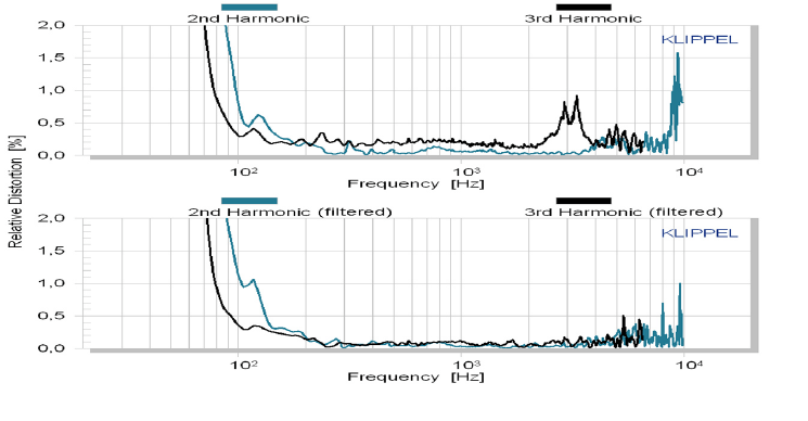

I've shown this before, but this is with a parallel notch in series with the driver (a modified Seas tweeter). Accuton used to provide before / after HD plots in some (some) of their old data sheets; they were being coy, but that's what they were doing. Series & parallel notches work, but parallel (in series) is generally my preference as it works better, unless you're incorporating, say, an LC shunt into the transfer function & it either just works out that way or you need to save money on components. Whether you'd call it EQ is a bit open to question as in both cases we're usually talking bottomless notches being used purely as that, rather than being used to shape the driver to a given response.
