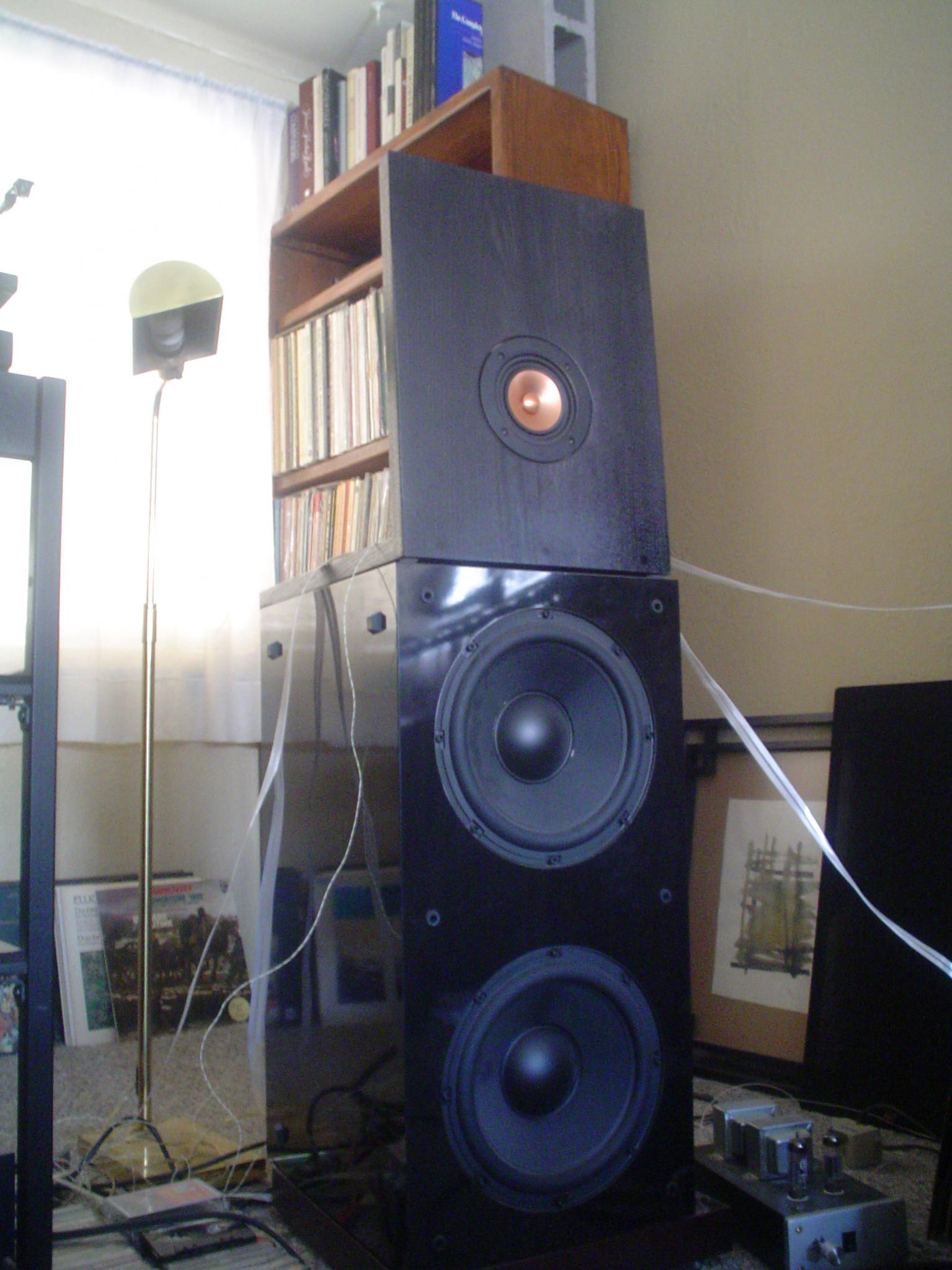

LOL on the shop slave thing... btw, do you have two subs or just one?
Two with one OB sitting on each cabinet.

Which fullrange driver are you using?
dual tang band 4" bamboo, but I have alpair 12s going into open baffle hopefully this weekend.

Alpair is wide open with no crossover, subwoofers have a controller and their own plate amps. From integrated I go line out too sub crossover/controller and directly off integrated speaker taps to Alpair 7. All is surprisingly seamless with no audible artifacts thus far. Hope this answers your question.

Are you saying the speaker level taps on your plate amp are full range and not affected by the amp's built in xover? Or are you high passing to the Alpair via the plate amp xover and simple meant there is no passive xover on the Alpairs?
There are no speaker taps on subs, they have an 8 din plug from controller on each sub. Line out of integrated is going to subwoofer controller. Controller tells Subs too enter around 150 Hz . Integrated amp output speaker/taps of integrated are going directly to Alpair 7's with no x-over. I hope this answers your question.

Thought I would update you on the sound of the Alpair 7 OB system after much time. For a long time I used a Scott 222C that had
ailments that I have repaired🙂 and is now tweaked showing the true beauty of these drivers and their subsequent design. My Scott 222C has had numerous upgrades of caps (obbligato Gold Premium) between inverter and output stages, some Bradley resistors (Only!) replaced, selenium rectifier was replaced with a silicon bridge and Wima Black Boxes at the input stage. Also, all tubes were replaced with the following Brimar 12AX7 at (input-stages) line and phono stages, Siemens E80CF inverter-stage, Siemens E84L's at output and an Amperex Bugle Boy GZ34 rectifier. All parts have had months of break in
time.
Needless to say I would not be updating you if I were not enamored with what I have been hearing for weeks/months with the Alpair 7, especially after eliminating a nasty
hum that haunted
the Scott and my life for too long. Still a very minor amount left in right channel but only really audible when using my low output MC cartridge and there is a very quiet passage, not enough of a nuisance to discontinue evaluation or listening enjoyment, it will be eradicated later
, it was time to sit and listen.

If you read this post from the beginning you will be familiar with design build and construction of this simple yet elegant design. Thanks again must go out to Phil Townsend for his expert craftsmanship and patience in construction and input on design. I am a finisher by trade and without Phil's speaker cabinet building mastery I would have likely had to depend on someone less knowledgeable in this arena so I am fortunate and grateful.
SOUND
I will cut too the quick here as I have already gone on enough about this little project. Yes, the Alpair 7 sound fantastic, yes they have a clarity matched by few drivers, no they do not beam or honk at you nor do they split your head in half with a razor, like so many Full Range drivers IME. Yes they have finesse and stable imaging, yes they need a box or in my case subwoofers (see photos @ beginning) too supplement bass.
In this OB design the speakers throw a deep soundstage too my back wall which is 5ft from driver, they do this superbly with digital as well. Transients and textures are clear detailed and never overblown. Dispersion which is a big gripe with me is excellent, you do not have to sit with your head in a vice, you can wander over too the record shelf and ponder your next record or CD without major sound compromise.

Another important note is how well the Alpair 7 integrates with my subwoofer system. Imbalance or lag is not an issue plus being able to dial in bass proportion is easily handled with a separate crossover box (comes with subwoofers) which incidentally I have set to enter at 140-150 Hz and the phase set around 180 degrees. At 180 degrees I found the tautest most natural sounding bass response after much testing in my living room.

Alpair 7 in small L OB
NHT Sub Two, two 10 inch drivers per cabinet Freq 21Hz-200Hz with 250w Sunfire/Carver plate amps in each cab.
Cables, DIY silver,Stealth, CRL and Aural Harmonies.

I think this is a great way to build a speaker. It's actually very simple... whether it's the MA, TB, Fostex, etc... mount it onto an OB that sits atop your powered subwoofer, blend the sub into the full rangers... you get 'mostly' full range sound and you get open baffle sound too. This plus the full bass adds up to a really great way to build an excellent sounding speaker... and without mucking around crossing over a tweeter. But you can add a super tweeter crossed over 12 or 15k if you like easily and it can be something cheap.
Zilla
Zilla
Zilla
Agreed,
This is a simple way to design a system provided you have the subs or build them.
You do not need a super tweeter with the Alpair 7 it goes up to 23 k and sounds like it, the 7 is simply astounding. In fact I think a super tweeter would cause more harm with this driver and be a waste of money you would get nowhere by adding one IMO.
