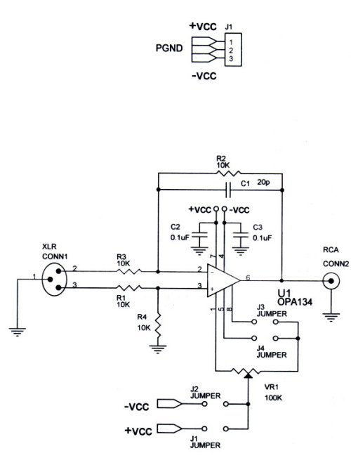

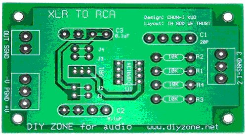

Hi .... I have been discussing this with Thomas......apparantly there is a board over at diyaudio.com....unfortunately this is in Chineese.......take a look ....can you translate.....maybe a group order could be done......................
link:
http://www.diyzone.net/article.php?sid=420:clown:
link:
Well if someone who knew alot about what they are doing (not me), came up with a great design, i'm sure we could do what we did with the A-X's? Have the boards mass produced and group ordered if we could sell enough... anyone else up for leading the project possibly?
