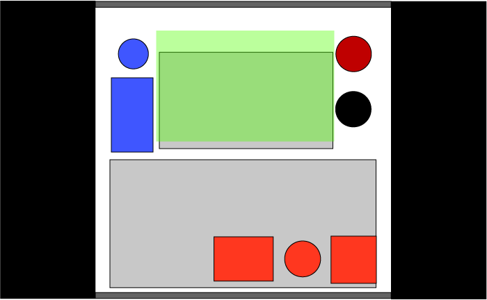

steenoe said:Any chance to stack the mainboard on top of the psu?
If yes, you could place it in the most opposite corner.
[/B]
I had been planning on stacking the main board over the psu but with additional height of the 500VA trafo vs 300VA I haven't got the space. The only other alternative I can think of is to mount the main board (indicated in green) onto the back panel as shown in my dodgy drawing of the back panel. The grey boxes are trafo and psu respectively and illustrates the limited space above the psu.
I guess mounting the board like this means I can use ultra short runs from input RCA/XLR's and to the binding posts.
