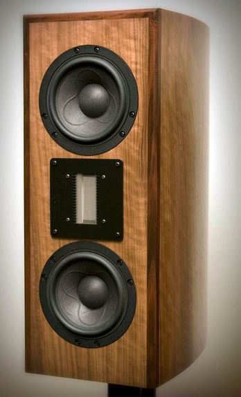

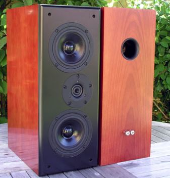

Here are some classic multiple driver speakers. They all have something going for them, IMO. Of course they are all expensive constructions and rely on some deep geometry. But, hey, we love speakers! 😀
BTW, the red Tekton Pendragon is mathematically unsound, IMO. Unless you use the 1:2:1 Philips binomial ratio on tweeter loudness.

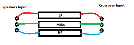

actually, I want the speaker as flexible as possible this why the passive crossover will be in parallel (each path can be used/unused alone
thus I can even have a second 2 way crossover to try the MTM part alone (without bass drivers) or use one amp for the MTM and second one for bass (instead of 3)

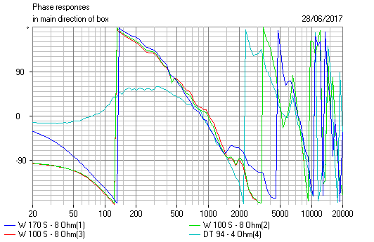

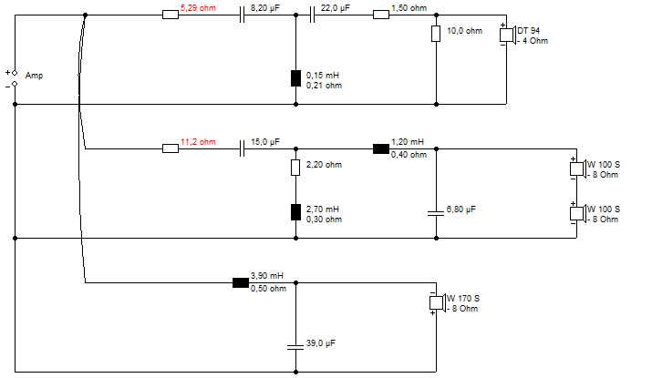

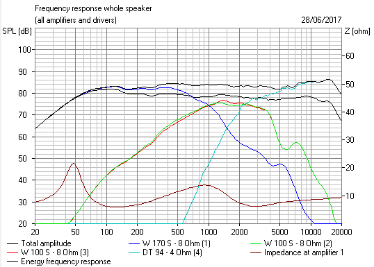

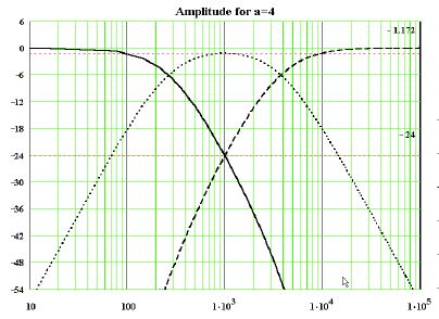

I just ran a similar WMTM up the flagpole. 6 inch bass, two 4 inch mids. And remember that this Duelund curve is what we are after:

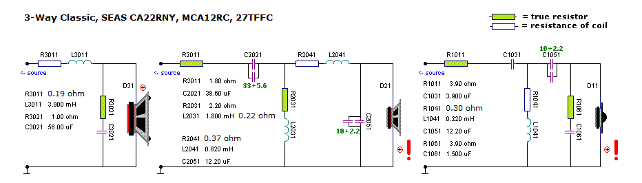

I nicked the MTM R2604 tweeter filter from Troels Vifa PL14WJ-, and we want that 1.5R/10R attenuator with an XT25 to fix the Fs impedance.
Took the bass crossover from the 3 way classic a bit higher. And built the mid filter around the two ends, which only has 4 variables really apart from level adjustment. All seem to work. 700Hz and 3kHz crossover. Loads of SPL in the midrange, as expected. Decent impedance and phase. Loads of slack on mid and tweeter level. All looks doable with your little tangband mids. Have a bash! 😎
Oh, I see I was a bit careless on driver polarity there. You'd conventionally have the bass positive and the other two drivers negative polarity... 😱
