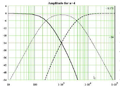

Steen Duelund worked out the mathematical theory. The extent to which Troels got close to the right curve determines success. Actually with a 3 way, you can use shallower LR2 aka 12dB/octave filters and keep distortion low. Less demanding, you see.

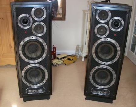

Here's a Wharfedale E90 WWMTM design. Genius, IMO. Simple LR2 crossover with the mids wired in series. This is a loud PA speaker in essence. I like the idea of twin drivers. You get 4X the level for the same distortion. And it fills the room.
But what a monster to build!
But it's not the only road to high efficiency.

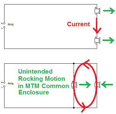

Pico, I actually think parallel wired drivers are very bad news indeed. At least in a common enclosure.
See, the natural tendency is if one driver is pushing out, the natural tendency is for the other to go in. It's just a nasty natural resonance. Out of phase, if you follow. Below.
When you wire two drivers in series, they get the same current, so work together.
I could quickly convert Troels' 3 way classic to multiple series drivers. Double inductance and resistance and halve capacitance in the filters. In fact I think the quickest way to a flattish impedance is using twin 8 ohm mids with single 8 ohm woofers and 8 ohm tweeters. Because the problem with 3 ways is always a low impedance in the mids.
Parallel or series doesn't make any difference at all, except impedance. (All other T/S-parameters are identical regardless of single, parallel or series use of a particular model of drivers. In other words, whatever is more convenient for the drivers you have can be done, no problem.

Wow. Way to win friends. Steve's dead right here. There are obvious differences, as Steve showed with his diagram. Push on one mid in a parallel MTM in a common enclosure and the emf (speakers are microphones) will cause the other cone to move out.
Additionally speakers are physical things with a natural spread to their parameters, so that should be taken into account.
Um, whether or not you push one driver and it affects the other is not really the issue. It is typically accepted as good practice to share acoustic spaces by identical drivers which share the same electrical signal, either in series or in parallel, whether or not they are sealed or ported.
The same forces will be distributed across the 2 or more drivers, though this may assume the drivers are within some wavelength away from each other.
