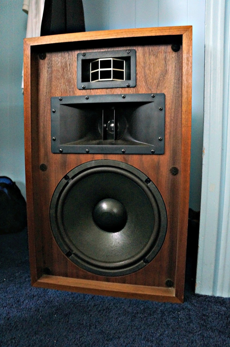

Recent years I made a few different 12" coaxial projects with PA drivers and are quite happy with them, still they are not fully complete on the crossover side but in general I like the PA sound of high sensitivity and punch. But as I get quickly bored I figured now its time to make my first attempt at a 3-way solution as reference hoping for more midrange clarity, and I have been thinking a lot about various drivers for this inspired by modern retro monitor speakers like Klipsch Heresy IV and JBL4319/4429 and older Pioneer CS701.

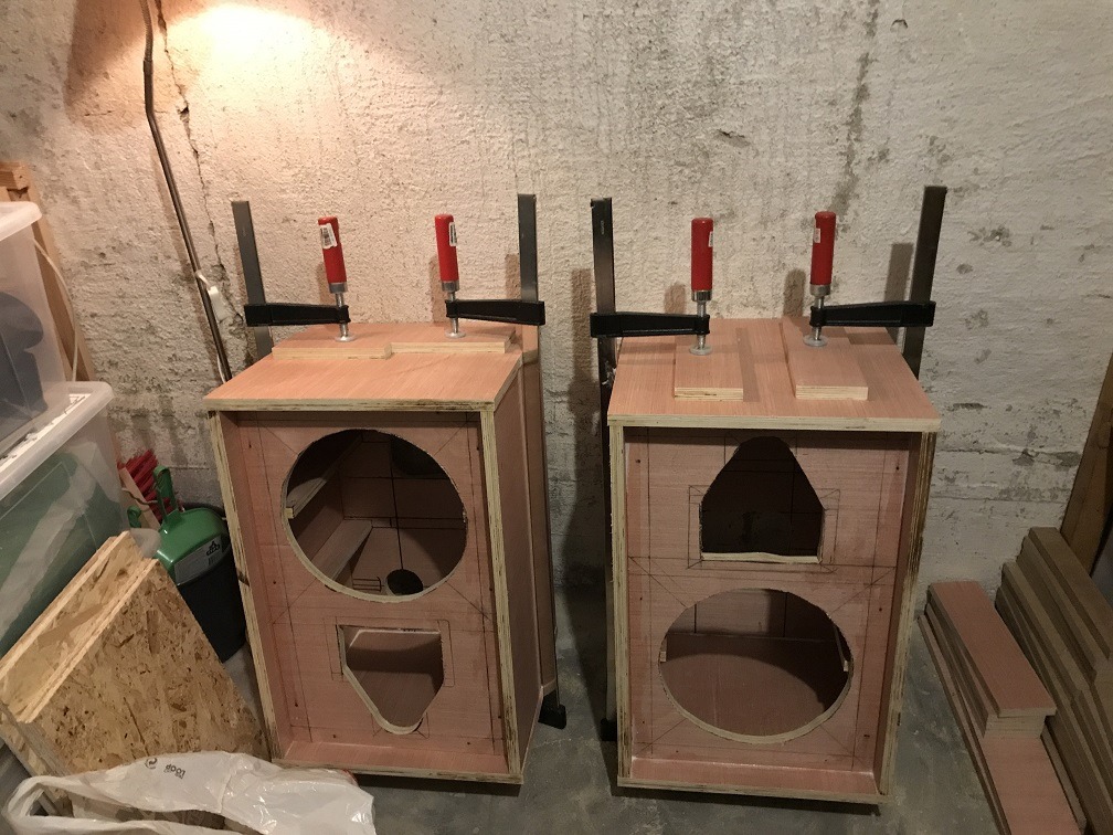

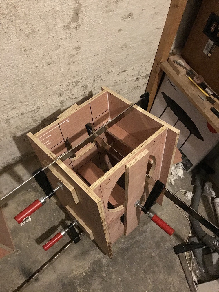

I will use the same "form factor" as my most recent coax design as I really like it: baffle inner 36x58cm, inner depth 30cm = approx 60l; outer depth 40cm, width/height 40x62cm. The box design allows a double front/rear baffle where the outer baffles can be replaced and it also allow up to 2cm thick grill to be sunken into the baffle frame, just as the Heresy which gives that retro look I like. My most recent projects I used pine, MDF and oak with various success. I plan now to use a single 1200x2400x19mm ply piece with cuts as shows in attached drawing - this is a cost-effective use of the piece and I can make many projects of the same for my future home cinema and studio.

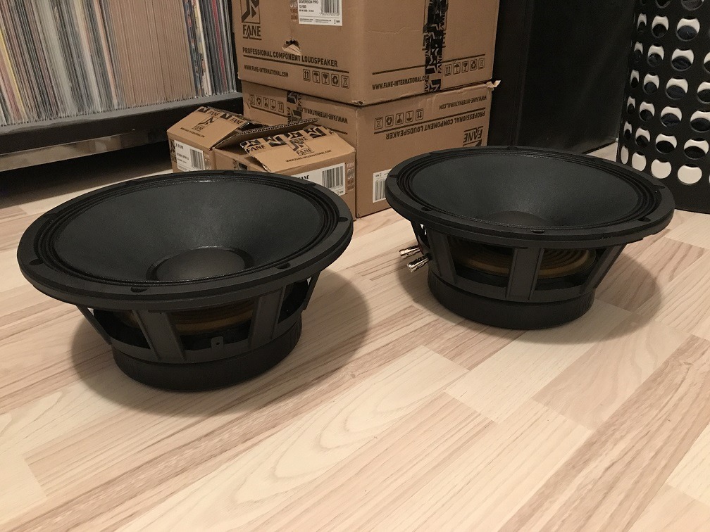

In a weak moment I came over Fane Pro 12-500 bass driver and procured it without thinking much about it, price is quite good and it ticks of most of my requirements to a 12" in a project like this. What a monster of a driver design, cant wait to test it. I don't expect much below 45Hz in a 60l cabinet. I'm thinking rear ported but haven't decided. I also bought Fane Studio 5 midrange driver, though I hadn't really decided whether I wanted a cone mid like the 4319 or a horn mid like the 4429, Heresy and Pioneer, but I just bought it as an option - I like to have things laying around, I can definitely use it in a project some day anyway. And this is where I might need some advice. More on that below.

After much pondering Ive come to the conclusion that I will save the 5" studio mid for a future project with a dome tweeter and a hifi-bass/sub leaving this project with a horn mid, Heresy style.
So here is my questions:
- Do anyone have experience with Selenium D250X driver? Is it any good? Will it work down to 500Hz? Could the D220Ti do the same job, if I cut at 1kHz instead?
- Id appreciate some advice on suitable horn flares preferably a bit larger and more rugged than the eminence I currently posses, perhaps some alternatives in metal/aluminum or similar, same for the HF flare, Id love something similar to the one in the CS701 or the Heresy. Any advice here?

Just a quick note that the Fane Sov. Pro 12-500 is a pretty decent driver, with a couple of caveats: there's a narrow 2.5kHz resonance which can poke out in a 2-way design; and it doesn't hold up well to high-power (1KW peak) inputs - power compression kicks in hard with the relatively old-school motor.
For home HiFi use, I expect it'll work quite well.

Thanks for input, I saw it a bit late already started assembly here 🙂
Will try various mid-drivers here in the APT150 flare and see it will most likely need to be a bigger one but for now focusing on the box.

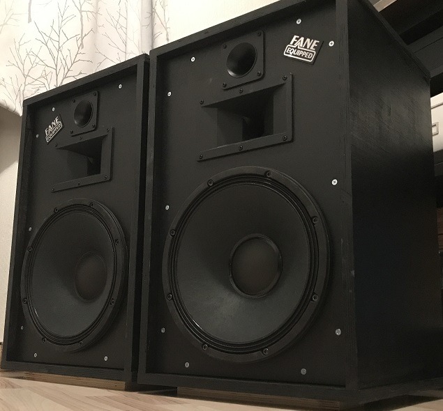

Some updates for those who may be interested; it’s alive!
At least two/thirds of it…

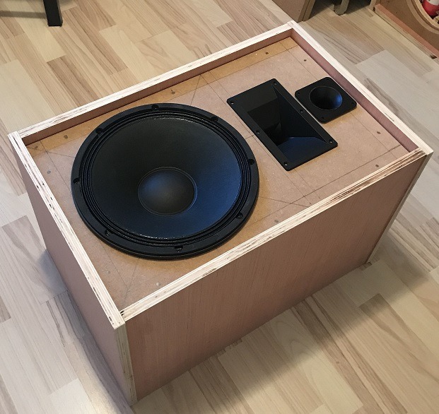

I’ve stuffed the box with a pillow and some foam and decides to use the Eminence APT50 and ASD1001 drivers because the Selenium is probably too heavy for any of these plastic flares.
Further neither of the Eminence drivers is probably capable on running much below 2000Hz and the same with the flares so I figure I just used a stock 2-way crossover for only one CD not connecting the APT at all at this point.
So it’s a two way with spare tweeter.. and it sounds really good. Smiling curve band for sure, just the way I like.
Box have some resonance issues so I probably need more stiffeners.
My goal was improved mid with three way though so I’ll continue the search for metal flares and will probably then get my hands on the Selenium 250 and play around with lower XO in a 3-way setup. Much fun anyway, all good.
The Fane 12 is a really strong bass driver imo, great for home use as well.
