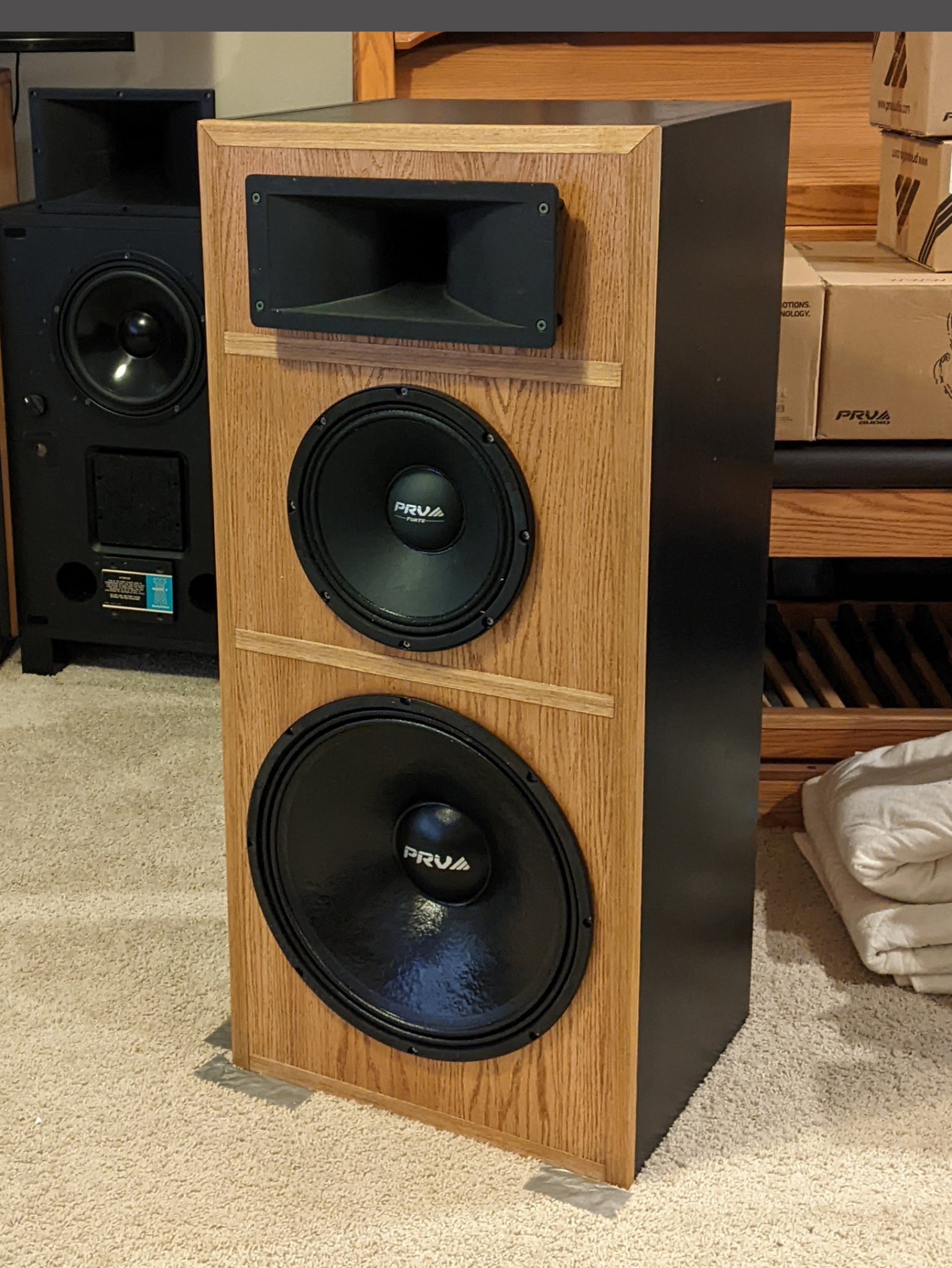

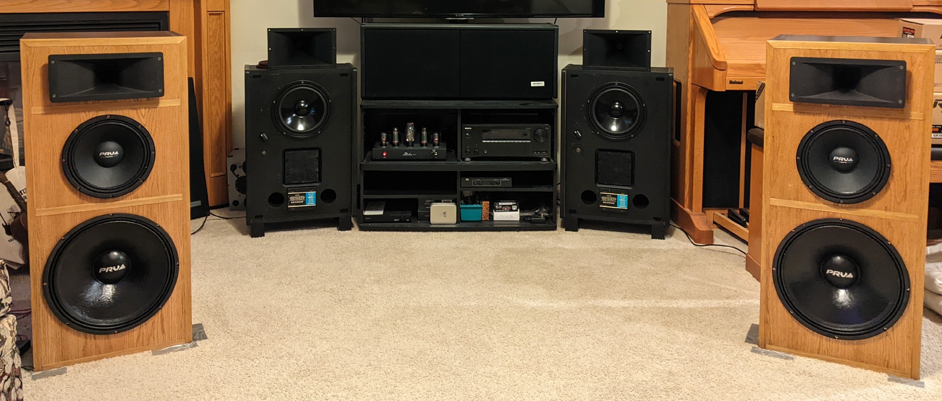

All done, and very pleased with the results. Sims and speculation are good, but the facts are that high efficiency drivers don't need a "certain amount of power to get them moving", and commercial crossovers have no issues at all with low power. My 2x7w has no problem driving these past 100dB with no audible distortion and great clarity. There is more available, but it would literally be painful.

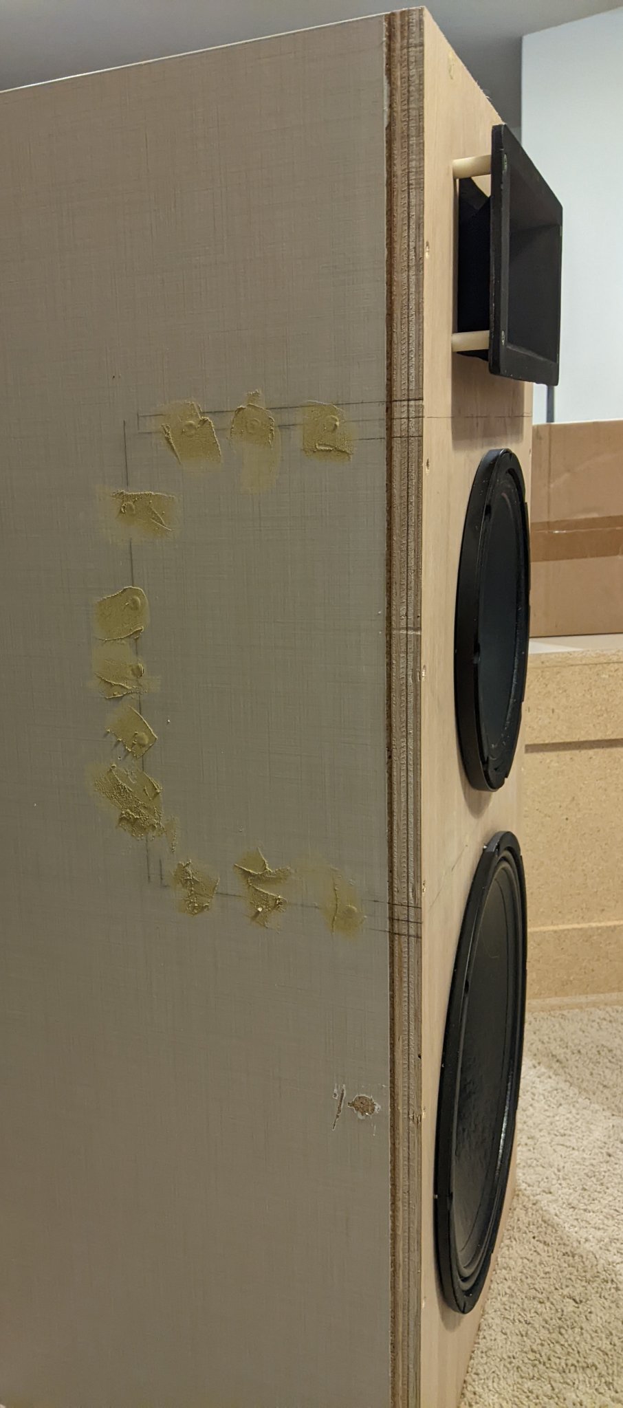

Btw, I wasn't happy with the rear ports, so I tried another way: spacing the horns out from the baffle. I used an assortment of nylon spacers and the DAT V3 to set the tuning to 40Hz. Port effect is much better, and driver alignment was also improved.
Four months in, 500+ hours, and these speakers have really opened up and are sounding better than ever. The biggest difference after extensive break-in is transient response and overall detail. These are heavy duty drivers, so in retrospect I could recommend breaking them in with something more powerful than tube amp I'm using if you want to hear the best sooner.
But there is absolutely no issue with my 2x7w EL34 amp being able to drive them. 120dB is easily achieved, way beyond what I will ever use. Regardless of what some would say, sensitivity is sensitivity - you don't need megawatts to drive these.

Eight months since these went into daily use, and still hearing improvements. Detail and transients are even further improved from my last post four months ago, not as much as then but definitely noticeable.
I'm extremely glad that "other forum" didn't discourage me from trying this. It is clear that when using drivers this "heavy duty", extensive break-in is necessary for best results. If I use such drivers again - and I will - I'll set one out of phase and set them face to face for a fairly long time on 200w+ worth of drive.
Checking in at 15 months of daily use and I couldn't be more happy. I've seen yet more improvements in transient response, and have tweaked eq a bit here and there.
With such low power it took a long time for things to settle in (though sound was great even from the start), and I would definitely recommend prolonged break-in at higher power if you choose such drivers. But my EL34 handles them with ease now, so I'm going to just keep enjoying them and do the occasional tweak.
