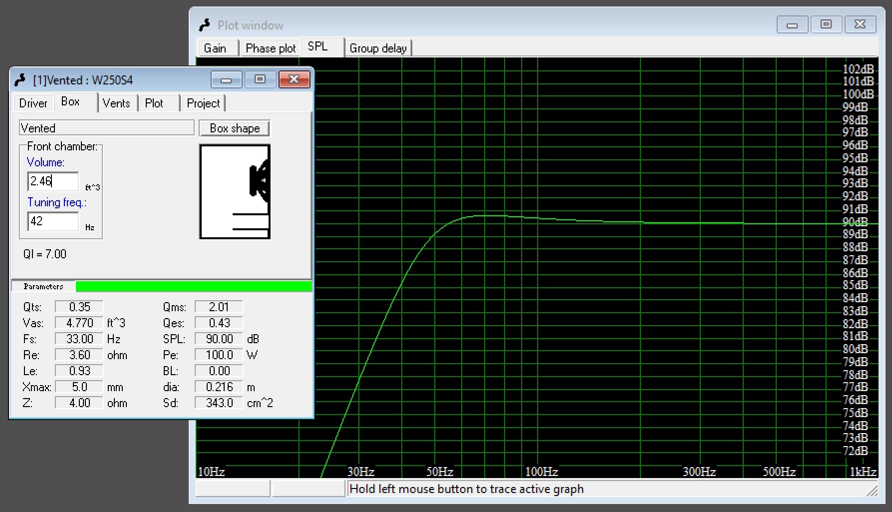

I wrote down the specs for the fifteen-inch PRV driver & plugged them into WinISD to simulate with those parameters given. Now we collectively seem to agree the advertised T/S parameters are NOT set-in-stone...apart from measuring these parameters directly with your own gear, considering them guidelines. As such, I got a WinISD resultant EBP (Efficiency bandwidth Product) rating of 57.3 ...the "rule of thumb" states, below a value of Fifty gets one a sealed preference, above a Fifty, points one towards a ported enclosure, at 57 this makes this driver "versatile" for either. Only by doing these simulations do we notice how good or poorly such drivers work in the sealed vs. ported situations. My personal preference holds Twelve-inch drivers at the maximum for sealed systems...this opinion coming from doing lots & lots of these sims...tweaking enclosure volumes, port sizes, Fb (box tuning frequencies)... I have found those drivers in the eighteen-inch sizes, rather useless & undisciplined...the fifteens being the best for the bottom end....the eight, ten, & some of the twelves like the sealed alignments.
In your choice of this specific PRV driver, WinISD wants a ported alignment of 1.1563 Liters of INTERNAL volumes, this alignment reaches all the way down to 20.15 hertz at a fallen rate of 3.09 Decibels worth. The very bottom of our human hearing threshold....more sensory vibrations felt than actual hearing. By using a sealed enclosure for this driver, all that big surface area is "wasted", never getting those impressive, window rattling, earthquake type frequencies.
Yes, the sealed system has the benefit of a so-called "reasonable" size, but at too high a cost for me. The ported version using my favorite dimension ratio gets you an INSIDE size of 1.321 Meters high, 1.049 Meters deep, 834.5 mm wide....and the drivers get mounted on the eight hundred thirty four mm wall.

I'm confused. You wrote 1.1563 litres of internal volume which is ridiculously small. But when I take your dimensions I get an internal volume of 1156.617 litres, which strikes me as ridiculously large.I wrote down the specs for the fifteen-inch PRV driver & plugged them into WinISD to simulate with those parameters given. Now we collectively seem to agree the advertised T/S parameters are NOT set-in-stone...apart from measuring these parameters directly with your own gear, considering them guidelines. As such, I got a WinISD resultant EBP (Efficiency bandwidth Product) rating of 57.3 ...the "rule of thumb" states, below a value of Fifty gets one a sealed preference, above a Fifty, points one towards a ported enclosure, at 57 this makes this driver "versatile" for either. Only by doing these simulations do we notice how good or poorly such drivers work in the sealed vs. ported situations. My personal preference holds Twelve-inch drivers at the maximum for sealed systems...this opinion coming from doing lots & lots of these sims...tweaking enclosure volumes, port sizes, Fb (box tuning frequencies)... I have found those drivers in the eighteen-inch sizes, rather useless & undisciplined...the fifteens being the best for the bottom end....the eight, ten, & some of the twelves like the sealed alignments.

I think that should be 1.1563m^3, not litres. In any event the box is indeed ridiculously large, over 40 cu ft!
If we take WinISD results seriously, this driver is basically unusable in any form.

If you have Excel, download Jeff Bagby'd WBCD (woofer box & circuit designer) and play with the numbers. Just Google Bagby WBCD.I think I'm seeing the issue, WinISD is completely borked for this driver. Where Parts Express recommends volumes of 3 cf sealed and 5 cf vented, WinISD recommends a refrigerator for sealed and a bathroom for vented. Something is clearly wrong here lol!

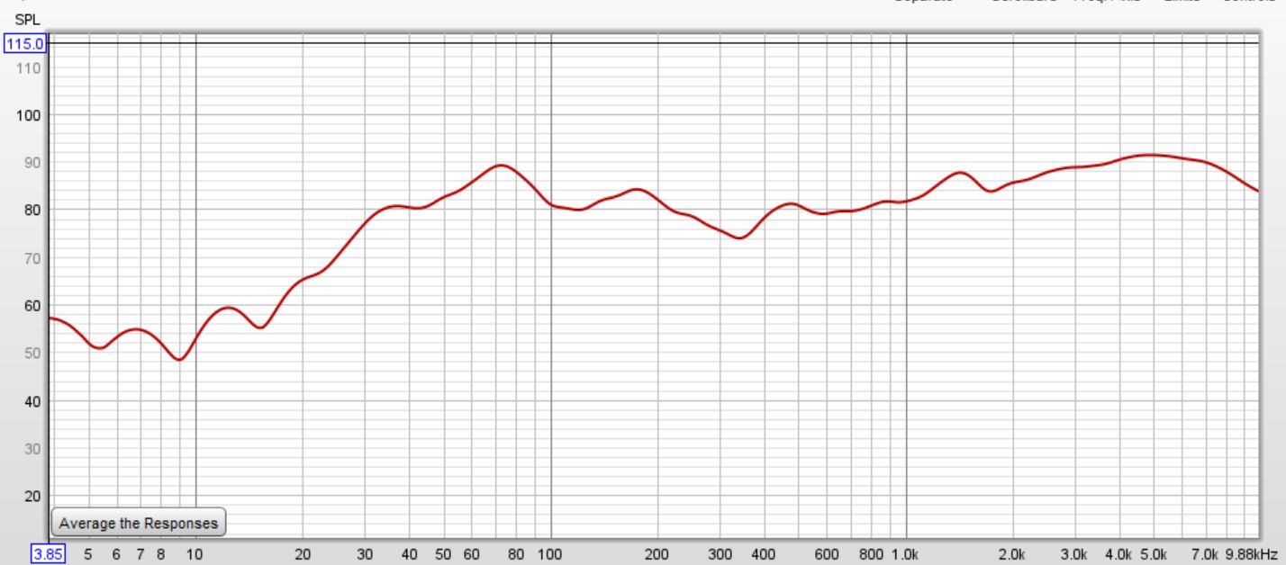

Out of curiosity I modeled my current 2-way build, then measured with REW. The driver is a Visaton W250S. Mic is Dayton UMM-6, soundcard and mic are calibrated. These speakers have very audible response down to 30Hz as shown with REW, but you'd never think it possible if you trusted WinISD!
And yes, that boom at 70Hz is noticeable but not intrusive. And the dip at 350Hz is actually beneficial. 🙂
Additional info on the REW graph in Post #33: The high drivers are PRV D230TiB on Dayton H812 horns. Crossover is 12dB at 2k Hz.

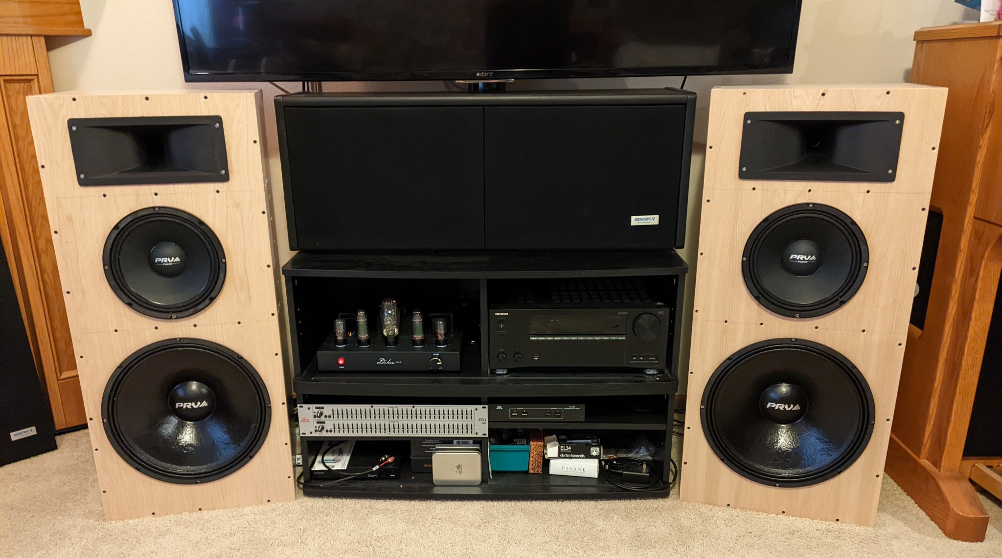

Considering all the naysayers here, I've assembled one of these enclosures for some preliminary testing. No extra bracing, no insulation, everything held together with just a few screws. I'm happy to say that it sounds and measures great! They will need some fine-tuning, but it is very clear that speaker sims are just that, simulators. They are an interesting starting place, but old time knowledge and intuition still works. And REW is your friend. 🙂
All assembled and doing some break-in. I wasn't happy with the compression drivers, so I changed to the PRV Audio D260My-B 1" Mylar. The 230's were struggling to keep up, but these 111dB mylar versions need a bit of attenuation and sound much more smooth. There's still a lot of finish work to do, but overall I'm extremely pleased with the results. The Chifi EL34 has no issues at all, and can be run much lower than I did for my prior 2-ways.
