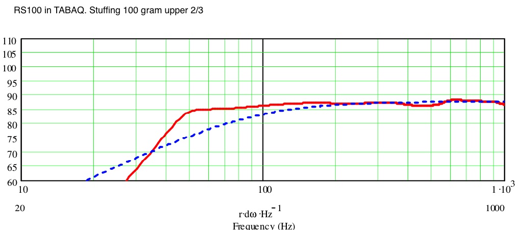

I'am working on the simulation with the Dayton RS100-8. I am started from about the measures of the BabyLabs and this is the new results:
Seems to be a better results, no?

Hi Bjohannesen,
Thank you very much for the simulations.
I see that you use 100gr of the filling, in my simulation there are less less filling (about 20g I think).
Which filling do you use?
What do you think about my previos simulation?
Hi Bambinz
The dips and peaks look very much like the ones I get with MJK`s models.
The stuffing I use in TABAQ is 100 gram or 60 gram for the 4" drivers with a lower Qts.
Hi
Bjørn
Hi
Bjørn
Which material did you use?
Thank you ! 🙂
For the others questions? could you help me?
