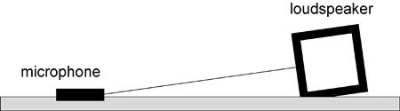

I'm really after off-axis response at 0°, 15°, 30°, 45°, 60°, and maybe 75° from about 500 Hz and up.
I take it I just need to rotate the speaker or should I move the mic? I think the issue is going to be interesting because the speaker is going to be tilted forward. So on what axis do I rotate the speaker?
You can move the mic , if doing so then you want the speaker upside down , tilted over.
If you use a 4x8 board you can have the degree markers measured out on the board ...
regards,
Like this:
The arc with the arrows illustrates the placement of the microphone on the blue 4' by 8' sheet. The cabinet is tilted about 10°*forward and upside down.
The radius of the arc is 48", the limit of the 4' by 8' sheet.
The thing is that the relationship of the arc arrow along the blue 4' by 8' sheet changes with angle. Even though the arc is constant radius, the distance between any point of the arc and that of any driver does change.
How does this impact the measurement?
When finding the largest reflection free zone, you'll probably decide to place the speaker and the mic at half of the ceiling height. The reflection free time will improve with the mic closer to the speaker, but too close is naturally not a good thing. Once you decide the closest you're willing to go, work out the floor/ceiling bounce time, which should be the same, and put the speaker in one corner far enough to make the reflections at least the floor/ceiling time. Leave at least that space around the mic as well. 500Hz isn't usually a problem.
