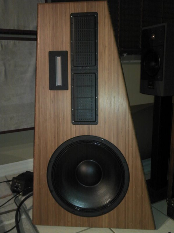

Sorry for the long delay, but I have been so busy lately and I still am.
I did a quick on and off-axis set of plots (three). Holm does not display more than 3 at a time and I am having such a horrible time getting half-way usable measurements in my room that it makes the process complex.
Getting measurements outside is not a good option as it is very noisy right now. Most of it appears to be insects and a steady Florida breeze.
My final attempt was to lay the speaker on its back on a 15" stool in the middle of the room. Bear in mind this is a typical Florida house with ceramic tile floors everywhere. The mic is moved above the speaker in a 41" arc and directly in-line with the Beyma ribbon tweeter.
I took 3 horizontal dispersion readings (0 degrees on axis, 30 degrees, and 60 degrees off-axis). My goal is to get a feel as to how bad the TD15h is off axis at the crossover point of 1.2 kHz.
The actual data is better than expected. I had expected a huge hole at the crossover, but it was not as horrible as I surmised. Your opinions may be different.
I have no explanation as to the suck-out at 12 - 14 kHz is from, but it is way above the crossover frequency. Maybe it is diffraction?
Anyway, please feel free to comment on the data or the procedure used to get the data. I'll answer all questions I can.

With gating at 700 Hz, your data resolution is only 700 Hz. The off-axis response at 1.2 kHz may not be a good representation.
Yes, it's a horrible environment to work in. I think I may need to transport one of the speakers elsewhere to do a better response than that or maybe something to the room. I don't know yet.

I think the issue with that is blankets will probably absorb some of the high frequencies, but will be pretty transparent to bass, which is probably the primary culprit that is causing the high gate times.
I have some 2' by 4' panels of 3/4" ridged fiberglass insulation that I might try stacking up as one mechanism to absorb some of the reflected sound.
