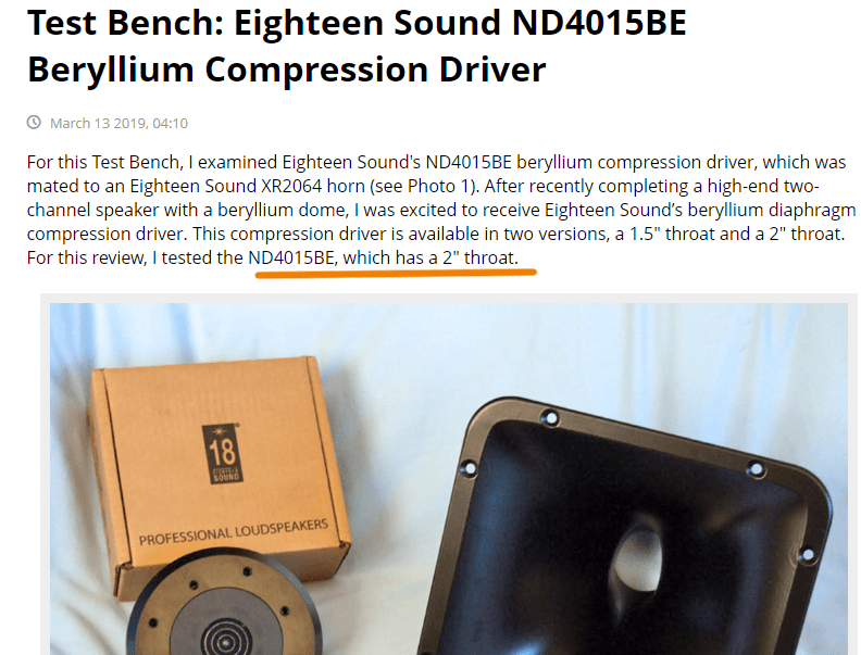

There only exists one version of the 4015. That has a 1,5" exit, and different diaphragm materials hence ND 4015BE , N and Ti2.
Check the brochure i added,it used to say the ND4015 was available with 1,4" and 2,0" throats, by fitting throat adapters again.
The picture you linked from voice coil clearly shows the 1,5"exit ND4015 besides the 2" exit 2064 wether you see it or not🙂
And yes i should read more closely sometimes👍 But still the review is pretty much a hack review of a ND4015BE making it look a lot worse in performance then the driver itself is.
2" version would be a ND4020BE in 18S webpage these days.
What was reviewed was a ND4015be 1,5". Hopefully with the 18sound adapter i linked below attached. But clearly the Combination of ND4015BE, 2" throat adapter and XR2064C is not a good solution for the upper octave. Not that it is something shocking for a 2" exit compression driver from 10-12k and up. But the measurements clearly shows the is a mismatch in geometry somewhere along the exit path or similar, it drops 15db! 9-10k, along with clear traces in the impedance curves that are not there in the mfg. datasheets, or other measurements, that also occurs around 5khz, where you can also see the THD increase.
Go to Eighteensounds webpage, look up the ND4020Ti2 and ND4015Ti2. see if you can spot the difference. Hint: look at the link below.

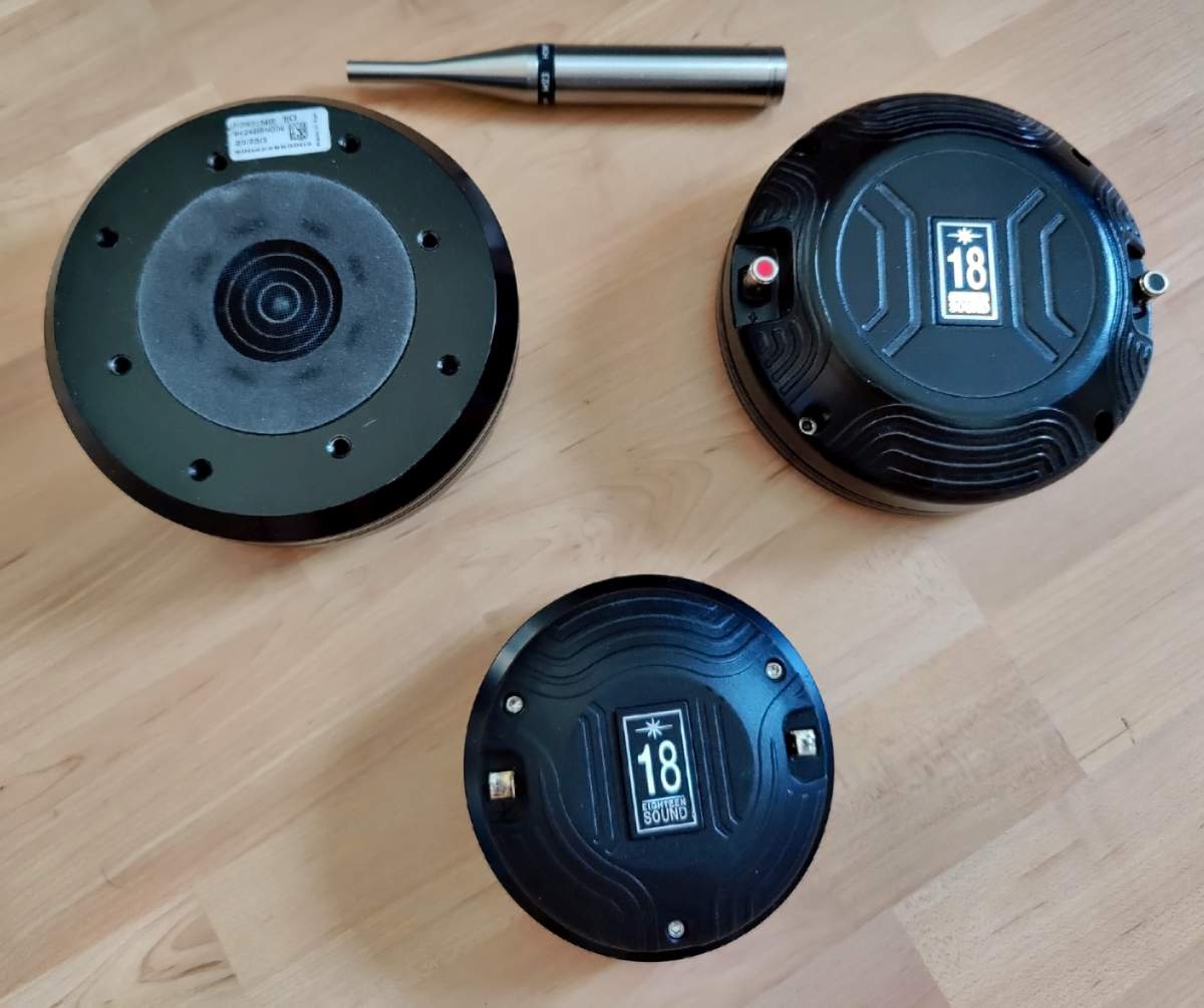

They're 2" drivers mentioned above does not have the phasepulg at the driver exit as shown in the picture below, of the ND4015BE stolen from @docali webpage. That is actually a important thing to consider when looking for a driver, and a horn /waveguide to match it to.
You also never see the throats of the drivers in the mfg. webpage.
Straight from 18S's website, in the drawing of the 4020 you can clearly see where the ND4015 driver ends and the throat adapter begins.
Separated by the line. Also easily visible in the 18S webpage of the mentioned 2" models.
That Voice coil mag, have'nt got the details specified or shown is not my fault or yours 🙂

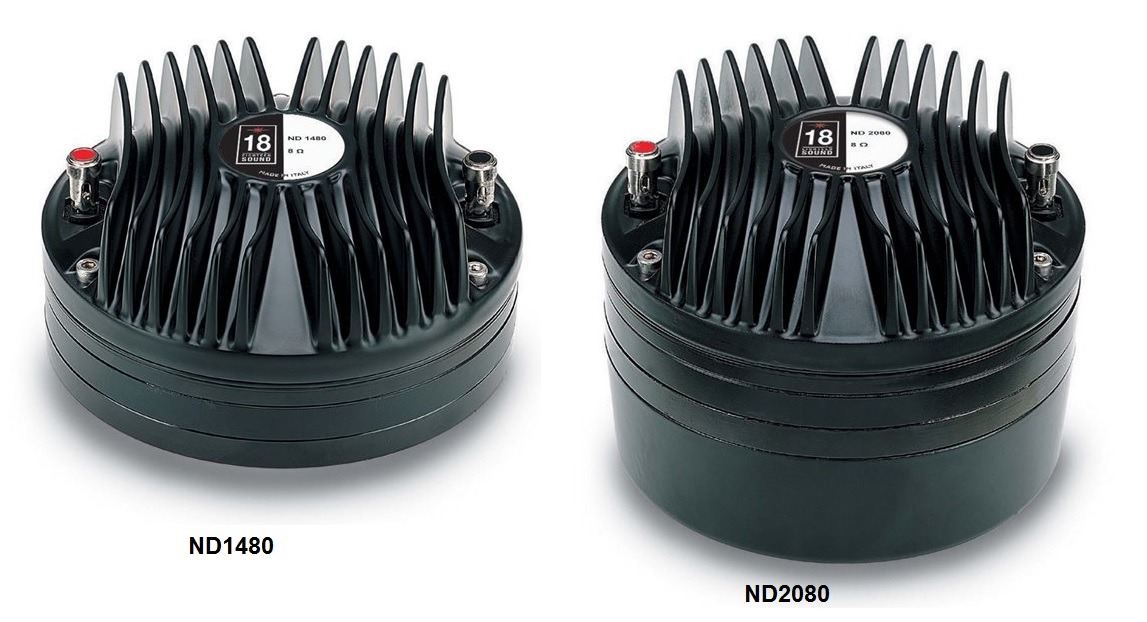

Another view of the ND1480 and ND2080 if anyone is not convinced, from both sides, easily showing the difference and the fact that it is a throat adapter, not a different driver. Meaning that of 18sounds selection of 2" compression dirvers only 2 out of 9 are anything close to 'unique' drivers.
If you look at the HD3020T and HD2080T you can easily see what drivers they dripped down from, in the 1,4" exit range.
But they have shorter throats with faster flare rate, being that the throat is contained in the depth of the Ferrite magnet motor structure. So there is some difference beyond the simple throat adapters.

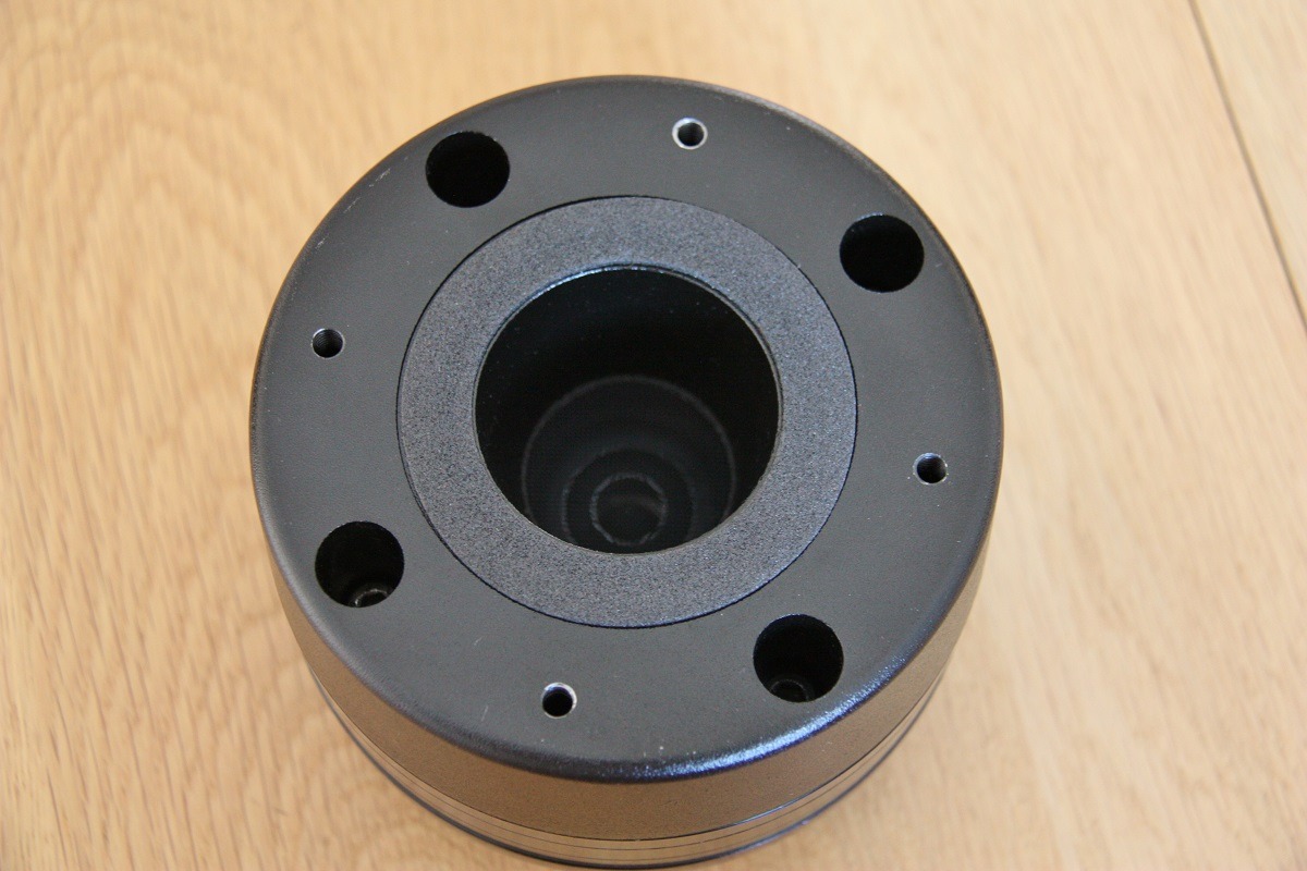

Look at the picture below of the 2080. You see the phaseplug exits into a seemingly straight circular / conical? adapter.
Also keep in mind the exit angle of the ND4015 is close to zero.
Compare the drawings of the ND4015Ti2 and the ND4020Ti2.
The driver depth of the ND4015 is 56 mm, the depth of the 4020 is 90,1 mm. a difference of 34,1 millimeters
There is a sharp discontinuity from the exit of the ND4015 into the circular/conical 34mm long 2" throat adapter, which pretty much explains the issues as viewed in the review in Voice coil mag.
