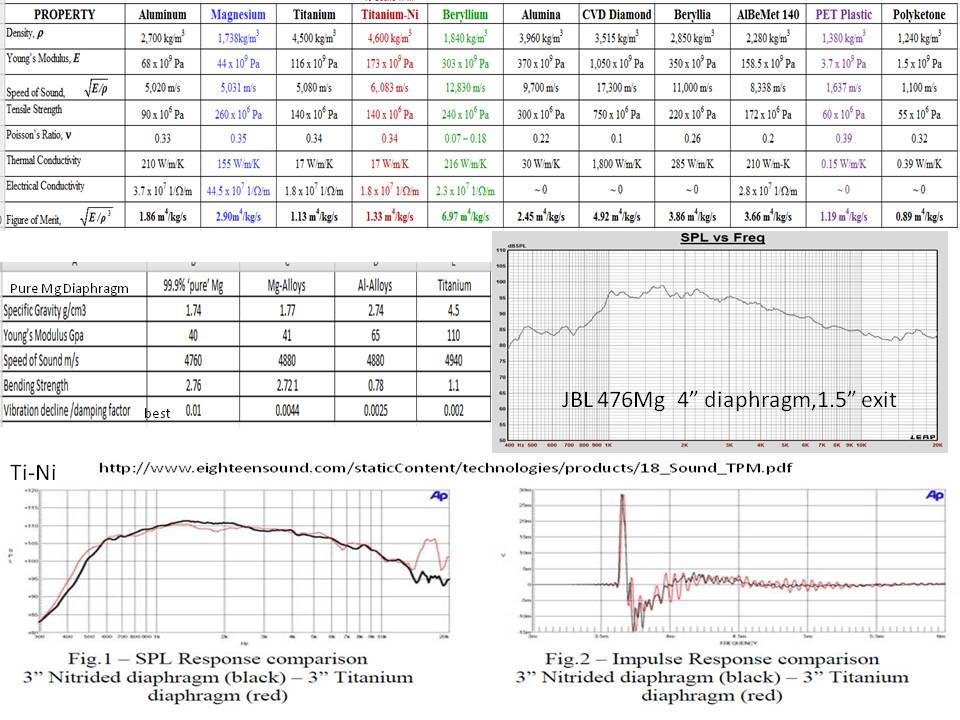

There are titanium drivers out there that sound good.
"With its very high value of elasticity modulus (six times higher than titanium and two times higher than beryllium), nitride coated film is capable of doubling the titanium stiffness. The piston frequency range motion extends frequency by 25%, showing a predictable, ideal frequency response decay and avoiding top-end spurious resonances"
0008 NSD1480N - HF Drivers - Neodymium NSD1480N : Eighteen Sound - professional loudspeakers
Physical properties of common diaphragm materials, including 18Sound Ti-Ni.
Interested in more information on compression drivers with magnesium diaphragms.
I would like to compare magnesium with the 1.75" PET plastic diaphragm in my 1" compression driver.

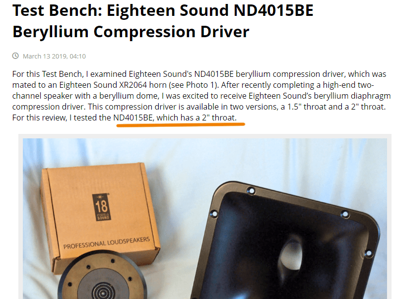

This review by Voice coil mag /Vance Dickason is laughable.
Response measurements, impedance, etc looks atrocious.
Took a 1,5" exit driver at 2500$ a piece.
Measured it on a 2" horn/ waveguide. Assuming with a random? and badly matching throat adapter by how the measurements look.
And did not inform the readers about it, as most do not notice the horn it was tested on is a 2" exit ( 18S XR2064 ) that causes the anomalies in the 10khz+ range. So the review is not really useful or representative of the performance of the driver.
https://audioxpress.com/article/test-bench-eighteen-sound-nd4015be-beryllium-compression-driver
So when looking for data on the 4" ND4015BE's, look elsewhere then voice coil magazine
