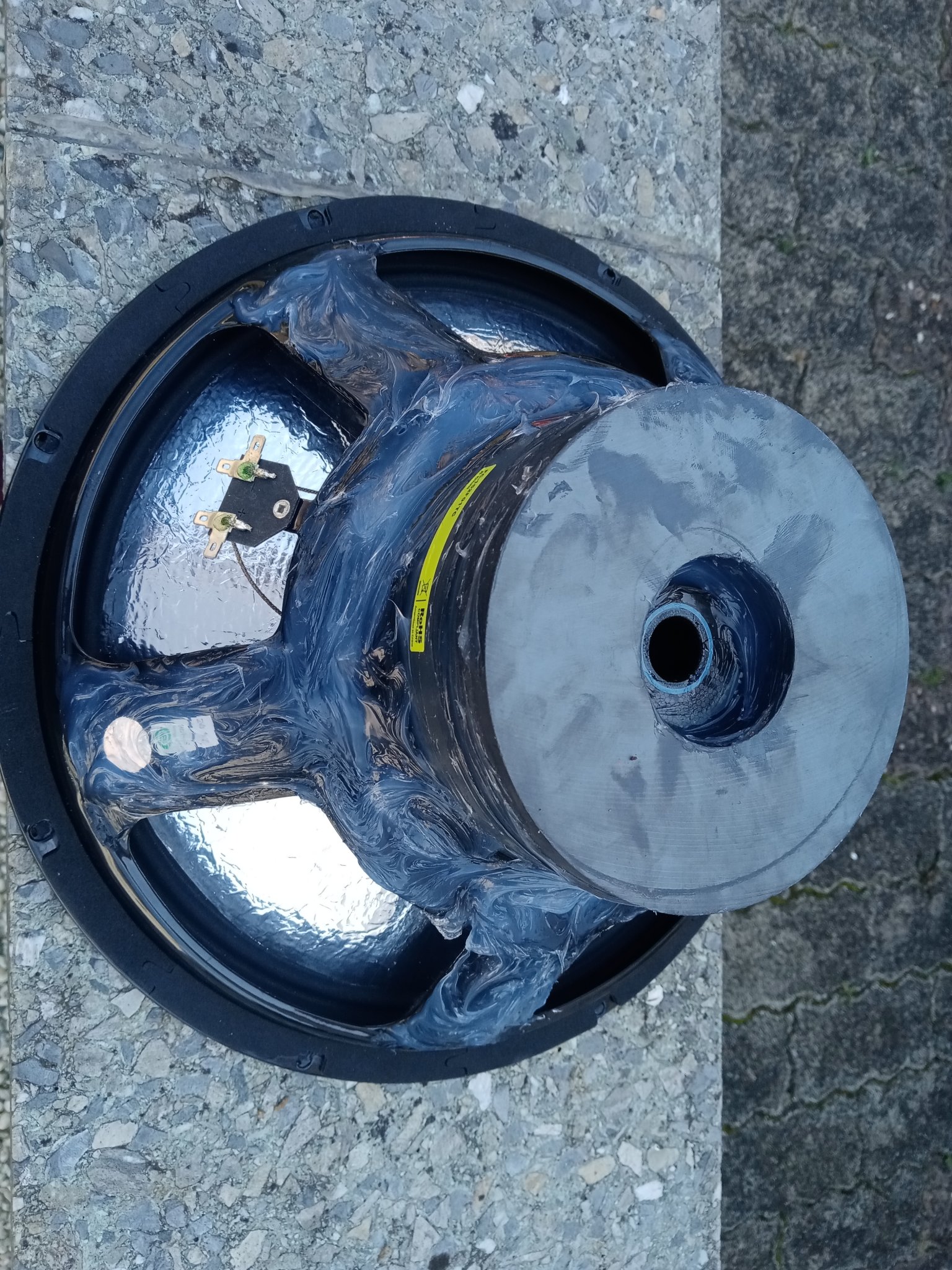

New 12" Full-Range: Fane 12-250TC
@Oceanw

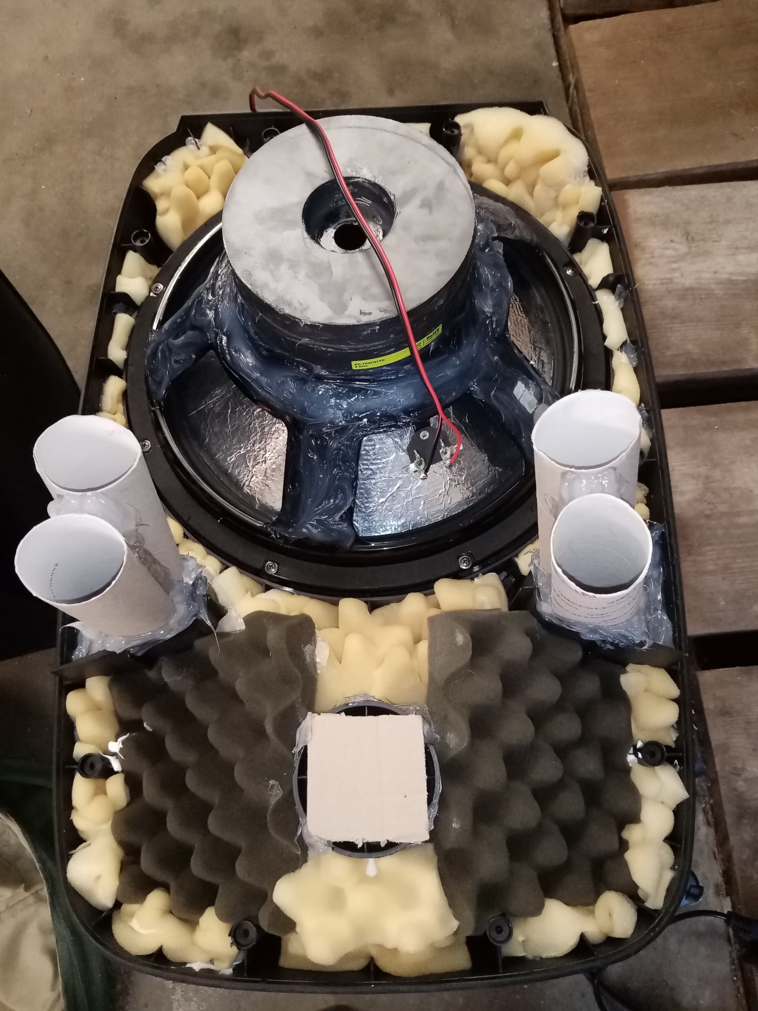

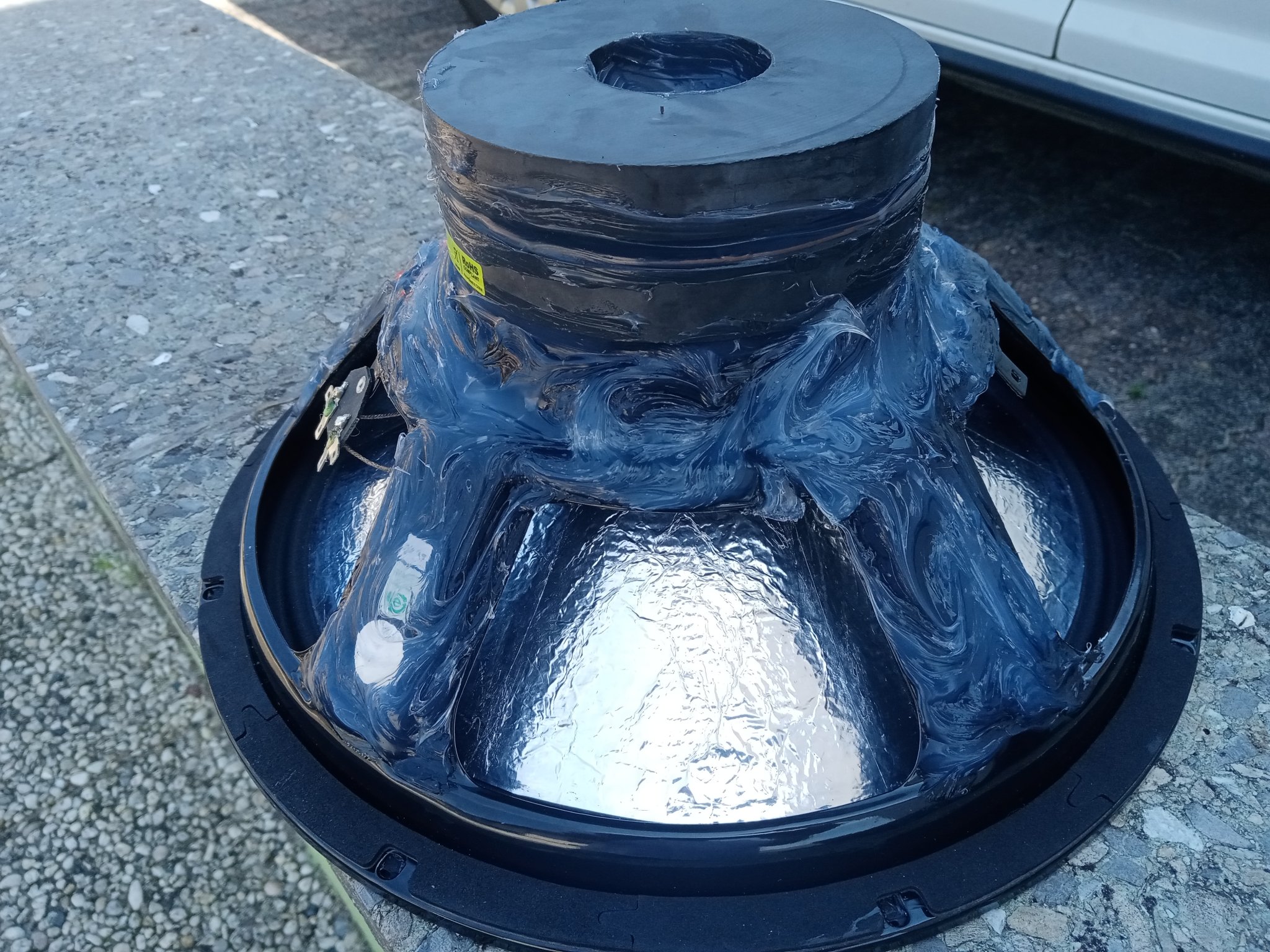

did not get any alubutyl but used silicone for deadening the metal frame
added a same size magnet for a little bit more efficiency
bigger brother Fane 15-300tc
used contact glue for fixing the magnet and later secured extra with silicone
does not look as nice but is functional
Reactions: Oceanw and GM

I still assemble the loudspeaker(s). And I had no motivation for doing measurements on the magnet tweak but making the speaker ready to play instead. As I have another untweaked pair of Fane Sovereign 15-300tc and waiting magnets I could still do measurements one day if I manage to finish another pair.

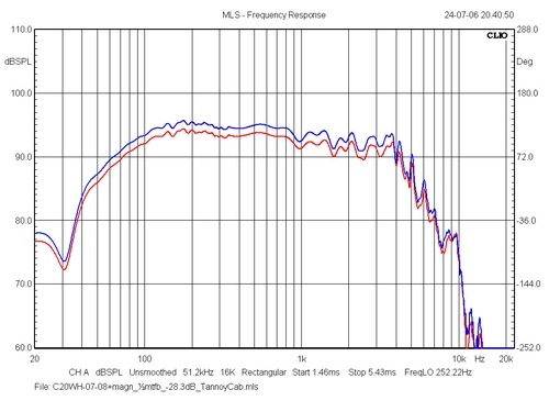

Troels Gravesen once measured a doubling of same size magnets in a loudspeaker project with +1.5 db efficiency and a drop in Qts by 0.1. What looks nice on the spec.
In my project the magnet would only compensate for the heavier loudspeaker cone due to a tweak with household aluminium foil on both sides.
The magnets are not expensive and all tests I did until now with doubling the magnets showed an audible improvement in control and loudness.
Only in one project with a PA 20cm driver I converted to a fullrange driver a same size double magnet did not show any improvement. So here I did not glue a magnet on. This is the only time I did it measurement assisted and it showed no change in efficiency.
Troels test with same size magnets:
http://www.troelsgravesen.dk/C20WH.htm

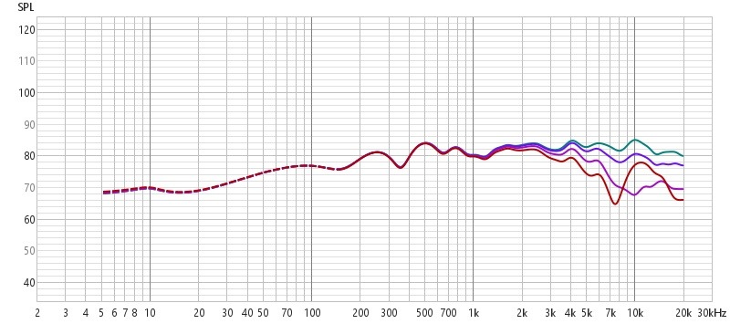

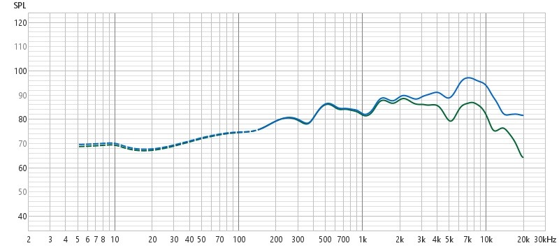

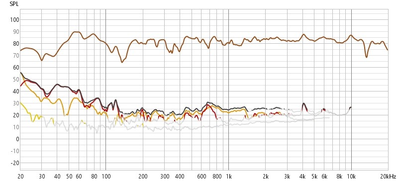

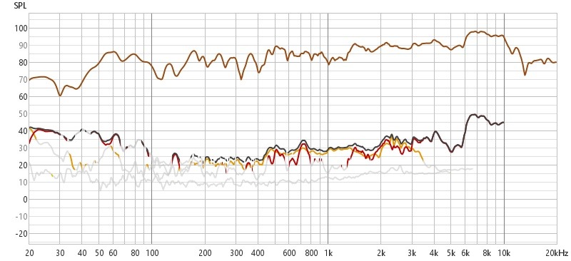

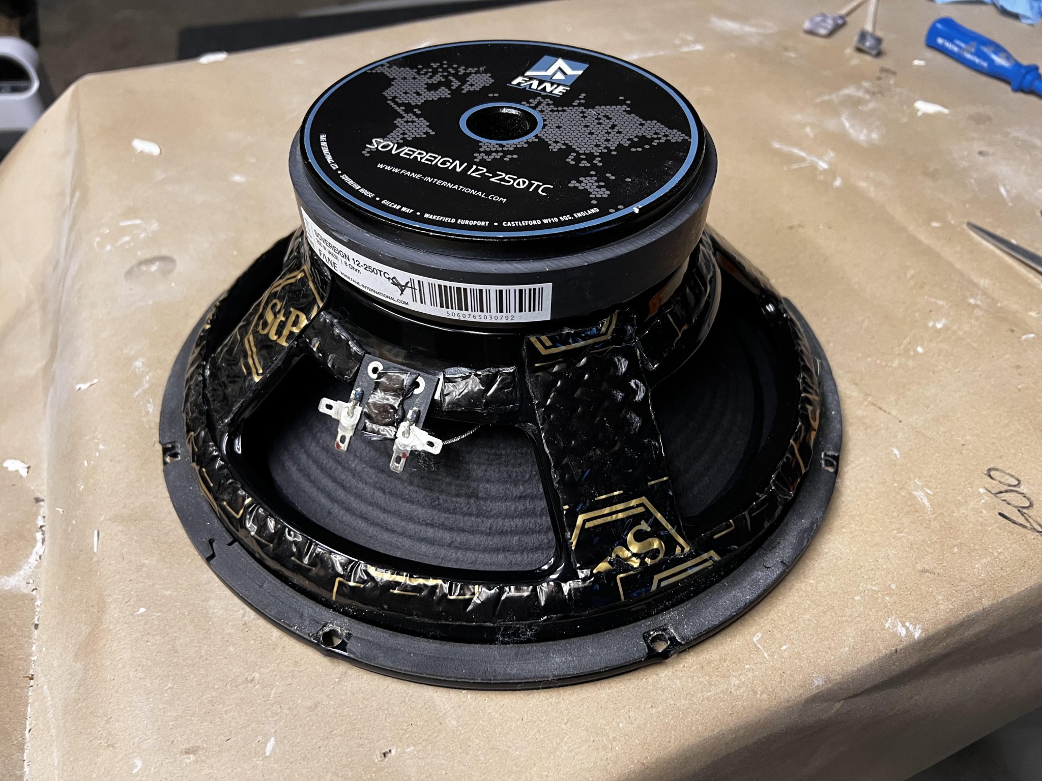

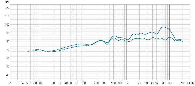

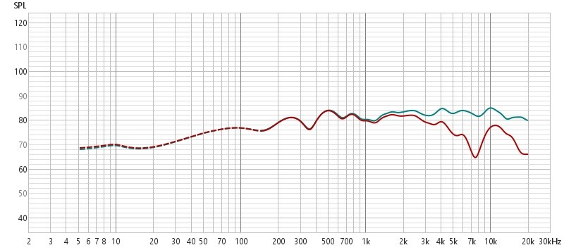

As my own waveguide projects have been on hold for a while, I've been helping a friend with his 12-250TC project. He built approx 140L enclosure for it, which is a transmission line. I can't yet comment on how well it turned out, as we haven't had the chance to listen to it in his living room, only in a less-than-ideal workshop space. The most interesting observation so far has been how much damping the pressed steel frame of this speaker affects its performance.
We used sound-deadening matt for car-audio called STP (similar to Dynamat etc butyl rubber matts)
First pic is on-axis and Hor 15 angles of undamped basket:
Pic 2: Damped basket Hor 0 and 15
Pic 3: Undamped and damped comparison, On-axis / Hor 0
Pic 4: Distortion undamped, Hor 0
Pic 5: Distortion damped, Hor 0
Pic 6: Damped in different angles
Hello, which STP foil is this exactly (STP Bomb Aero, STP Aero, STP Black Silver, STP Black Gold, ...)? I'm asking because the different foils also have completely different damping properties.

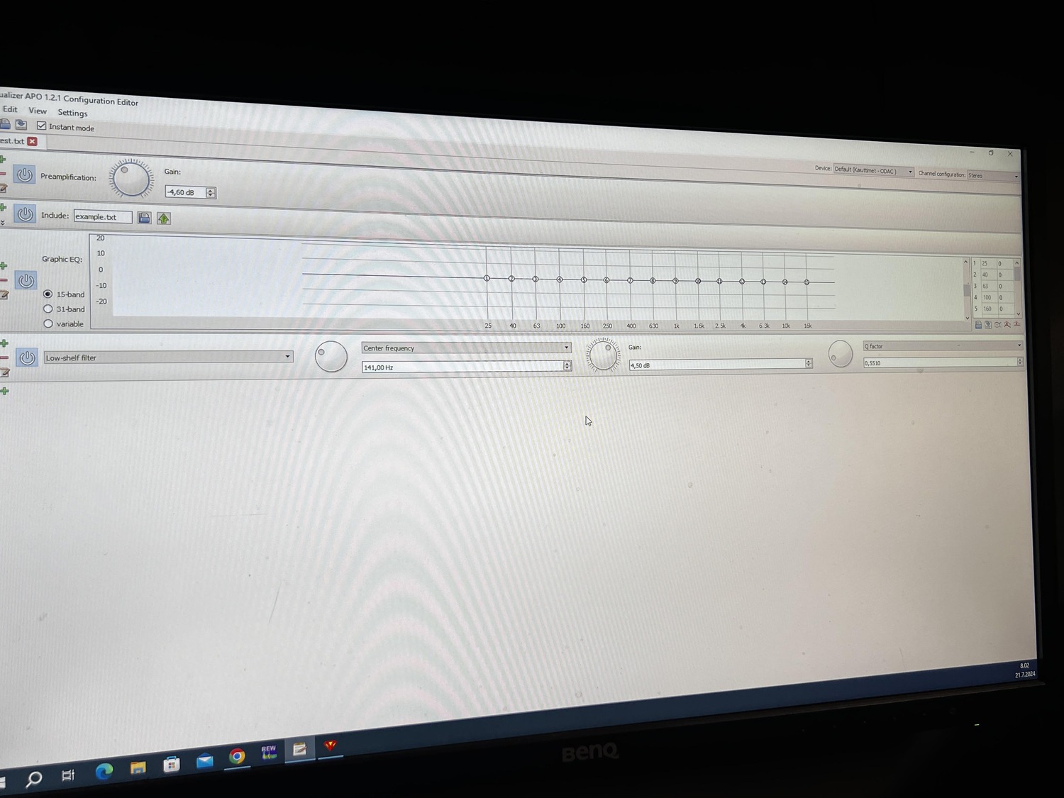

I noticed in my friend's 12-250TC project during test listening that many audiophile vocal and acoustic tracks sounded great, but when switching to rock or other genres, the sound was too bright and lacked fullness and warmth. The situation improved when we tried a baffle step correction, which was implemented using the free EQ APO software. We had a computer as the audio source anyway, and adjusting the level of the BSC filter in EQ APO was easy to do during listening.
How wide is the front baffle of your speaker? If it is similar or close in size to my friend's, I can check the filter details for you. I would recommend trying this first without the subwoofer. If it works, you could then design a passive version of the filter and invest in the necessary components.

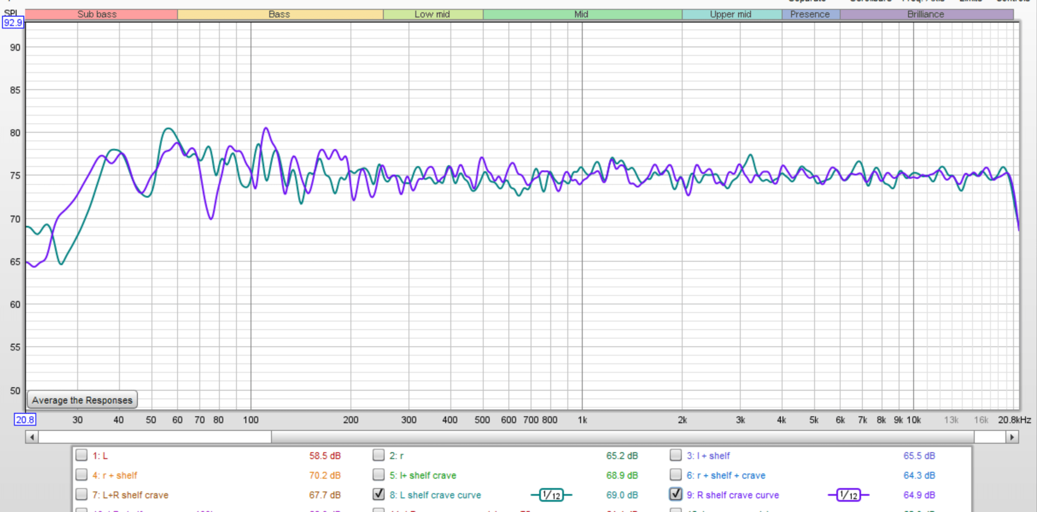

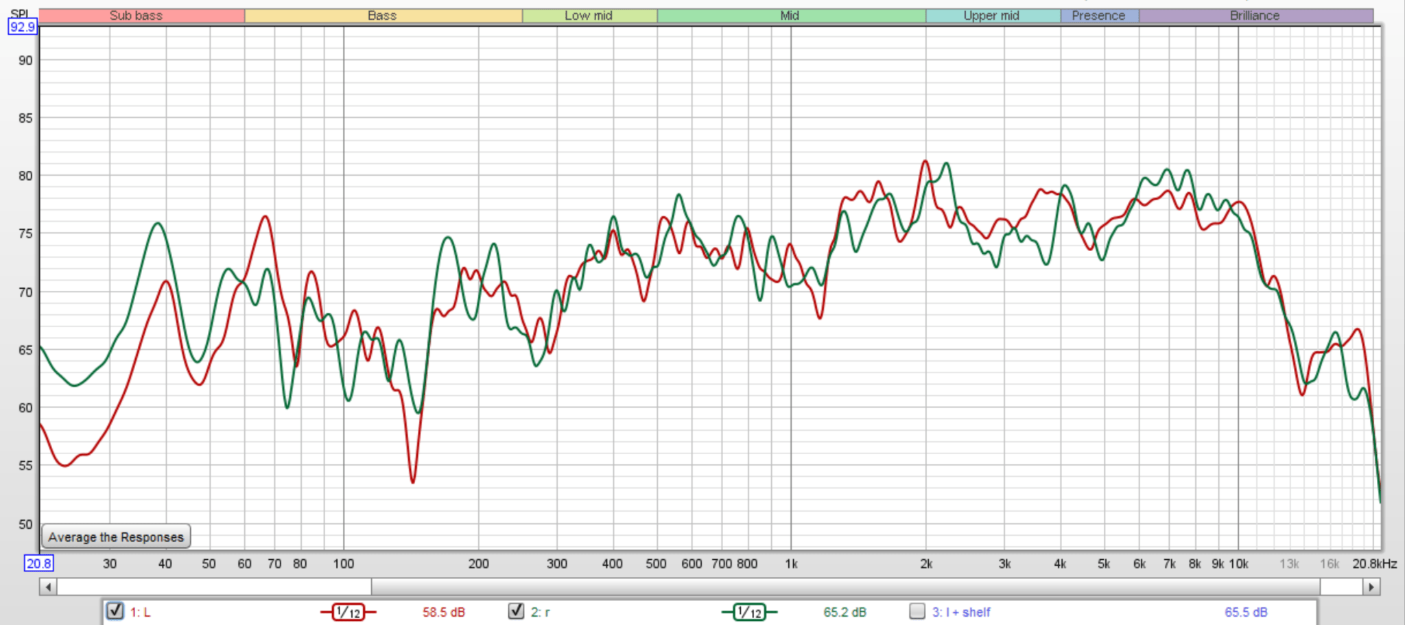

I am only a fan of correcting a fullrange loudspeaker in the nearfield of 20cm but not at listening position. But everyone can try out what works better in his room. Orthodox is to correct the speaker and later to do some room treatment and maybe a little bit dsp in the bass and highs due to the room reverberation characteristics. But not too much. And I would not linearize to much all small peaks. In my eyes its better to apply filters with a parametric EQ and to hear every filter and variate it in listening tests also checking your own recordings of real instruments - using the instruments live in the room and let play your box against the original at the same time(!) For indirect sound field I would add indirect tweeters which should do nothing below 5khz for that and have directivity for not interfering with the main signal.
https://www.audiosciencereview.com/...overeign-12-250tc-project-measurements.35301/
the uncorrected measurement is a typical far field measurement I know this looks quite different in the near field.

Fanetastic´s front baffle is approx 516mm and my friends speaker is 375mm so the BSC that worked for us is not necessarily suitable. There is also other factors like speakers distance to front wall and other room effects, BUT you could try this with EQ APO easily: (made rough sim with Vcad)
Add: Low shelf filter and use center freq: 141Hz, Gain: 0-6db (adjust on the fly when playing music) and Q: 0,5510
