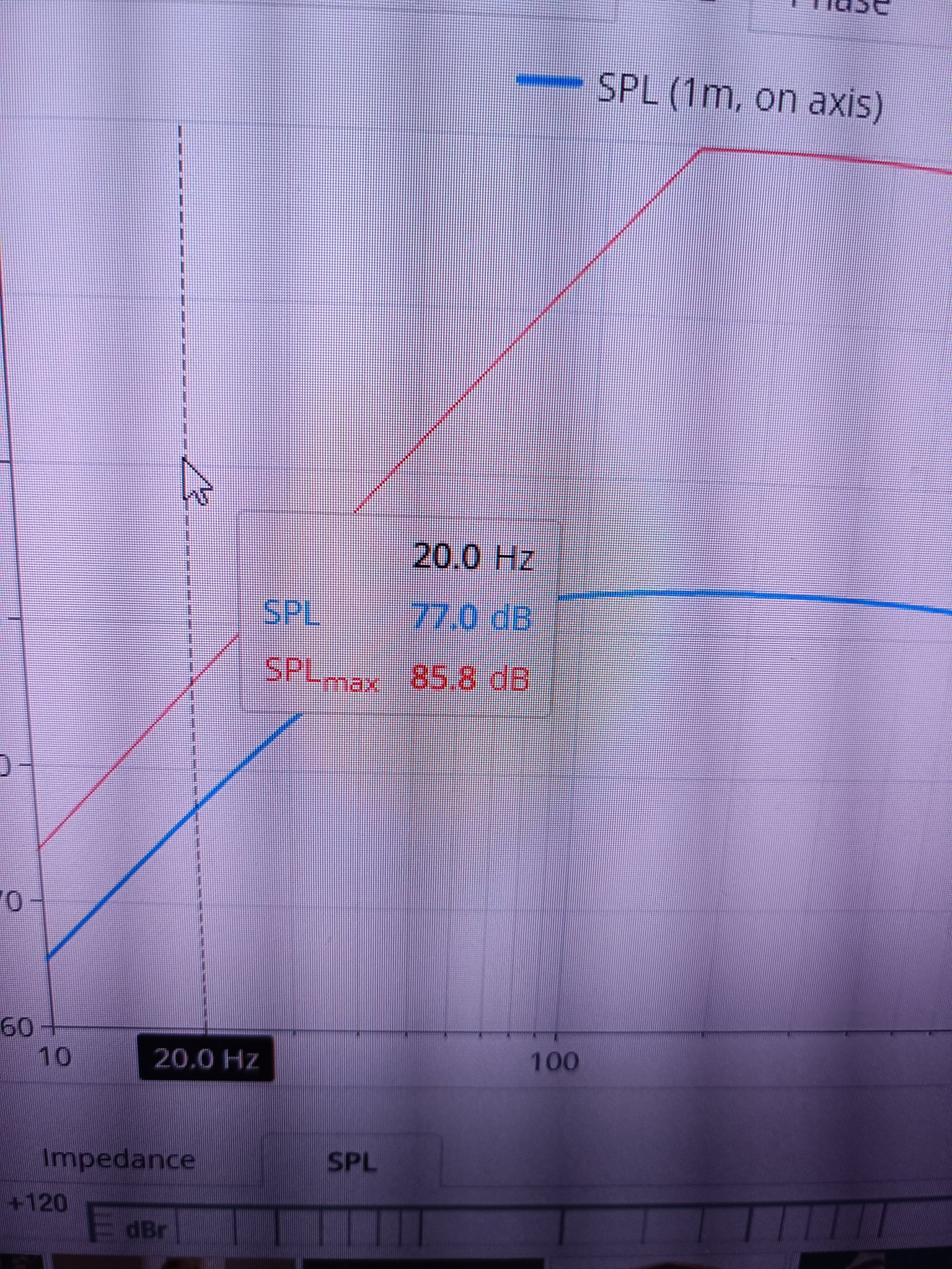

I think I hit a brick wall and am unable "to see the tree in the forest", as we say in German. Maybe one of you can help me out because I'm still pretty new to designing speakers.
Now when WinISD designing this vented enclosure, I already have my "maximum dimensions" for a cabinet measured out, so I know I already have a maximum of 220L to work with. I'd like to use that volume, but don't have to.
When simulating it with WinISD, I enter the driver and vented enclosure and pick "super boom box" to get a nice bump in down low bass, alright. I enter 220L as my volume and play around with a tuning frequency that I can accept.
After having done this, I move on to the bass reflex ports (I want to try 2 horizontal ports, 46cm wide, which is the internal width of the cabinet, and between 5 and 10cm high). I enter this, and it always shows a "1st port tuning frequency" that's at least up in the 400s or 600s....

Is the "1st port resonance frequency" the first next frequency that will resonante in the vent, but it the main tuning frequency is still the cabinet's tuning frequency?
Is the tuning frequency of the cabinet a distinct concept from the vent, or does one automatically define the other? Because it seems no matter how much I play around with the vent sizes (and lengths), I will need ridiculously large vents to get down to 50-100Hz, if I want to stay in the ~220L volume region with a tuning frequency between 45 and 50Hz. (f3 always stays ~37, which I'm quite happy with).
I know bigger isn't always better and so I have played around with a "smaller" cabinet size of around 150L as some calculators suggest, but according to WinISD, the vents still need to be crazy huge, like 2x 46cm pipes that are 2m long. Rectangular vents are equally ridiculous.
Long story short: How distinct are the concepts "tuning frequency" and "1st port resonance"? Given a cabinet with a volume of 220L and a tuning frequency of 45-47Hz and an f3 of 37Hz, is it "bad" if WinISD tells me the ports need to be ridiculously large and long if want a 1st port frequency as low as the tuning frequency?

1. Why did you go for 8"? The drivers are 12", IIRC. Or was that just an approximation of the vent-surface?
1. I explained why I used 8" dia. here:
Anyway, inputted 220 L and the max flat's 8" dia (324.29 cm^2) vent for very low vent mach due to ~30 W peak power Xmax limit x 2.68"/6.8 cm long does indeed create a 'boombox', which combined with the room's acoustics, DSP can presumably make it perform well, though even at 100 W/2x Xmax, vent mach is still only ~18 m/s, nor does it sim any vent harmonics since the vent is so short, intrinsically well damped.
2. Is there a big reason why people usually favor a very low F3 like ~30 but for that they sacrifice a "stronger" 50-100Hz range? Is it just personal preference or is there anything more important behind it? Because if there is, I will keep tinkering with it to get the hump more "to the left" or lower in the frequency range.
2. Seems like I already explained this elsewhere, but no time to search, so.........the room modes, speaker locations can boost the speaker's low end IF it's tuned low enough to couple with them, i.e. room provides some/all of the baffle step loss (BSC) BW.

BB4 aligment table gives 155 liter box tuned to 50Hz, F3=40,3Hz and +4,5dB of bass boost.
I dont see any point for bigger box, but slightly lower tuning of 45Hz is good idea. It lowers F3 to around 37Hz with more gentle rolloff and with bass boost around +3,5dB.
Iam not using WinISD so I cant give you any tutorial. Iam using Boxsim which has really nice vent calculator inside.
For 155liter box and 45Hz tuning I recommend you round vent 14cm diameter and 2,5cm long. So, all you have to do is make the front board 2,5cm thick and cut a 14cm hole in it.
Just make sure its at least one diameter away from box walls, to avoid boundary effect on tuning.

With 155L (and a tuning frequency of 45Hz) 45Hz has +2dB, highest is 60Hz at +3.5dB and f3 is at 36,5Hz.
With 220-230L (and a tuning frequency of 45Hz), 45Hz sits at 4.4dB, 50Hz even at +5dB, and f3 is still 36Hz. That is pretty much +2.5dB down low across the board. Hmm.
edit: WinISD might help compare it. Thick green line is 230L, thin green line is 155L. Same tuning frequency.
Question to the pro's out here: How much impact does +2.5dB down low have? I've heard 3dB makes a noticeable difference, but does this change down low? Might there be a noticeable difference or is it just "voodoo"? I'd hate to go for a smaller cabinet and miss out on the +2.5dB. However if it can be built smaller without losing much, why not.

Concerning the vent... Would it be stupid to go with a 19cm diameter (~7.5 inches)? WinISD says the length should then be 12.5cm, (~5 inches).
(Box volume will be 158L with 45Hz tuning frequency)
I could also go with a 15 or 16cm diameter for the vent (5.9 and 6.3" respectively), but.... why not go crazy?
Is there a tipping point where there's "too much vent area"? Port velocity will be low either way with 3m/s for the 19cm diameter, and 4.2-4.7m/s for the 15 or 16cm one.
