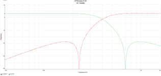

Looking at the provided response curves, the Neville Thiele Crossover (NTC) topology provides greater attenuation than an LR2 filter in the decade below the crossover frequency.Has anyone had any experience with the Neville Thiele Crossover, which has notched responses?...His approach can yield a steeper transition than a 4th-order L-R crossover while using the same number of components, at least in the passive versions.
In addition, the attenuation rate is better than that achieved by 3rd-order Butterworth (BUT3) low-pass and high-pass filters below and above the crossover frequency, certainly for two octaves or so.
If attenuation of driver cone displacement is of concern, then the response offered by the NTC topology is likely to provide adequate attenuation, with the added benefit of a very narrow acoustic crossover interaction region.

For me, the appropriate comparison with LR filters is where both NT and LR have the same order....4th order no doubt being the most common.

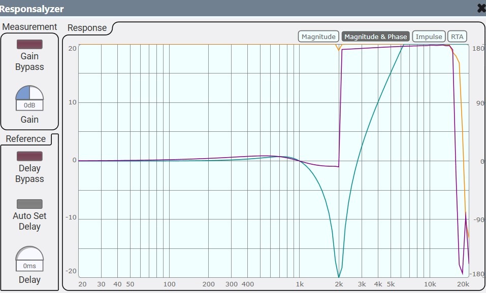

I got tired or trying to closely eyeball the magnitude differences between a NT 4th and an LR 4th, on the charts in the thread,
so put both filters into a DSP and ran a transfer function between the two.
So for any interested in an easy compare....
LR4 @ 1000Hz is the reference channel. NT4@ 1000Hz is the measurement channel.
High-pass, then low pass.

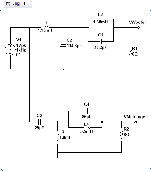

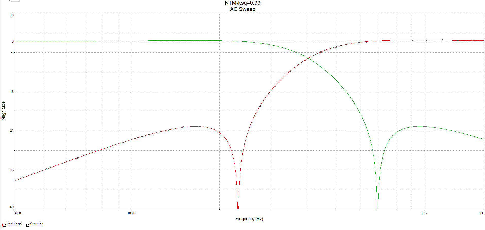

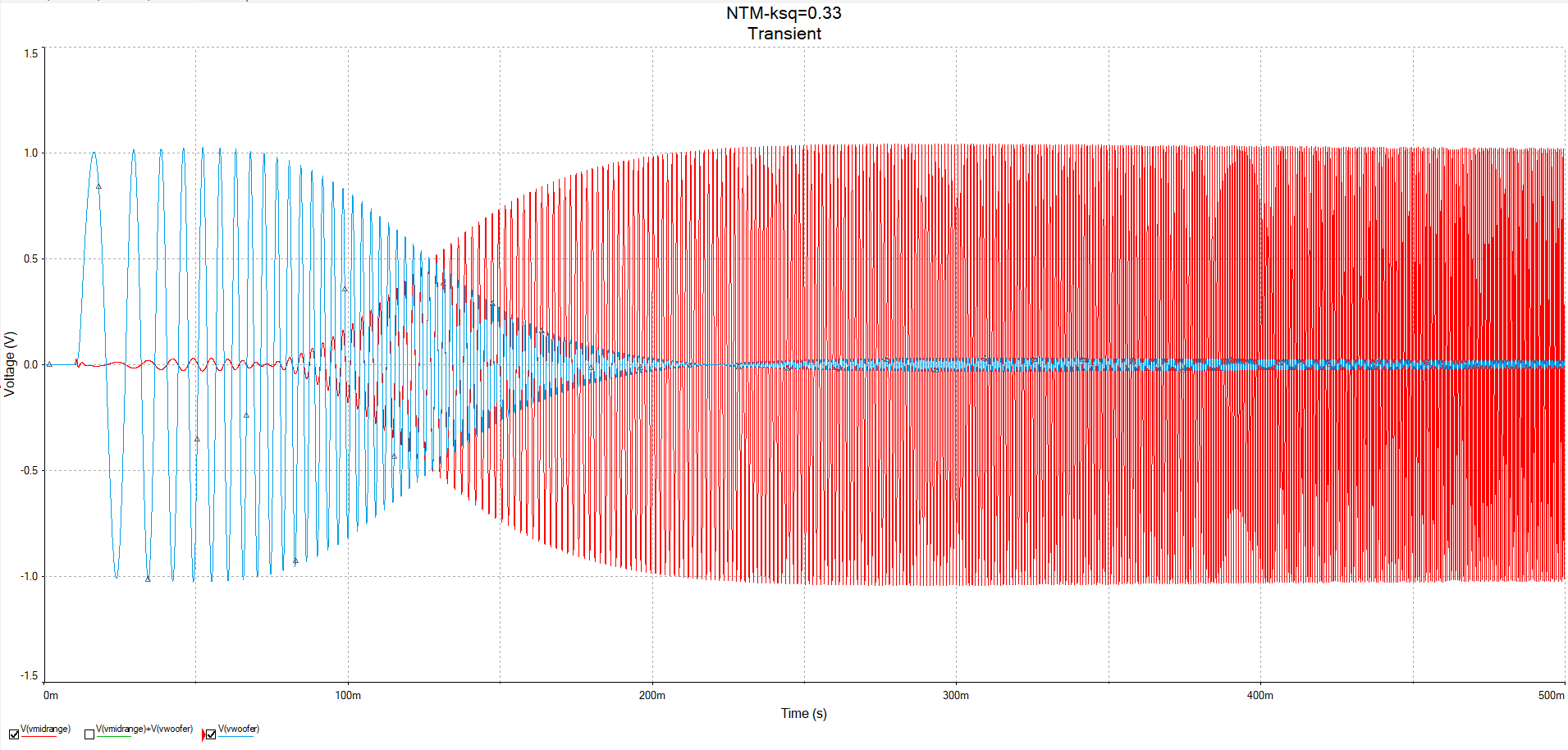

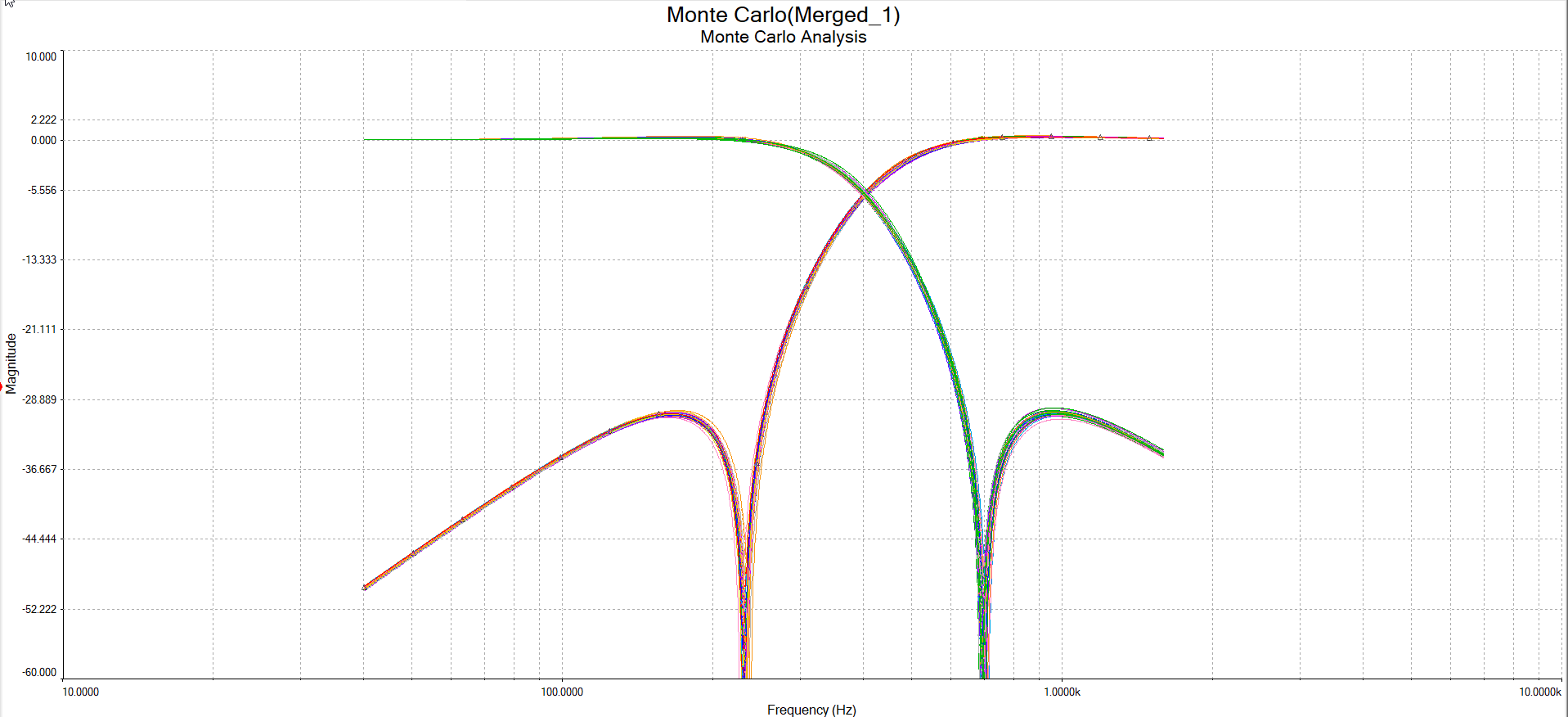

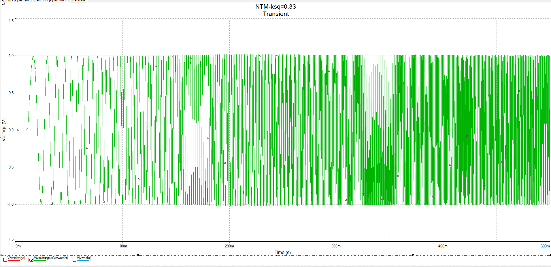

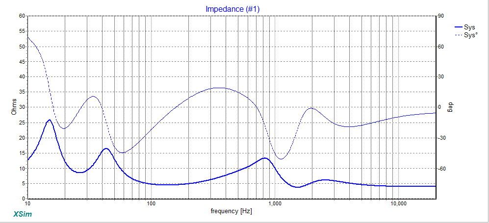

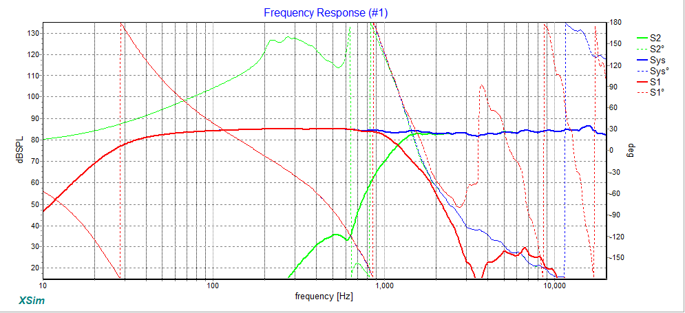

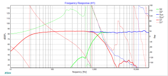

I did a few simulations to get an idea of how this crossover might work. It is idealized; the loads are simply resistors, and the inductors are "ideal." It will give an idea of the design's plausibility, but it does not take into account all of the real-world issues. It is just a starting point for a first look. The design was for a crossover frequency of 400 HZ, and ksq was set to 0.33.
There are some attached thumbnails below.
The first is the basic schematic, followed by a basic frequency response. Next a time domain simulation of both outputs, followed by a time domain simulation of the sum of the two outputs. Finally, I did a Monte Carlo with the tolerance on all caps at 5%, and inductors at 3%, which is consistent with the parts available commercially. The design seems plausible, and the summation of waveforms is essentially perfect. The Monte Carlo seems reasonable at first glance. I am in the process of starting to build a coil winder, so I expect that I could reduce the tolerance on the inductors considerably.
Of course, now the devil is in the details, especially taming the woofer's impedance. The real bad news is that a quick shopping cart at a popular vendor shows a total of over $700 just for the parts, no boards or connectors! This may well be why the more elaborate passive crossovers fell from favor.
From an economic standpoint, I could do much better with active filters and small amplifiers.

Thanks for sharing the results of your design. Seeing the notches showing up so clearly helps confirm the design approach, as does the nicely flat summed response.I'm normally using LspCAD (or VituixCAD) but still down with the lurgy so not on my main machine & XSim axial is all I've got to hand. Sorry for the graph scale, it's just to show the notches -they'd be off-screen otherwise.
