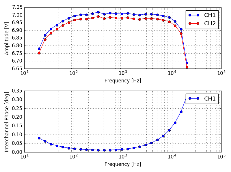

Happy new year to you all 😉 Today I did some just-for-fun amplifier-testing with my Kenwood KAF-1010 Hifi Amplifier which I rescued from being dumped.
The multitone testing procedure proved to be very useful for fast frequency response measurements. Very efficient. Overall, the analyzer seems to be reasonably accurate.
With the distortion an noise measurements I am not really sure how to "read" the figures, since intermodulation-effects have to be considered. I'll have to give the maths a second look too.
Further I had some troubles with analyzer input overload, altough math tells me that levels should be far away from the max capability of the input. I guess this was the result of the high crest-factor of the multitone signal in combination with the inductive behaviour of my 8Ohms load resistor. With a single-tone signal I was able to achieve much higher voltage levels without triggering the input-overload-detection.
I'd love to check out the stepped-sine testing. Then the "high precision mode" is available. I wish my coding/scripting skills would be fluent enough to solve this in a couple of hrs but I have the feeling its going to take much longer.
BTW I had a look at the Generator output with the QA401 and received a THD figure of -94dB at -10dBV output/input level. Not too bad for a 16bit DAC.
Ok, here we are.. a first rough stepped sine sweep, which i scripted today. This is the behaviour of the Kenwood Amplifier with 8Ohms load. Phase Info is probably crap and maybe inversed -> its more a proof of concept than a real measurement.
Got some troubles with the THD+N aquisition mode, it wont initialize. I'm pretty sure the command-syntax and the environment is correct. I'll contact NTI anyways, because i think my firmware is out-dated. Maybe I get some help there.
Besides, I did some single-bin (aka a single-tone mutlitone-signal 😉 ) testing. In internal loopback, I receive a calculated THD+N figure of -85.79dB/0.0051% (13.97dBV@299Hz@600Ohms). This is quite close to the -86dB specified by NTI.
