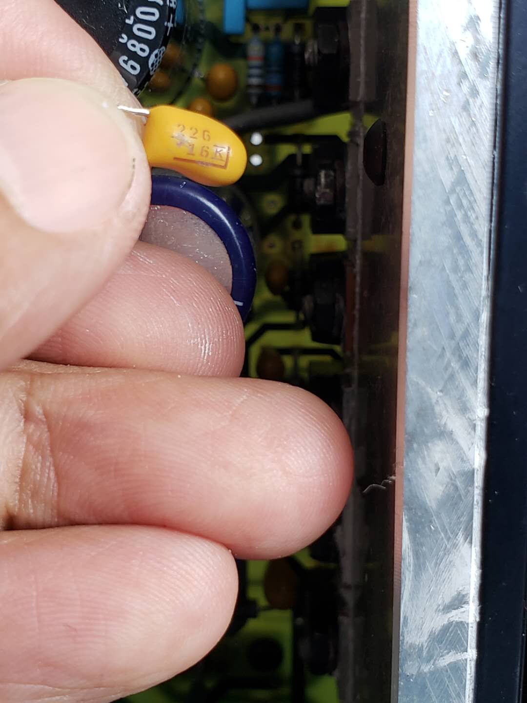

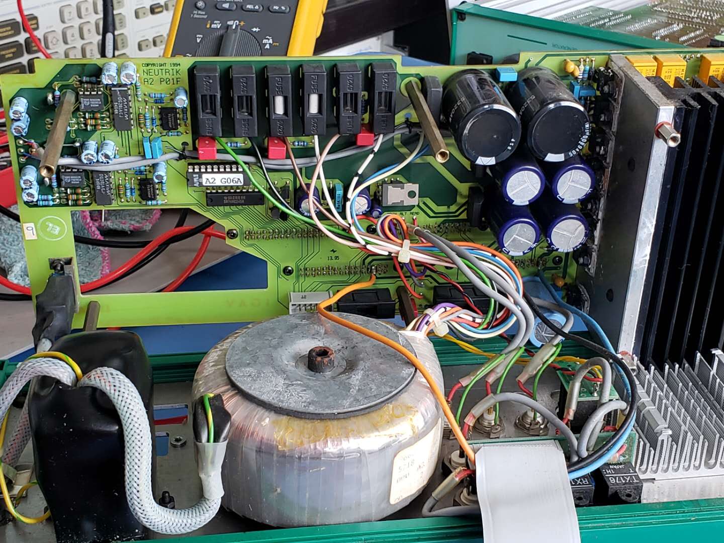

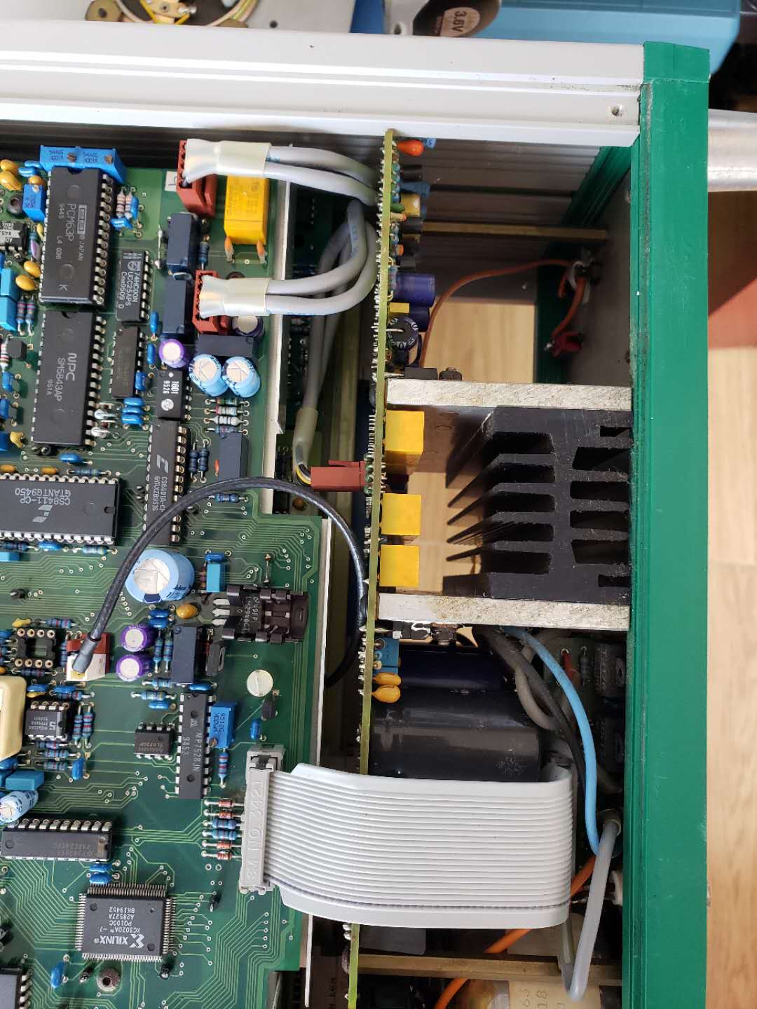

I have Neutrik A1 and A2, but now A1 is with my friend. A2 is broken. After I repaired it, it should work normally now. One of the faults is that the power supply has no power output. The reason is that a tantalum capacitor is broken and it is short-circuited. Hope it helps you.
