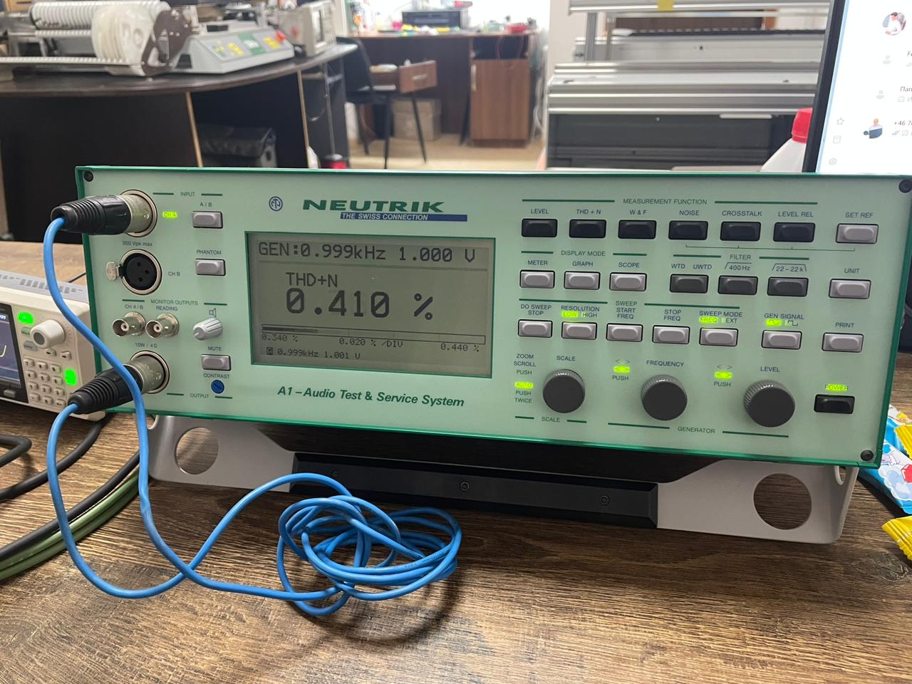

Hi all. I have the following internal measurement result. What could be the problem? If anyone has a service manual A1, A2, please send it to me by email crazynetwork.km@gmail.com Thank you very much!
