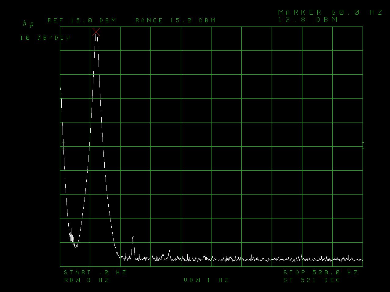

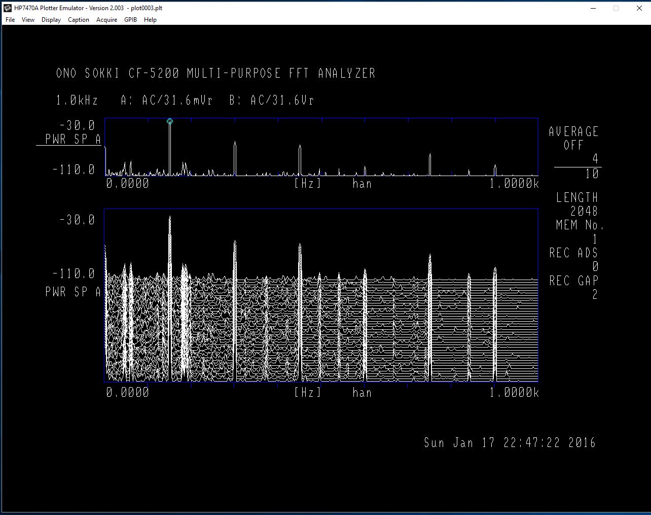

I have Prologix USB adapter and NI USB to GPIB adapter. My experience is that Prologix is limited and if you would like to use your instruments with any other software but 7470 Plotter emulator, you will have a problem. I purchased Prologix first and could not do much with it. Once I got NI USB to GPIB adapter all problems were gone.
In addition to 7470 Plotter emulator you could also use Intuilink software from HP. It supports older instruments such as 3577 and 3585. I had no problems using ether of those instruments and pulling screen grabs.
Likewise, when I wanted to control my LeCroy scope with their software, Prologix did not work. With NI no problems at all. So it might be little bit more expensive but it certainly is worthed if you would like to save yourself a frustration.
Here are few screen grabs from 3577, 3585 and Ono Sokki FFT analyzer done with 7470A plotter emulator.
