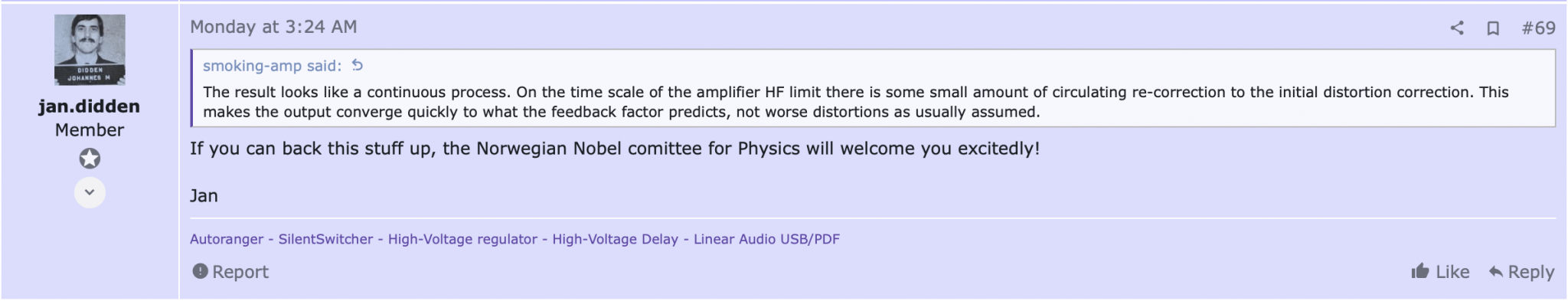

Continued academic focus on reality may be the best news I heard all week.I have a couple of young colleagues who certainly aren't afraid of equations
Norvegian Nobel committee? 🤔 Everybody knows that the Nobel prize is awarded to the best scientists by the Finnish king.If you can back this stuff up, the Norwegian Nobel comittee for Physics will welcome you excitedly!
If the rest of this thread has the same relation to reality, then...
Likewise approaching the problem mathematically with a physically impossible simplifying assumption; a perfect error amp with ideal feedback cancellation. If that was achievable feedback wouldn't be necessary.Simulations are fine if the underlying model and algorithms are understood, but can lead us down dark paths if the model's simplifications and assumptions aren't understood. "
My thinking with Spice is much simpler. An ideal differential gain block summed with a AC voltage source operating at twice the frequency of the gain block's input, the latter multiplied by some arbitrary negative scalar representing percent thd. An ideal amp with a single harmonic. Two fundamental and fully understood ideal elements to see the what before diving into the why.
That's remarkable, given that the Fins don't have a king ... ;-)Norvegian Nobel committee? 🤔 Everybody knows that the Nobel prize is awarded to the best scientists by the Finnish king.
