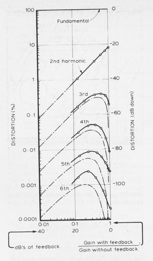

The original question was answered by Jan in post #2. In post #25 I raised the point that Black's 1934 model is an approximation, as explained by Baxandall and more recently Putzeys. MarcelvdG found the even earlier work of Farren and then Feldtkeller (still working on the translation, but Marcel's explanation was better than I could hope to do). This led to the discussion about granular functioning of the recursive amplifier. smoking-amp developed a working model that includes the causal, arrow-of-time, mechanism of the amplifier's integrator calculating (here we include B. Putzeys poetry) the output from its instantaneous voltage and the voltage's first time derivative. Putzeys' analogies of feedback to any predictable function are very trippy, but I'm not smart enough to follow along.Can someone define in formal engineering terms what is actually being proposed here?

Surely you mean the Fourier transform? Not the Laplace transform?
The problem with the differentiation explanation is that not all NFB networks have lead capacitors: yet they all work, other than those that are unstable, which is a stability problem, not an NFB problem.
I would imagine that leaving out the lead capacitor for phase corr. would just cause the error correction to be a tiny bit less accurate on 1st loop pass. For a hypothezed multi-loop Feldtkeller/Farren/Baxandall/Putzeys distortion it would cause the phase accuracy to deteriorate with each pass around the loop. Causing the extended FFBP harmonics to get worse with each higher order. Looking at Baxandall's graph (courtesy of Jan Didden), one does see that occurring in the measured curves. Maybe the cap was off value some or missing?
The lead cap/phase corr. got put in earlier simply to show how the N Fdbk could be correcting the signal time coherently. One of the arguments raised against N Fdbk was that it was correcting error after the fact. It really doesn't have much importance to the Feldtkeller/Farren/Baxandall/Putzeys model or discussion other than the higher order distortions possibly being worse than expected.
Fourier/Laplace? Its been 50 years since I took a course on those methods. I thought Laplace was just using complex numbers compared to reals. Easier boundary conditions. I'm familiar with solving Laplacians for electromagnetic fields, maybe not the same thing for signals.
Feedback doesn't happen "after the fact", because it's wrapped into the integrator (an essential element, for stability, of all feedback amplifiers). For audio amplifiers, the integrator's time constant is very large compared to the arrival times of all of the (significant, not noise-limited) recursive feedbacks plural, and input. Feedback is not a single event, but a series of successive approximations, approaching a very complicated (difficult for us to calculate) result. In B. Putzeys' poetry, the integrator "calculates" the output voltage by successive approximation. It keeps on doing it forever (noise limited) and continuously. I think smoking-amp's conception of the integrator working in an arrow-of-time but directed-by-dV/dt is the most challenging result of the discussion (so far!)

But as that isn't true, the reliance on differentiation is unnecssary, and breaks down in the case where the lead capacitance isn't present.The lead cap/phase corr. got put in earlier simply to show how the N Fdbk could be correcting the signal time coherently. One of the arguments raised against N Fdbk was that it was correcting error after the fact.
Without the cap puts the correction maybe a few nSec or so behind the current incoming signal. Not surprising that works pretty good. You can't hear 1 nSec in audio.
