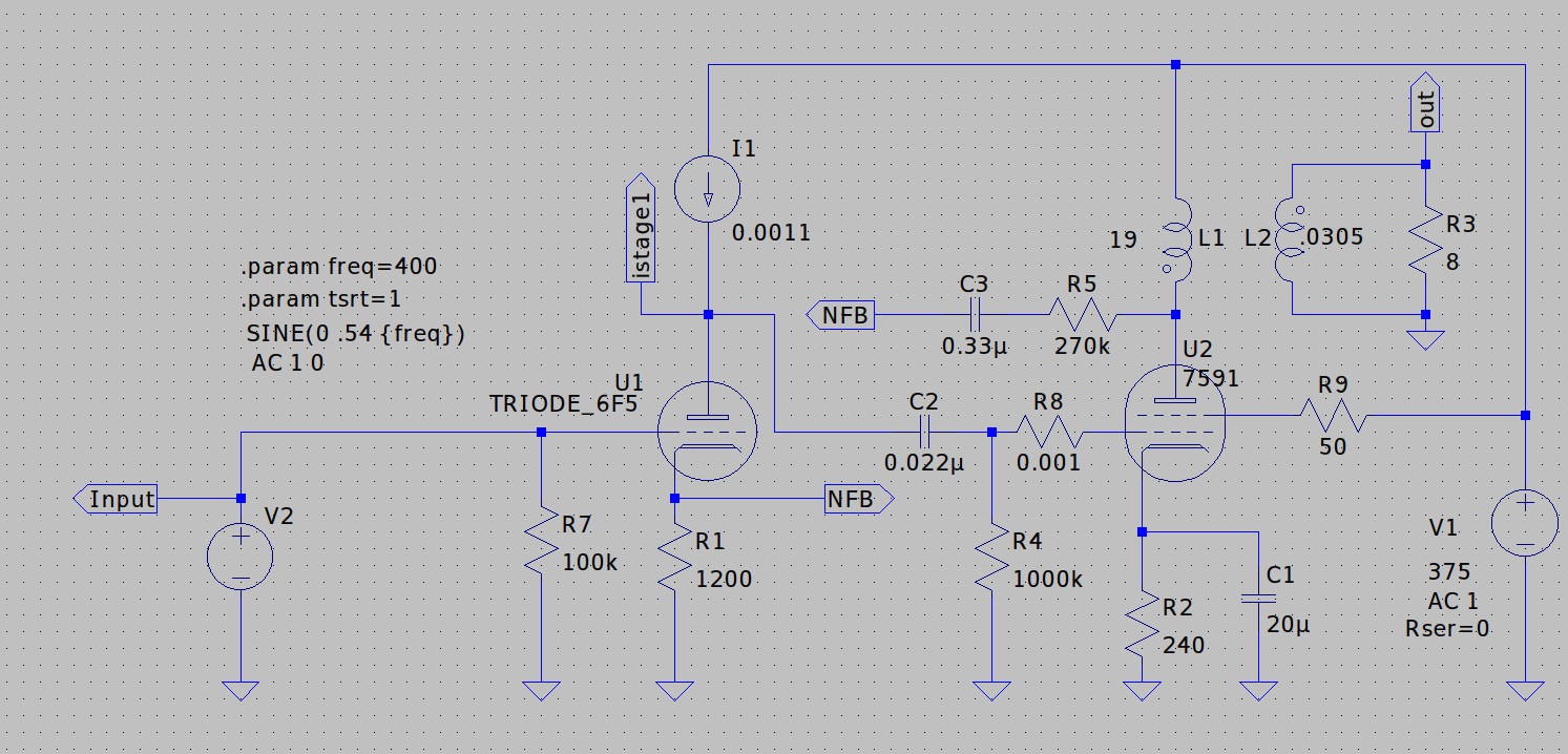

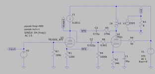

On the bench is a 6SF5/7591 pentode mode SE with slightly over 20 dB of feedback. The initial design employed the traditional RC degeneration from the OPT secondary. The current version uses series RC from output stage plate to input stage cathode, about as 'fast' as realisable with a two stage amp. Distortion wise they measure close save for some variances (from memory) in harmonic numbers over 10 and greater than 90 dB down. The frequency response of the traditional FB was flat past 100 kHz and the internal loop about 0.5 dB down at 20 kHz with a gentle slope afterwards and no peaking. Response is flat at the plate so the fall off apparently represents the secondary's behaviour.
Due for revisit and the amp will be laid out to support either but audibly the PK internal FB version was a 'what am I hearing' experience. Much better than the external loop.
BTW, even with the 6SF5's high plate impedance Schade was a no-go, suppressing the dominant second but accentuating everything above.
Short OT; sure, schematic below. The 6SF5 is a glass envelope equiv to the 6F5 used in this sim. OPT is a 5k.
Depending on dB of desired feedback and input stage biasing/tube type it should be possible to eliminate the series capacitor by factoring in the P-K DC current injection of the feedback resistor and scaling the 6F5's cathode resistance accordingly to maintain constant G-K voltage. However increasing FB by reducing the plate-cathode resistor injects more DC current and forces greater reductions of the input stage cathode resistor, thereby reducing the level of feedback achieved by lowering the P-K resistor in the first place. I tried it, it works but I couldn't achieve the desired overall level of feedback with these tubes. Interestingly I didn't note any obvious audible change on the bench with the cap, maybe because it's in series with 270k?
This FB circuit does 1 watt at about ~ 0.15% dominant second with 3rd around 0.03% and everything higher ~90 dB down min. Pleased enough with the topology that the next SE might attempt an 828.
