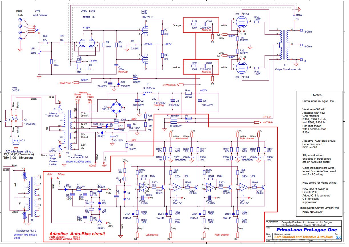

Negative feedback loop in Primaluna One
1. R7 and R8 are different, because there is no high impedance current source in that stage's cathodes (22k cathode resistor causes different gain per side). But just set R7 = R8, and there will be 2nd harmonic in that stage. Unfortunately, that 2nd harmonic will be covered up by the negative feedback which corrects that.
2. Triode wiring the outputs will reduce the output power, but also reduce the amplifier's open loop gain. Then the negative feedback can be removed altogether. Want less 2nd harmonic, leave R7 and R8 unequal as in the original circuit. Want more 2nd harmonic, then set R7 = R8.
3. The 100 Ohm resistors should be connected directly on the tube socket pin 5 of the EL34 tube grids. They do not belong on pin 1 and pin 6 of the 12AU7. Correct that, and the 100 Ohms will be real grid stoppers.
4. Triode mode for the EL34 tube is actually easier on them, than Ultra Linear. Just look at the family of screen current curves for an EL34 in the data sheet. Remember, the EL34 Screen is just fine wire. Beam Power Forming plates are thicker and more massive elements than screen wires.

The reason R16a is only 1k Ohms, is that it has to drive the capacitance of the shielded cable.
If you are going to reduce the negative feedback, just change R16 and the C12 that is across it. For example, double R16, and cut C12 in half.

> Why does R7 and R8 have different values? isn't that supposed to be a LTP?
It is driven single-input and uses low-gain tubes. And the tail is not very "long". It is sure to have unbalance unless those resistors are different. This part might even give good balance.

Just ran a sim for different and equal resistors. About 0.1% distortion advantage when they are different. Still not perfectly balanced but perhaps pointless to optimise for the particular model i use.

> modify this Push Pull design towards SET sound
Short R208. It becomes semi-SE. (If you do this wrong, it will blow-up.)

Shorting R208 will reflect back an extremely low impedance to the bottom 1/2 of the phase splitter. The gain of the top half of the phase splitter will increase, and its distortion will go up.
If you short R208, OK, but then also be sure to open C203 at the grid end.
That will keep the phase splitter distortion relatively constant, and its gain relatively constant.
And, as I said before, put the 100 Ohm resistors where they belong, on the output tubes grids, not the other side of the coupling caps.
Again, the 1k negative feedback resistor is chosen to drive the long shielded cable that drives the 150k negative feedback resistor.
1k and the shielded cable is a low pass filter. At what frequency? Well, what is the capacitance of the shielded cable?

kamilrakyta,
Connecting this amplifier's output transformer's secondary signal to the 12AX7 parallel grids will cause the amp to become an oscillator (it is actually positive feedback when applied to those input grids).
Even if you re-connect the output transformer secondary in reverse phase, then although that will now be correct to apply to the 12AX7 grids, it will lower the input impedance at the input connector.
And with that connection, now you can not apply that same signal to the 12AX7 cathode circuit, it will be positive feedback.
The application of a particular phase of 'negative feedback signal' to a grid is the opposite of applying the same negative feed back signal to the cathode of that same stage.
You are thinking of a different schematic where negative feedback that connects to a grid, of a Long Tailed Phase inverter.
The 2 grids of a LTP phase splitter have opposite phase.
