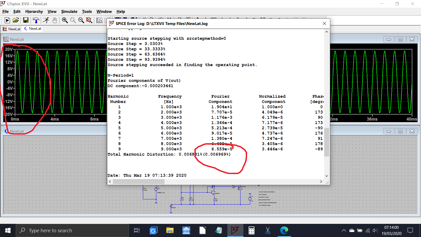

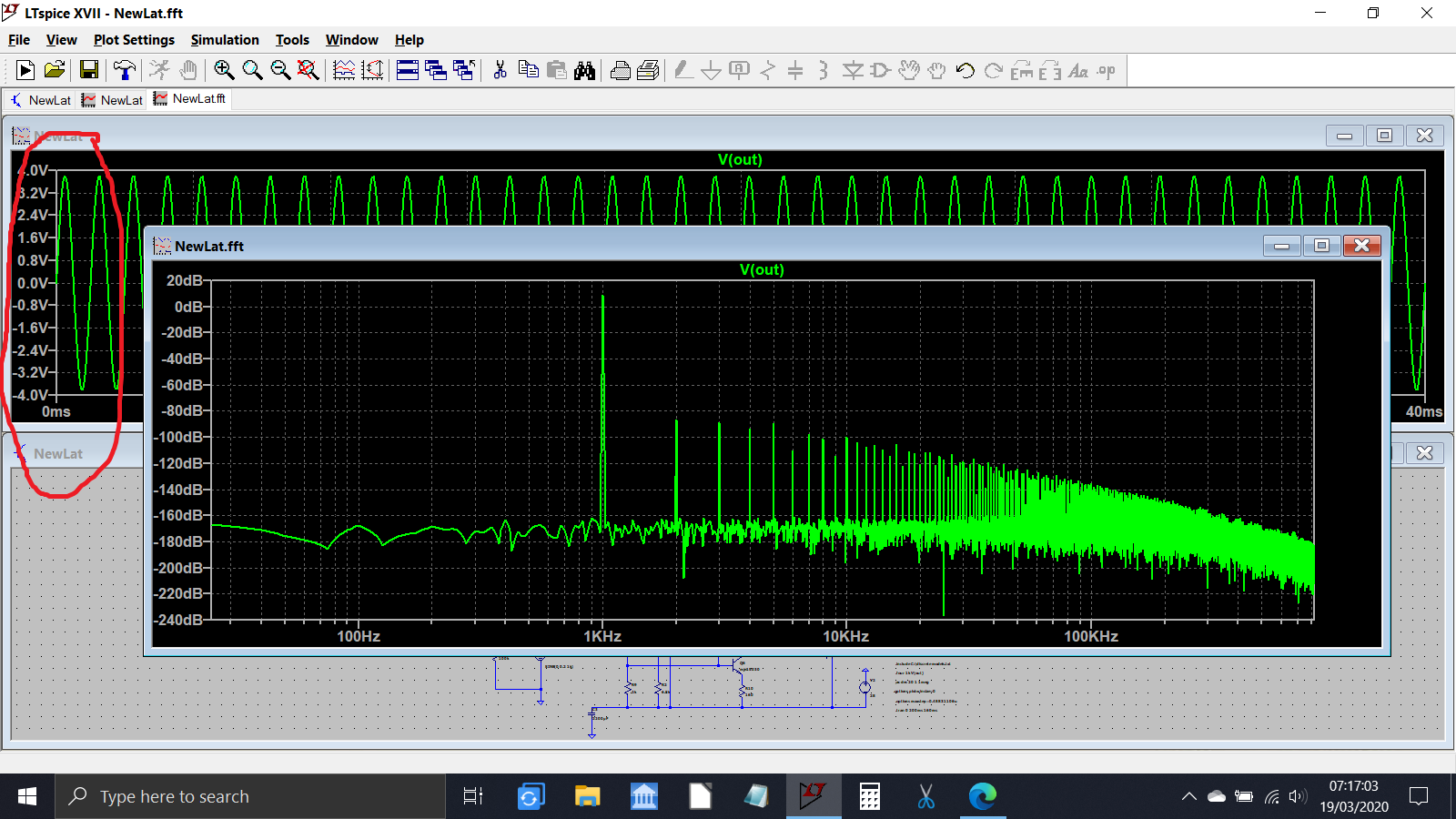

I tried your values (only in LTspice). It is good for low level signal, but for 1V input we have clipping at 9V for upper sine wave for 27V power supply
1V input for 45C power supply = clipping about 20V upper sine wave
Distortion about 0.7% is not impressive
Is there any sense to further improve this VSA circuit
I built a VSSA amp (really good amp) known in the forum but I would like to compare it with a different concept
This is at the point of clipping (20 volts peak) and also at '1W/8ohm'.

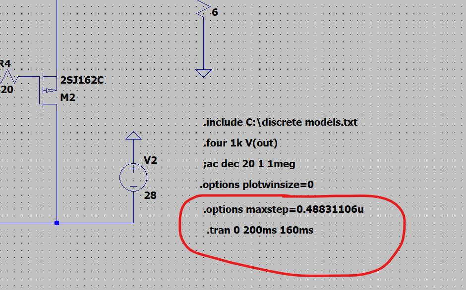

Use your own models and tweak the bias set resistor R15 to give around 100ma current in the FET's. Make sure you set the timestep correctly for the distortion tests and run the sim long enough to get a good result.
