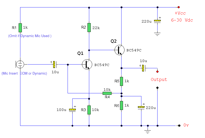

I have seen this microphone amplifier. It uses two stages but It feeds some signal back to the input using a resistor. Is that similar or is it negative feedback?

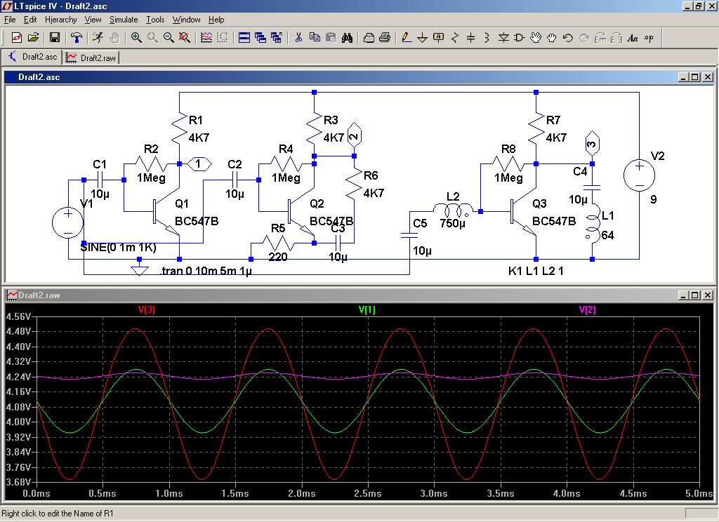

This cannot work with a 3 terminal amplifying device: the current you add to a node is taken elsewhere, and at best, you get a status quo, or like here, a loss: see example 2.
How are you going to prevent a single frequency growing in amplitude and occupying all the transistor gain?
You just have to remain under the critical gain: if G is the amplifier's gain, you have to reinject less than a 1/G fraction of the output to the input.
The closer you are, the higher the gain, with Gtot=infinity if exactly 1/G is reinjected.
In the example, 1 (green) is a plain vanilla amp for reference, 2 (magenta) is DF's method and 3 (red) is the transformer method, implemented in a shunt-series combination.
In this case, the improvement is modest: the original gain is multiplied by ~3, but it is already sufficient to reveal the non-linearities.
