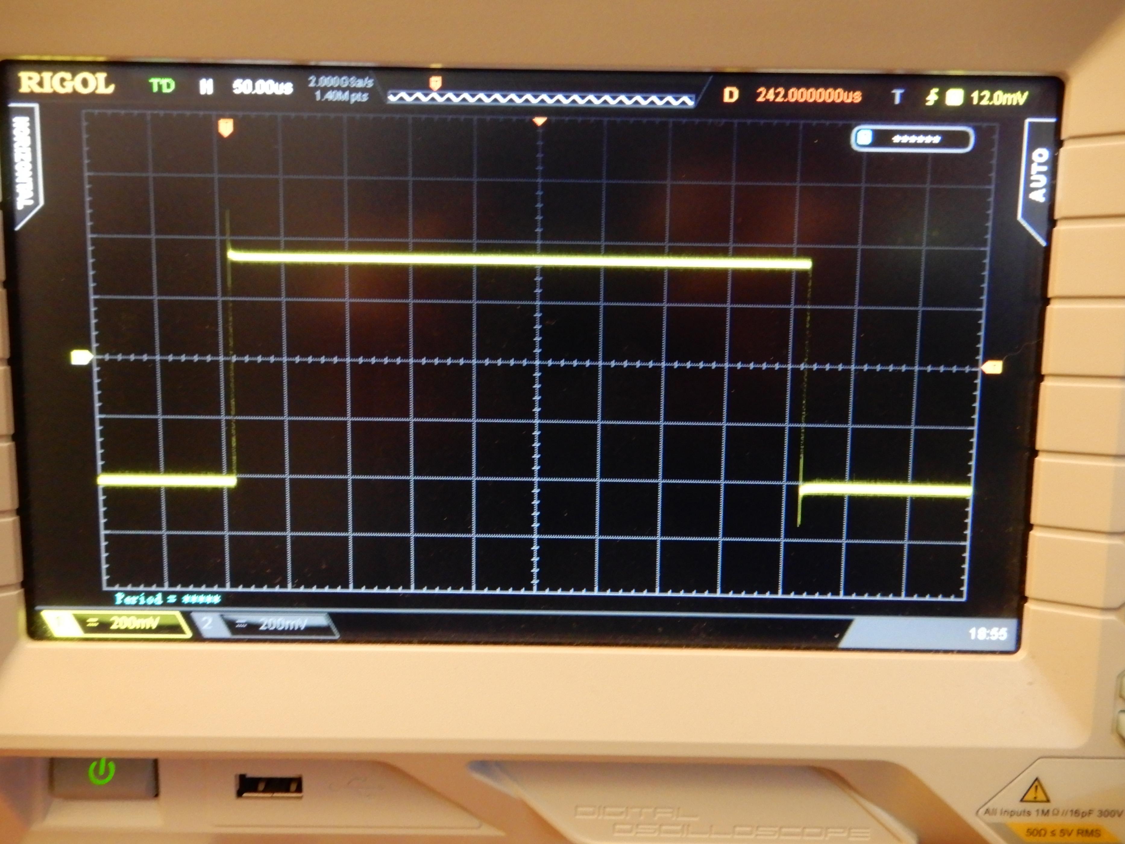

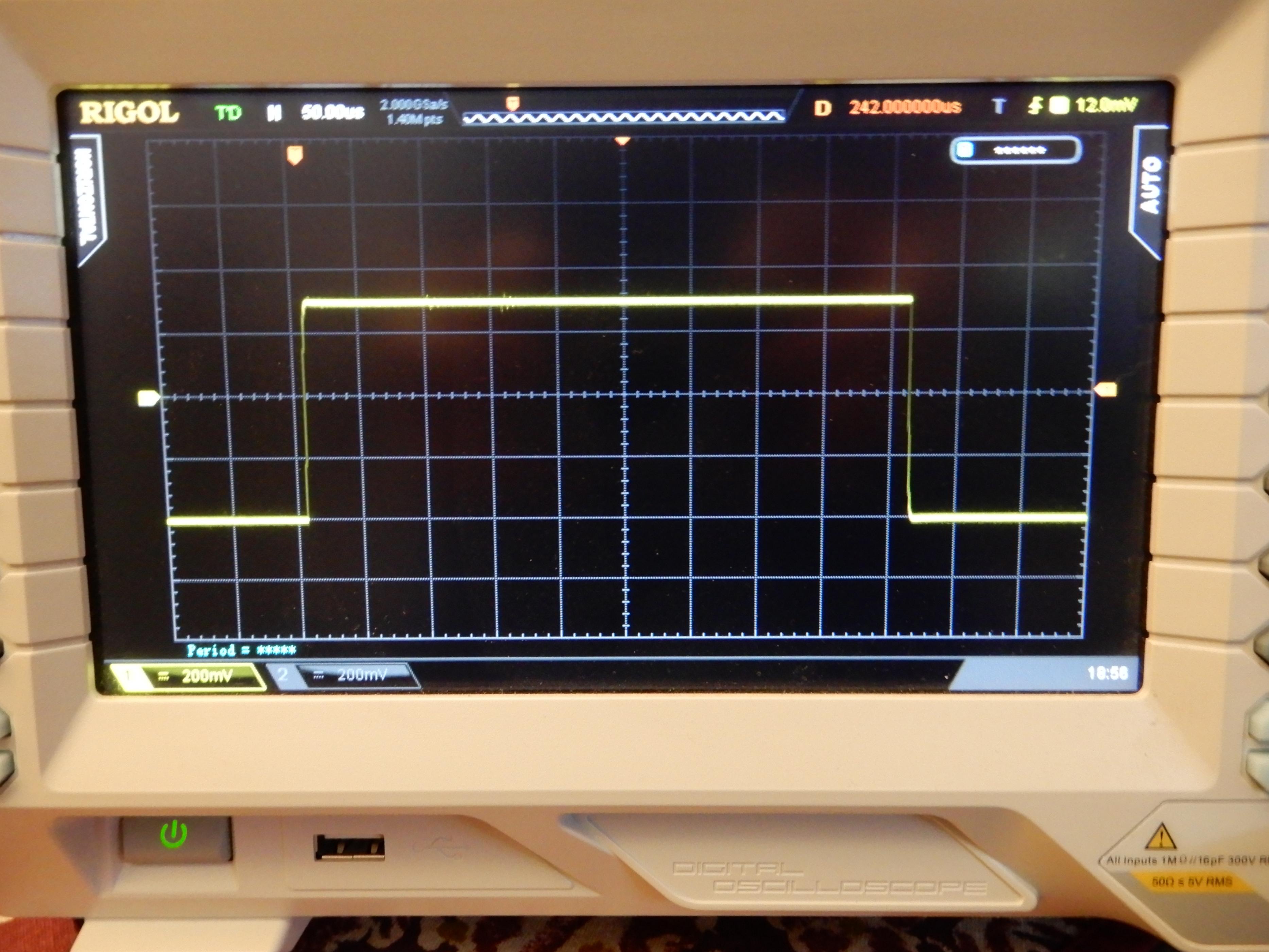

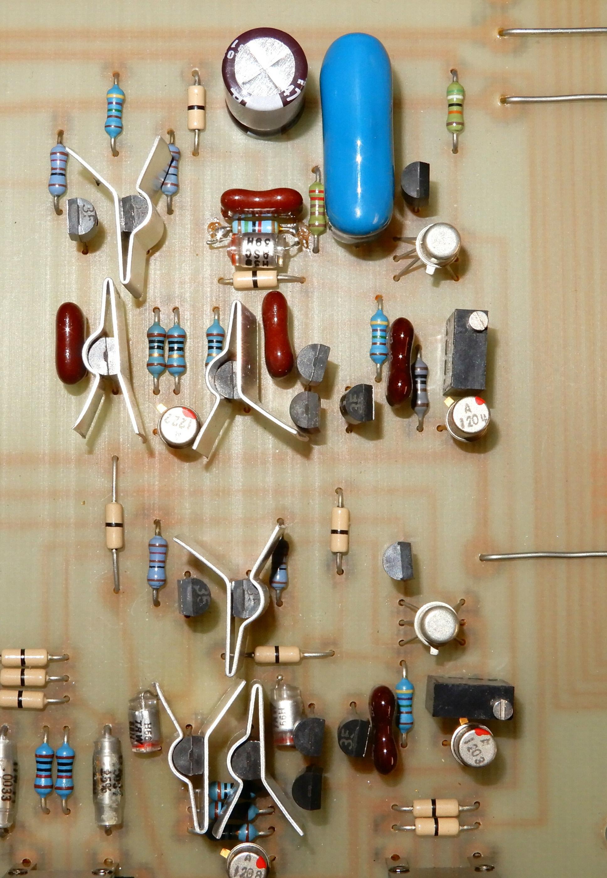

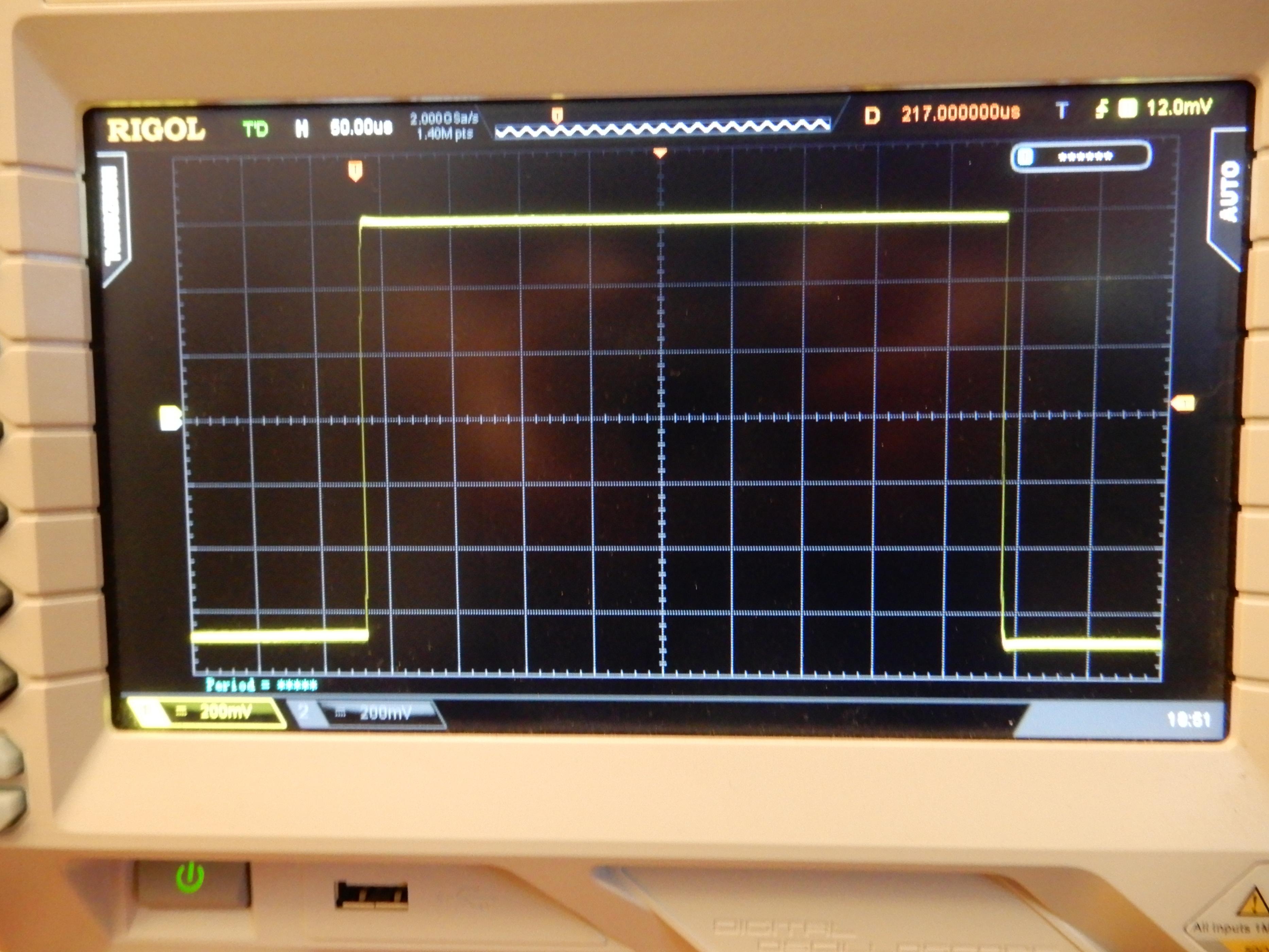

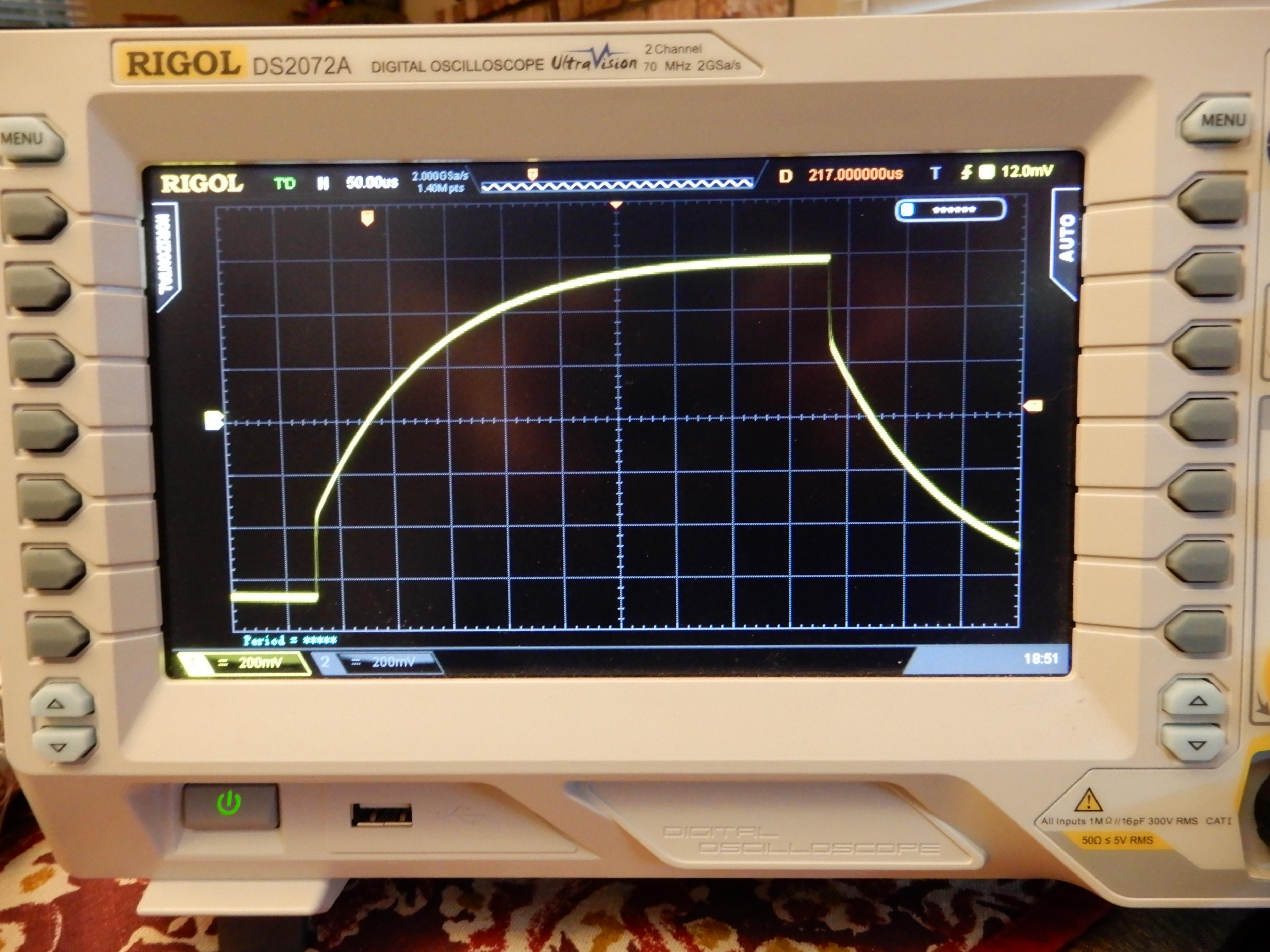

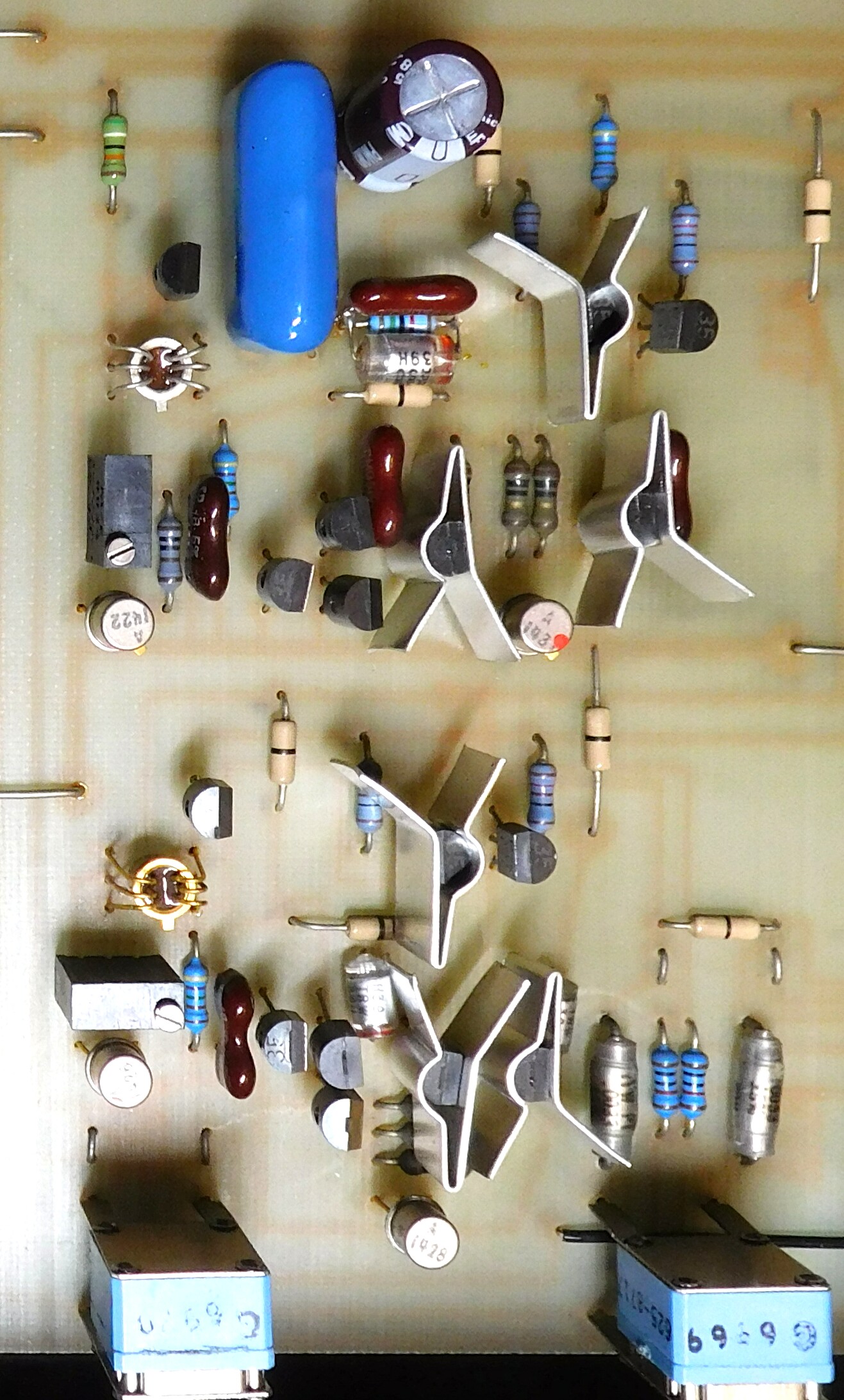

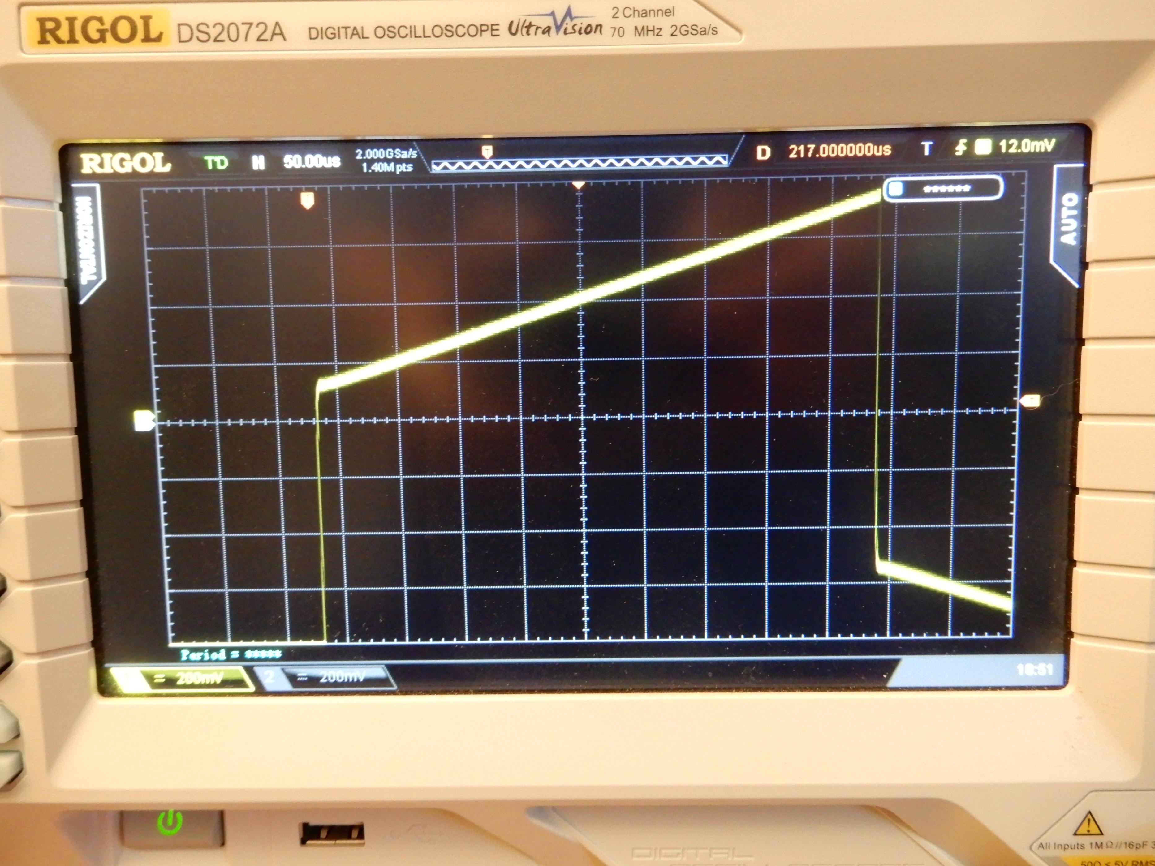

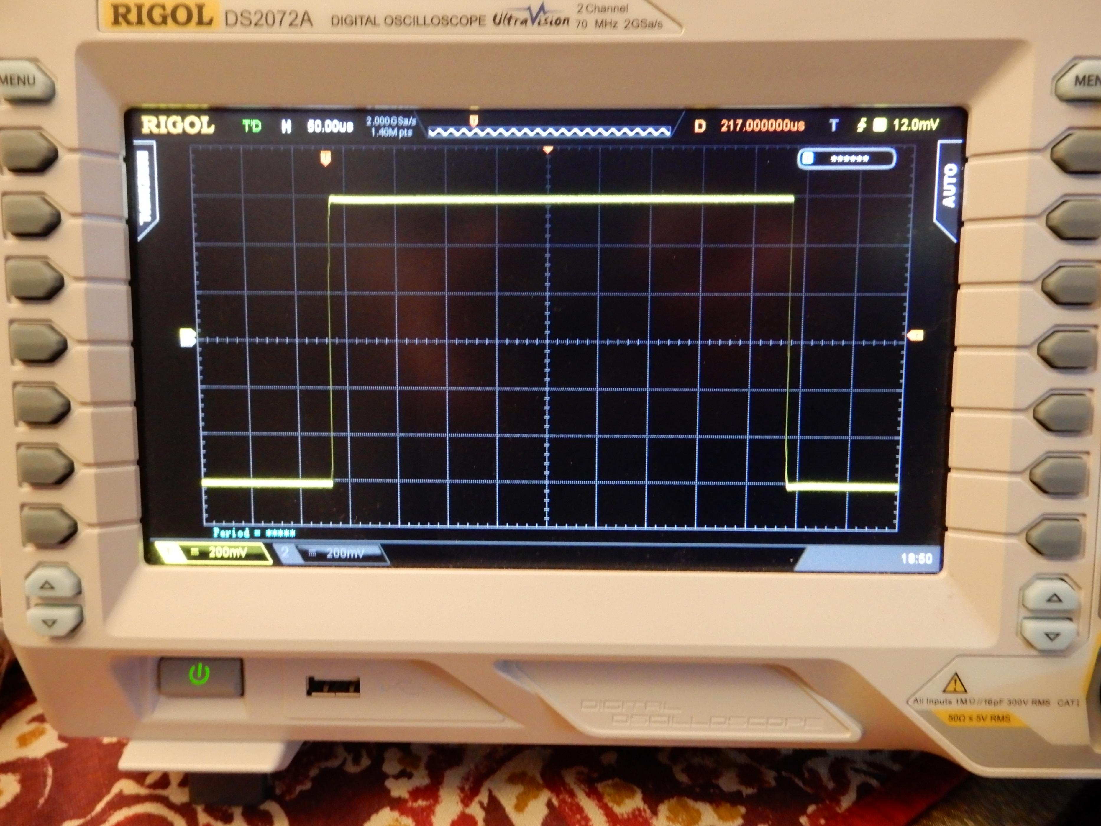

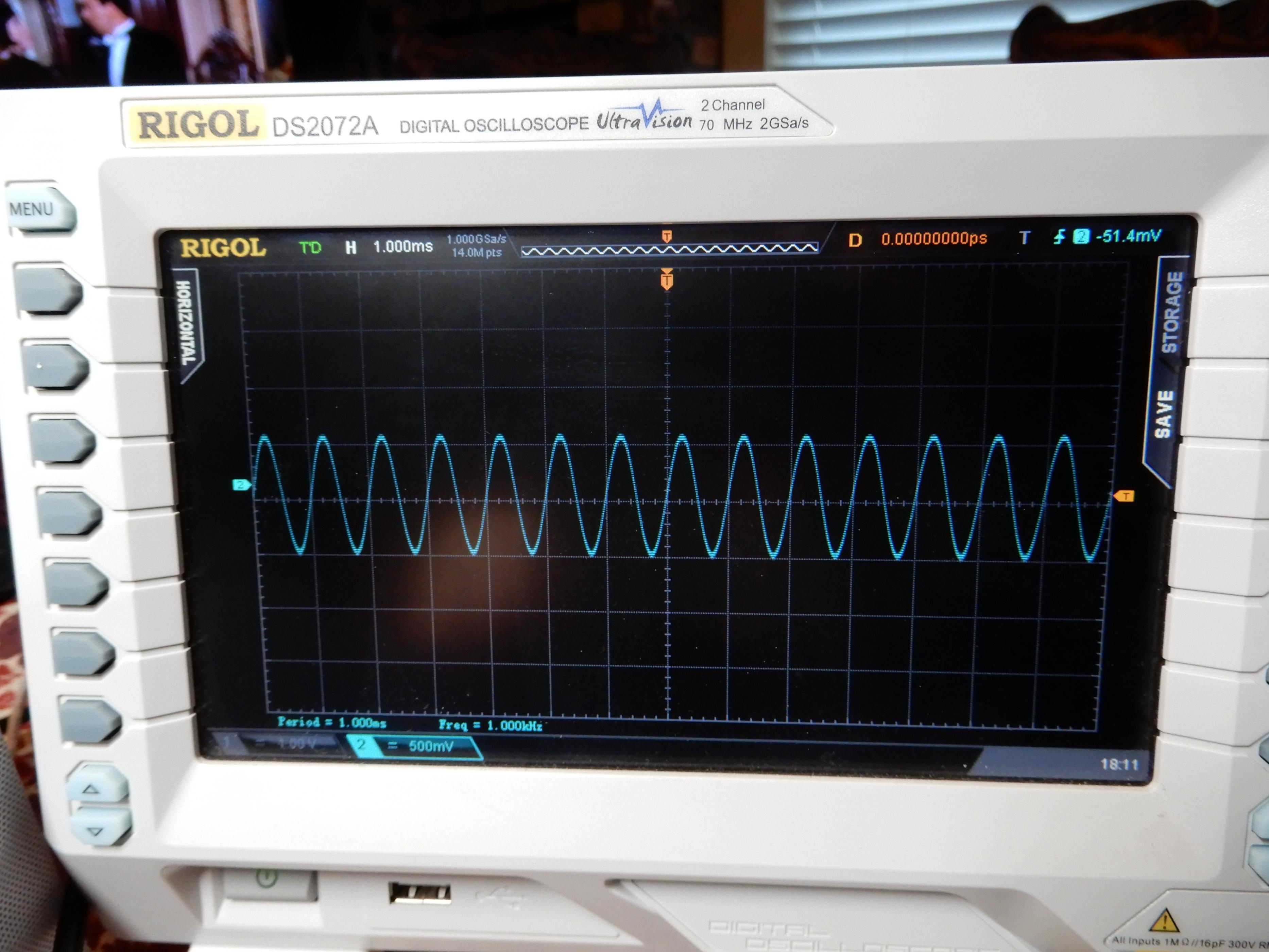

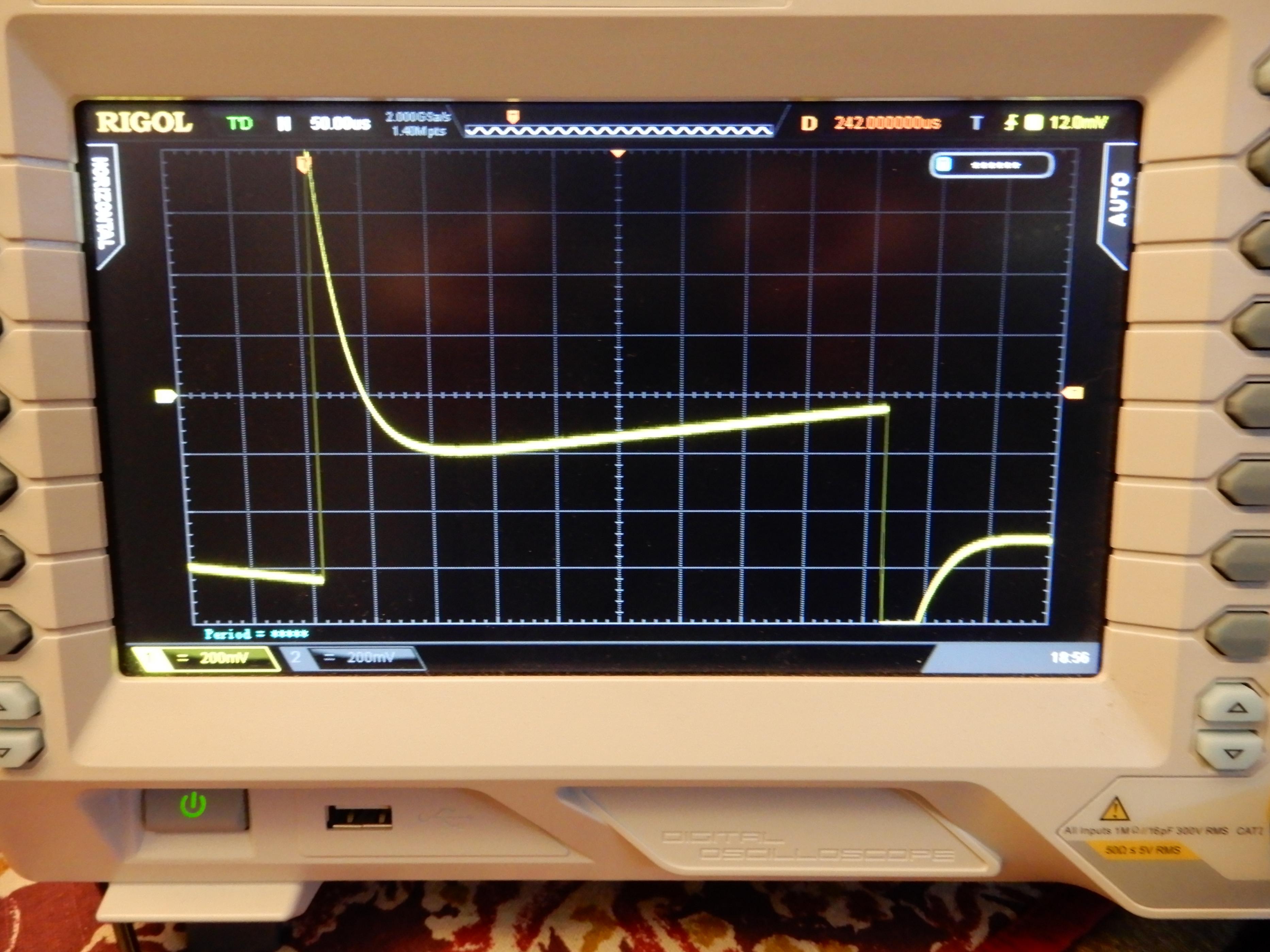

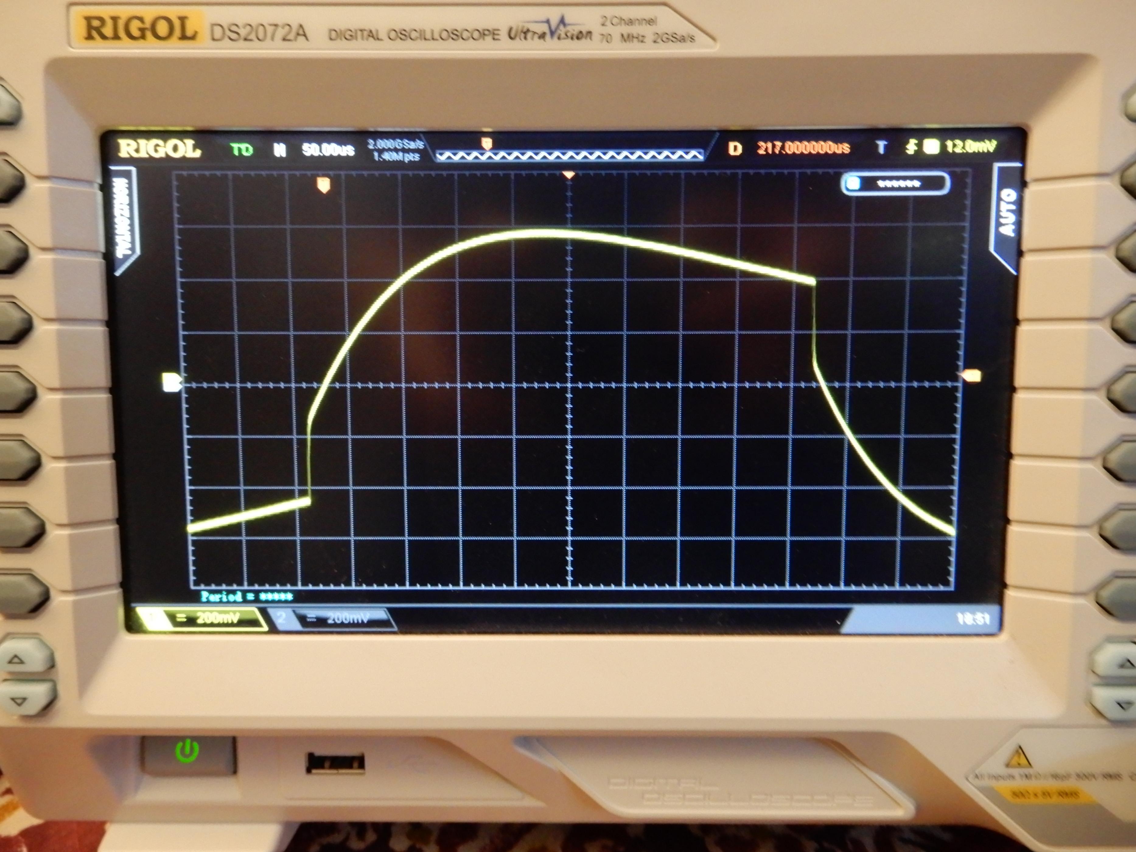

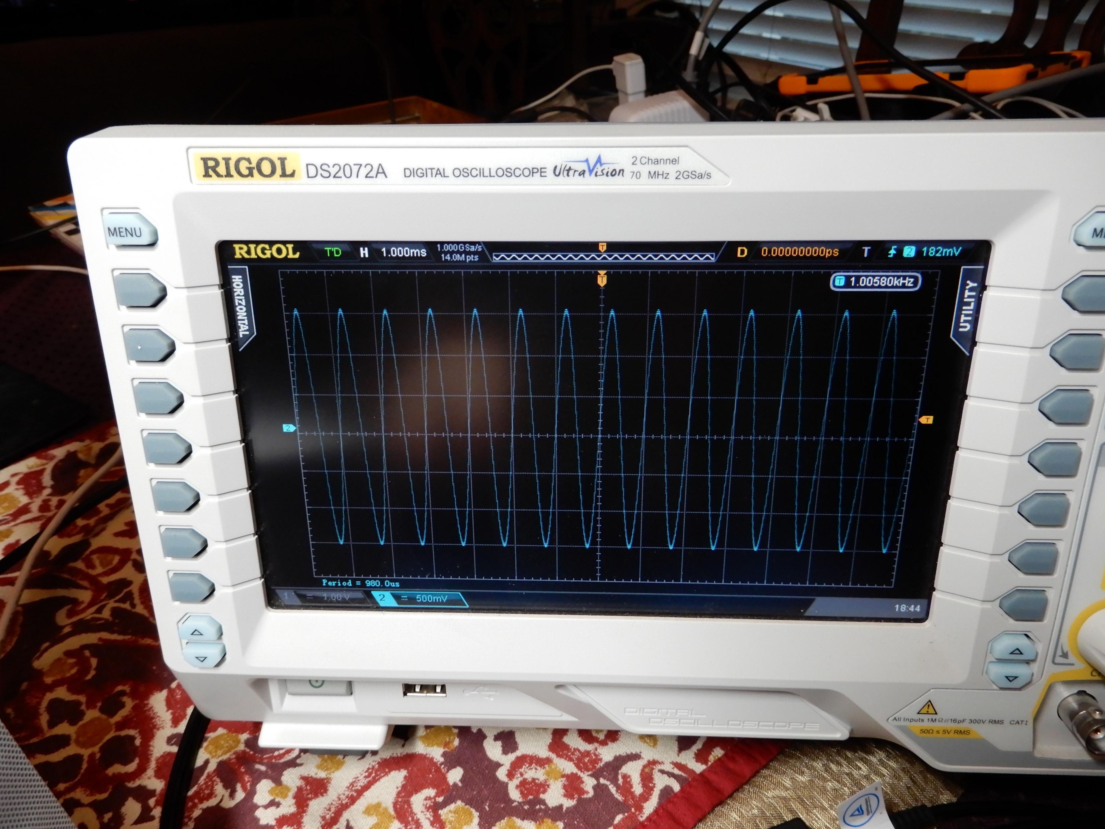

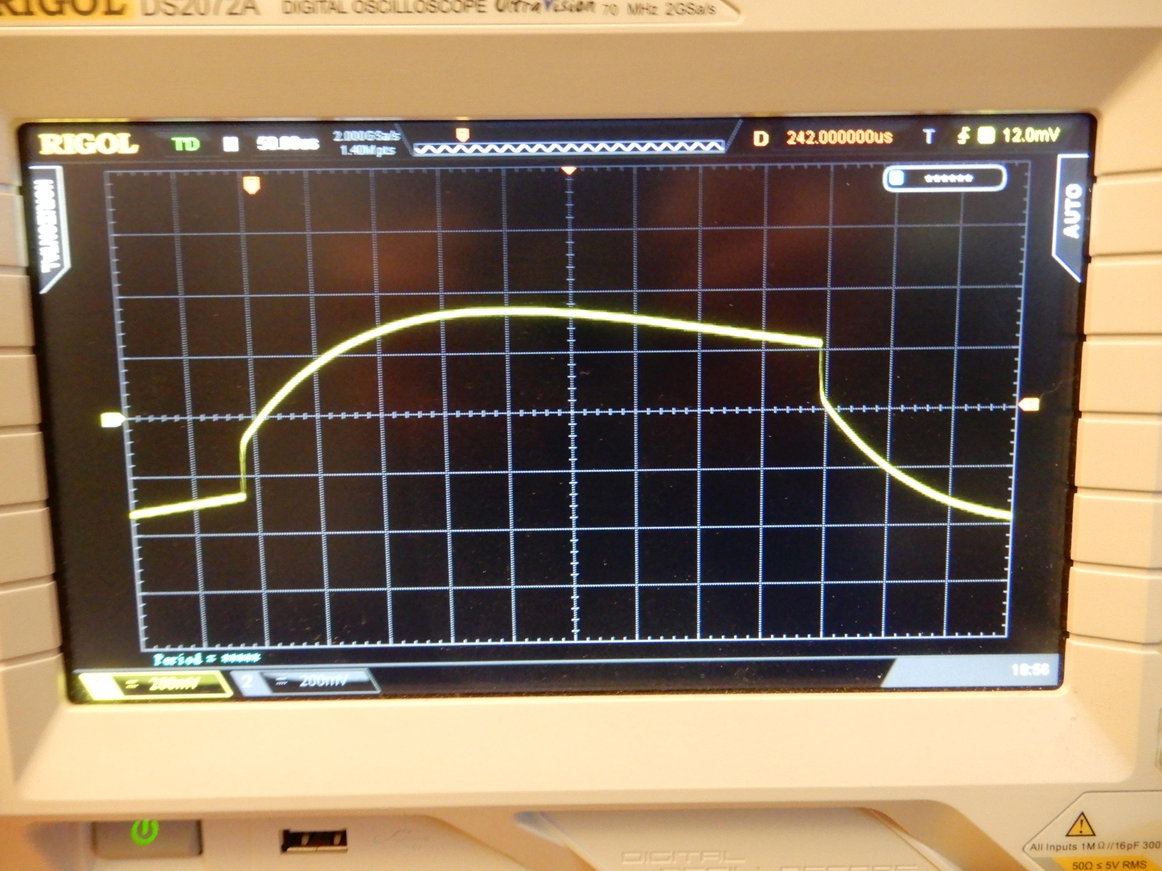

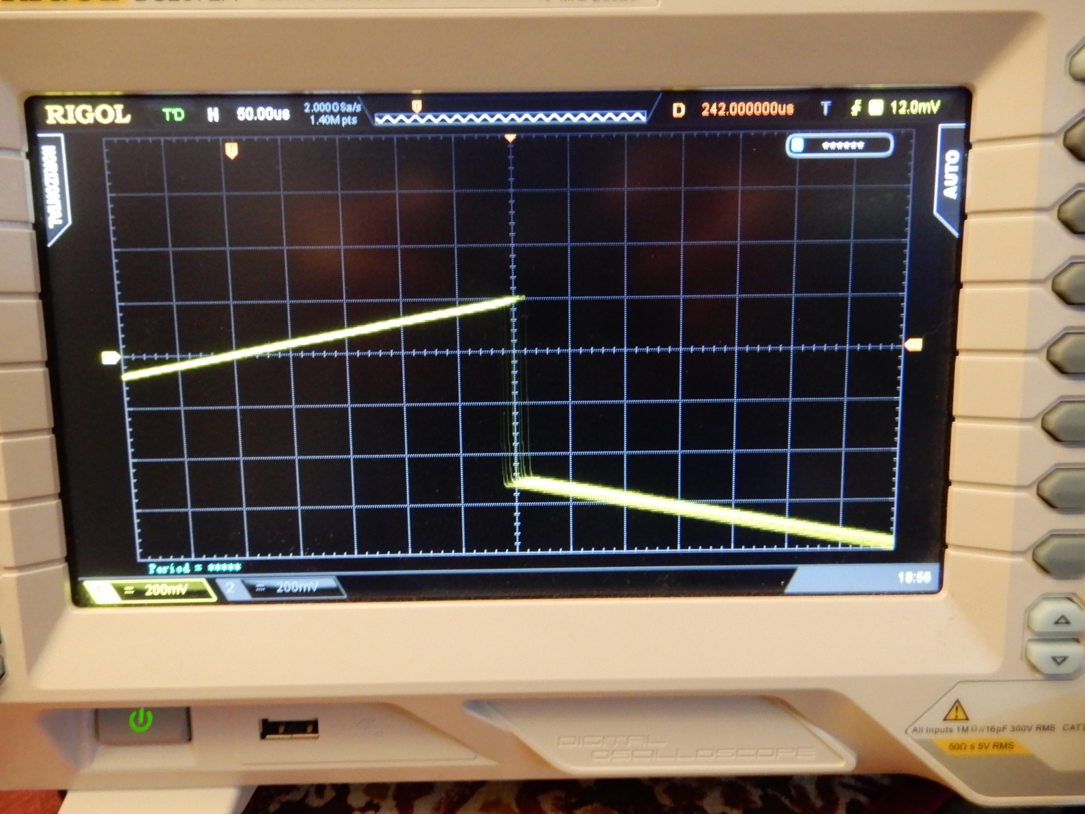

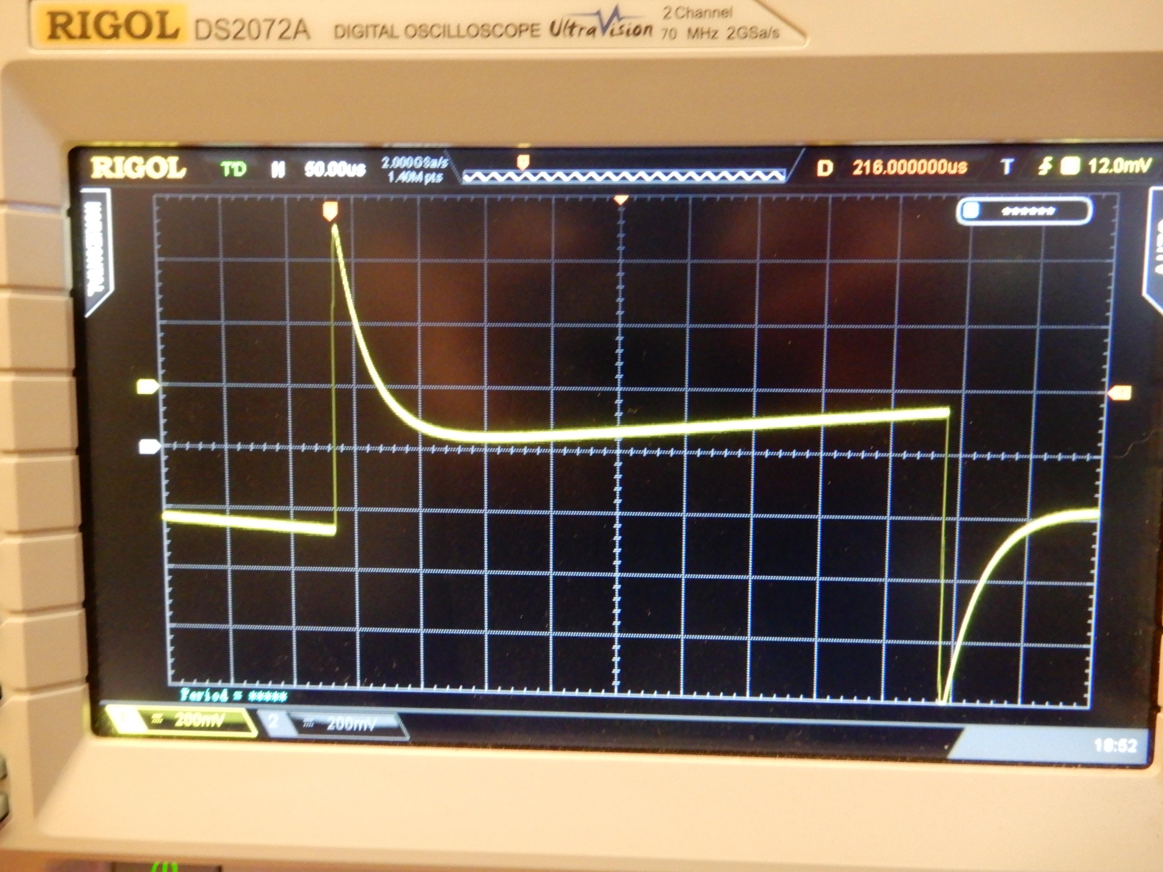

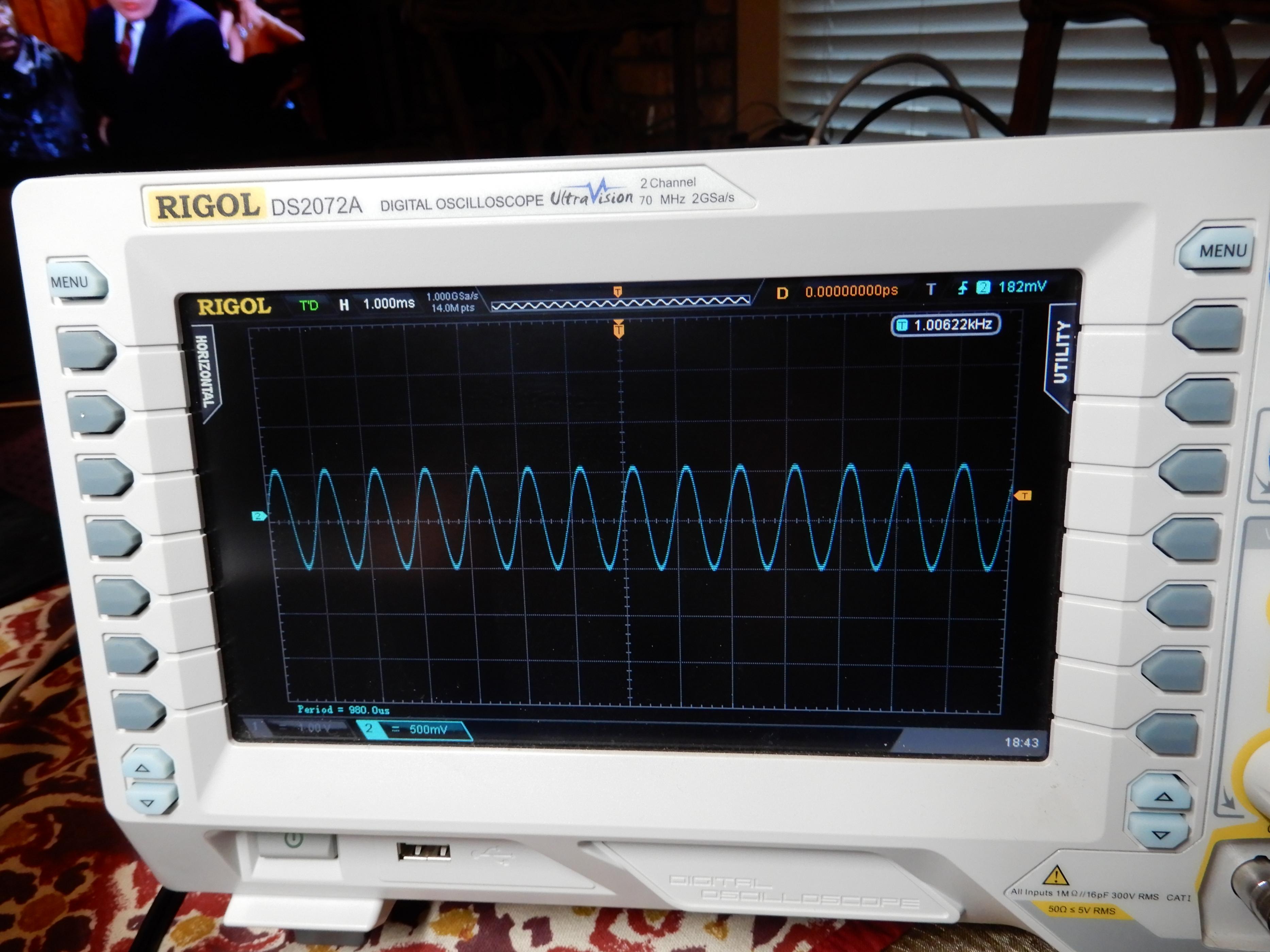

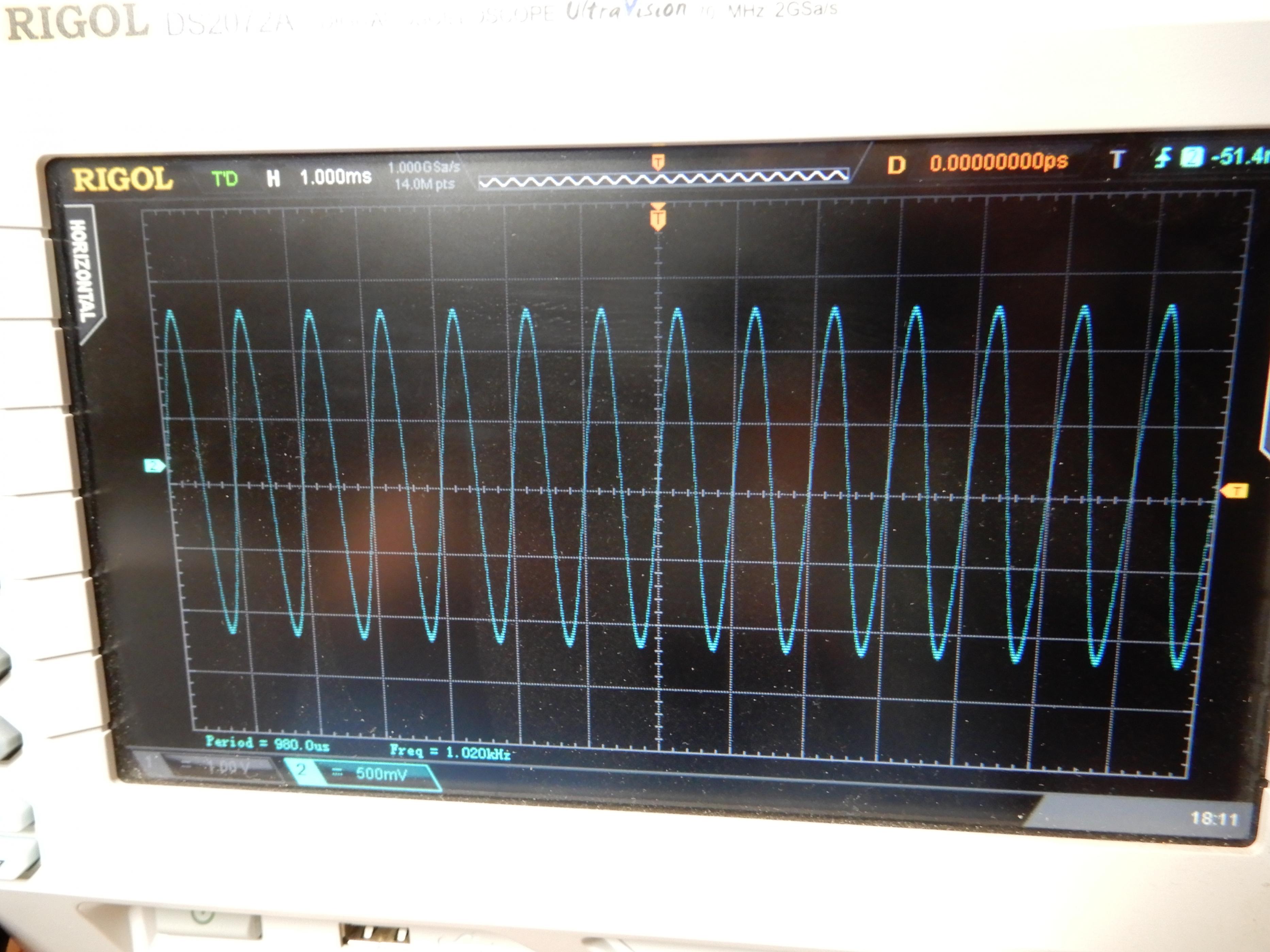

I've finally gotten back to work on the Andante, and have taken measurements of the matched dual transistors as well as the rail voltages and DC offset for each channel - spreadsheet is attached.
I've also added some 'scope pictures of each channel with a sine wave at the input, and with the volume turned up. DC-coupled as advised. Looks good, but the DC offset is huge on the right channel, as measured with my Fluke. I did use the 'scope to look at rough voltages on the matched dual transistors as Chris suggested, but ended up using the Fluke 287 for more accurate readings, and it didn't seem like the meter changed readings at all.
Note that the offset is low with the tone circuit bypassed, and shoots way up with the tone circuit engaged. These readings come up as soon as the unit turns on; there is no other fault event that makes this happen.
I am pretty sure now that the upper section in the photos is the line amplification stage, and the lower section is the tone stage, based on following traces. Readings on the Qs don't change with the status of the tone defeat switch. The only thing I see different from Left to Right channel is the readings on Q1 in the line stage of the Right channel; they are about 0.2V lower than those on the Left.
What other measurements should I take to help figure this out?
Thank you!
Thank you!

The figures are about the only thing we can say anything about because your measurements on the fets themselves don't have any context (we need a schematic for that). Readings to the ground do not really mean anything until we know how they relate (need a schematic for that).
OK, I took those because earlier you wanted to see gate-source voltages, but I understand about the lack of context, for sure. I really do wish I could come up with a schematic, but I think the chances are slim to none.

As seen from your pictures this is a dual mono preamp with completely independent
channels in mirror image board fashion.
Both tone and line stage are set up as discrete operational amplifiers with dual
n-channel j-fet input, the differential stage having a current regulator diode in the
common source line and current mirrors as drain loads. The rest of the circuit may
be similar to what you know from j-fet input style power amps and j-fet integrated
op-amp internal circuitry. In other words we have to deal with four "channel diff pair"s
here not only one in the right channel as suggested before.
Tone stage and line stage have a similar layout, but on the tone stage the 470μF 16V
electrolytic cap responsible for unity gain at dc is missing. I am not sure why. This may
be due to the feedback mode of the tone controls and is an explanation why offset rises
with bass full on. With a cap in the same position here the bass control operation may
be impaired.
From your screen pictures and your voltage readings it is obvious that the amp is not
defective - although (some of the) Vgs voltages are suspicious and look too high.
I suggest checking the 470μF caps for leakage now.
If this does not help I suggest a careful realignment. The trimmers are in fact for offset
zero. If you are sure that the two caps are fine try a sensible adjustment here, for each
of the four amp stages and checking their respective outputs for dc in millivolts range.
No wild rotation allowed here.
Yes, I said before do not touch the trimmers, but now I had a look at the board layout.
Your pictures however are not sufficient in resolution, viewing angle etc. to completely
see the schematic without drawing it.
I addition square wave pictures for about 1 kHz should be taken and please adjust the
time base of your scope in a way that only one or two wave lengths are shown, it is
useless and repetitive otherwise. This is easily done at a generator frequency of 1.1 kHz.

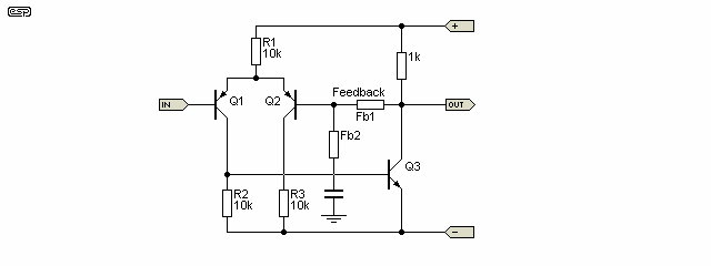

I suggest to take care of the dc offset first.
I did not write about a coupling cap in the usual sense but one connected like this:
see attached picture (note that I will not take responsibility for assumptions this
schematic being generally applicable to the Audire preamp).
The four "building blocks" are dc coupled.
We have no component failure here (except maybe for said elcaps). Have a look
at the board and the measurements and you will probably agree.
My proposals in post 27 are still valid and the sequence is clear.

Wave forms each channel
OK, here are the wave forms. Left channel are in this post, right channel will follow. They may have uploaded out of order. The captions indicate position of tone defeat switch (Tone_Off), and Bass and Treble positions (e.g. B_Full_T_Half).
Volume on the preamplifier was a little higher for the left channel readings, but were reduced for the right channel readings to show the entire wave form for full bass and treble, which I also adjusted for the left channel.
They look pretty much identical to me. The effect of the tone controls appears fairly substantial, which was how they sounded for the brief period I could operate the preamp before it caused my amps to shut down.
Are there any other readings I should take next, Obi Wan(s)?
Right channel.
Images are not in correct order, but hovering the pointer over the thumbnail shows the file name, so right and left channel pics can be compared.
Thank you,
Greg
Thank you,
Greg
Hi Greg,
Yes, that pretty much confirms what I was thinking just by looking at your DC offset figures.The right channel diff pairs need replacing. The left channel might be better with the 6 mV pair in the main amplifier, but that's being real picky. Something you can try after the rest is working properly.
-Chris
-Chris
