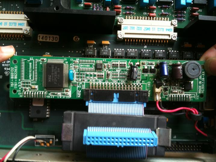

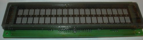

May be I did not describe my problem clearly. Actually, that is a display on my DAC. It look like attached files. I want to get Vacuum Fluorescent Display separately or with controller circuit included.
Please help.

One of the references that comes up when I search on that part number is the documentation for LCDproc. It reveals that other VFD displays used the same interface chip (NEC FIPC8367), so maybe some of those would substitute. I found an FM20X2KB on ebay, but not cheap. Or program an Arduino to emulate that interface and drive a currently available display (LCD, LED, OLED). The documentation for the interface chip must be out there somewhere.

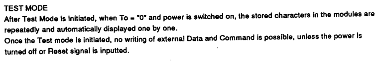

Does somebody know how to put this VFD in self testing mode ?
Yes!! Are you still looking for it?
I have that exact panel and, while I couldn't find an exactly matching data sheet, I found the ones for the NEC
FC20X1SA and FC40X2EA and they do apply for your panel as well. I'll upload them if I'm able (this is a brand new account, created specifically to answer you, @vadimgal.
Here's the pertinent section:
and that "T0" is pin #25 on the 34-pin ribbon connector.
