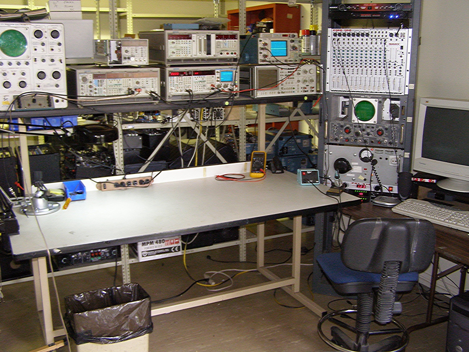

I'm about to embark on a PCB layout, but would like a second opinion on
the circuit to see if I need more 'feature creep'.
I have all this Tektronix 5000 series test gear and they all support
GPIB control to automate their behavior. The missing link is a
switchbox to change routing programmatic-ally to allow tests that need
external routing changes.
Some of those tests would be:
My Tek MI5010 is loaded with three 50M30 DIO cards and can drive up to
48 relays directly, so I don't have an issue if I need to add more
switching. Looks like I'm up to *just* 27 now A routing matrix for
doing an entire console at once is something I can do later/separate.
I'm just concerned about the single ins/outs right now.
So the question is... What did I forget?

yup. The Tektronix MI5010 with three 50M30 cards can directly power 48 relays and is controllable over GPIB. So a test suite summary example for measuring input CMRR would be something like this:
Input CMRR equals $a-$b all done by the computer and it should take 0.75 seconds or less.
Input impedance would be this off hand:
input impedance would then be $v2/(($v2-$v1)/1000ohms) and it should take 0.75 seconds or less to complete.
The question I have is... Have I missed any common tests in the switching unit that require routing changes? I think I have everything, but knowing myself.. as soon as I build it I'll realize something I forgot. I'd go over this with the other folks at the job, but none are qualified to help. That's why I'm here.
My test gear isn't that helpful to me if I don't ever follow through and automate it the way it was meant to be.. and frustration is the true mother of all invention because all the qualifying tests I have to do take forever and this isn't how things are supposed to be.
