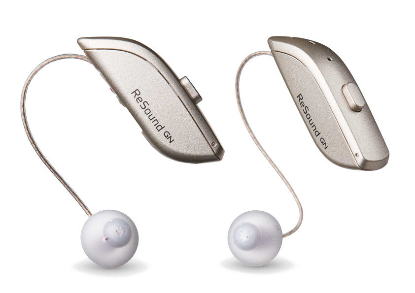

After you finish your quest these will be the next pair of "speakers" you will need
