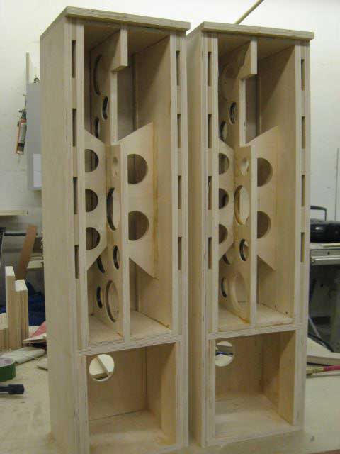

Scott, we're talking about that middle piece? Do I need to make the same circle shaped holes? What are those actually doing in that Lotus (and other your designs)?
Dave, use more braces -- including bracing the braces? But how?
Godzilla, tnx for the sugestion I might try BIB after Chang... I'll need second set of cabinets for BOFUs anyway. I just wish there were some ppl around me with few already made cabinets of the BVR/BIB/Vofo variety, so I could hear them... But alas, no chance of that.
Voids can be any shape. We have good hole saws so they tend to be round. I can't prove it, but i also have a feeling that they leave the brace stiffer.
1st thing i'd do is extend the brace to full height. What is shown in the picture is primamrily a driver brace to spread driver reactio energy to the back of the cabinet.

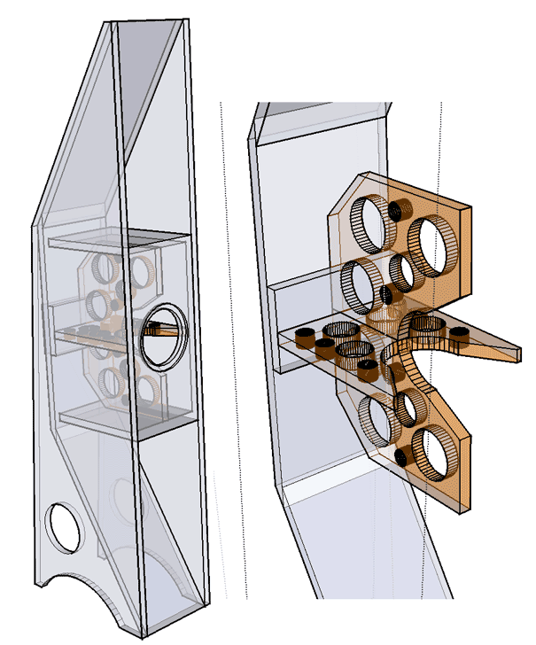

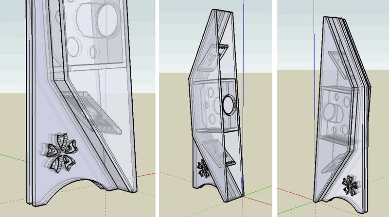

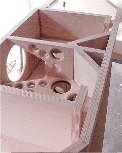

You can also brace externally, ie an exoskeleton. See the attached pictures and visualizations. With sufficient bracing, you might well get away with 12mm thru-out -- no laminating (except maybe sides & baffle)
Do not place any braces perpendicular to the baffle just behind the driver.

Fascinating. Those braces edges and voids are rounded (beveled)?
Should I maybe do something similar to the second example (inner chamber size resembles Chang's one)? I'll draw that on the G Chang pic later...
That really is unecessary... it does have some very minor theoretical pluses but is a whole lot of work. The box with the rounded bevels are for $3.5k/pr drivers. No effort was spared.
You say the driver brace is to spread driver reactio energy to the back of the cabinet, how is this affecting the sound?
Just curious...
Instead of dumping all the reaction energy just into the baffle where it is very likely to be heard, it shares that energy among baffle, back & the brace -- also the top and botton, if full length. Sharing the energy greatly reduces the likelihood of enuff energy being available to start a resonance, and if one does, there is more material to damp it.
