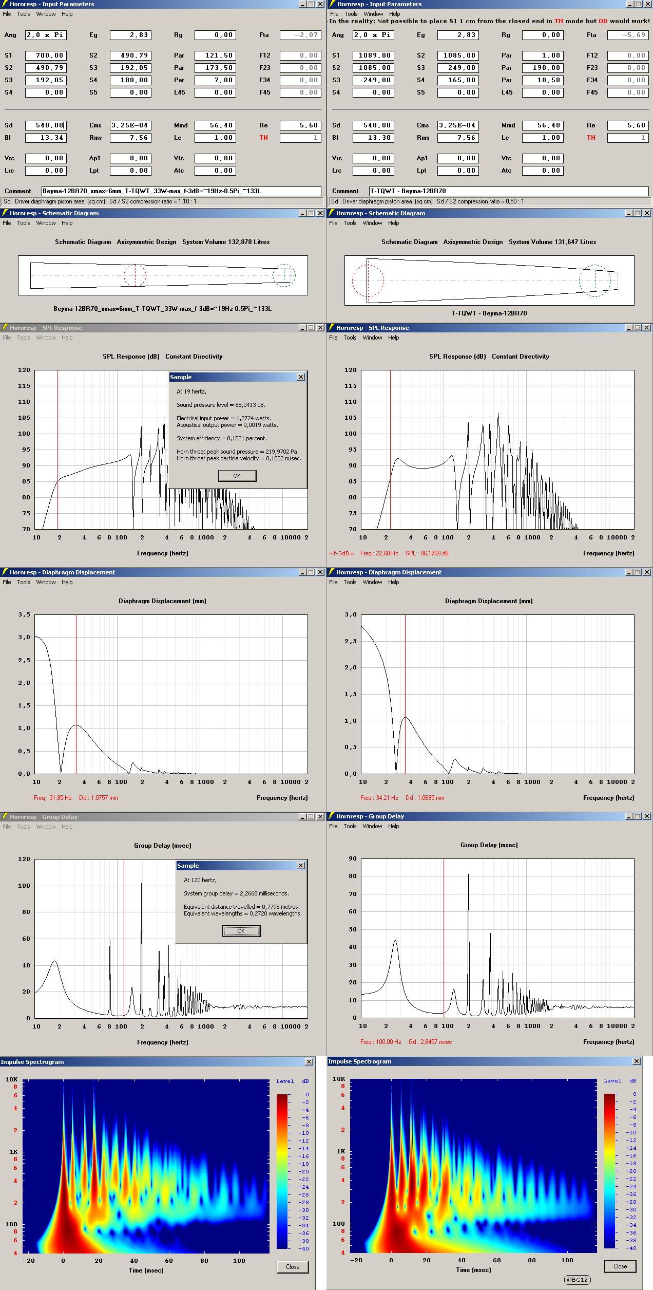

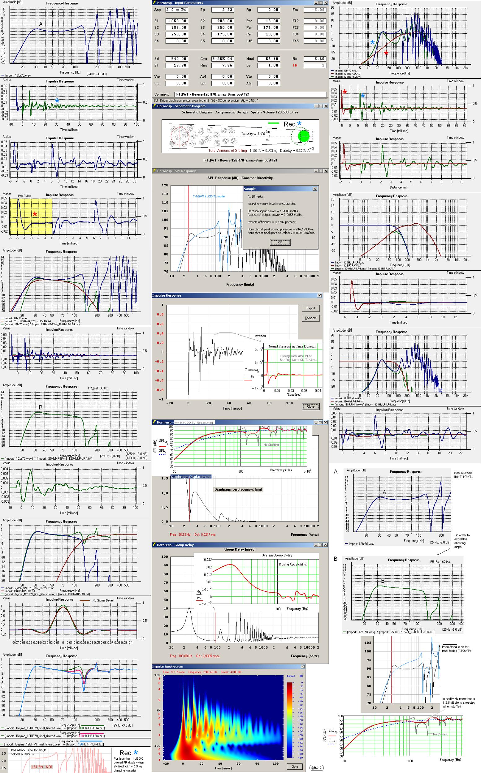

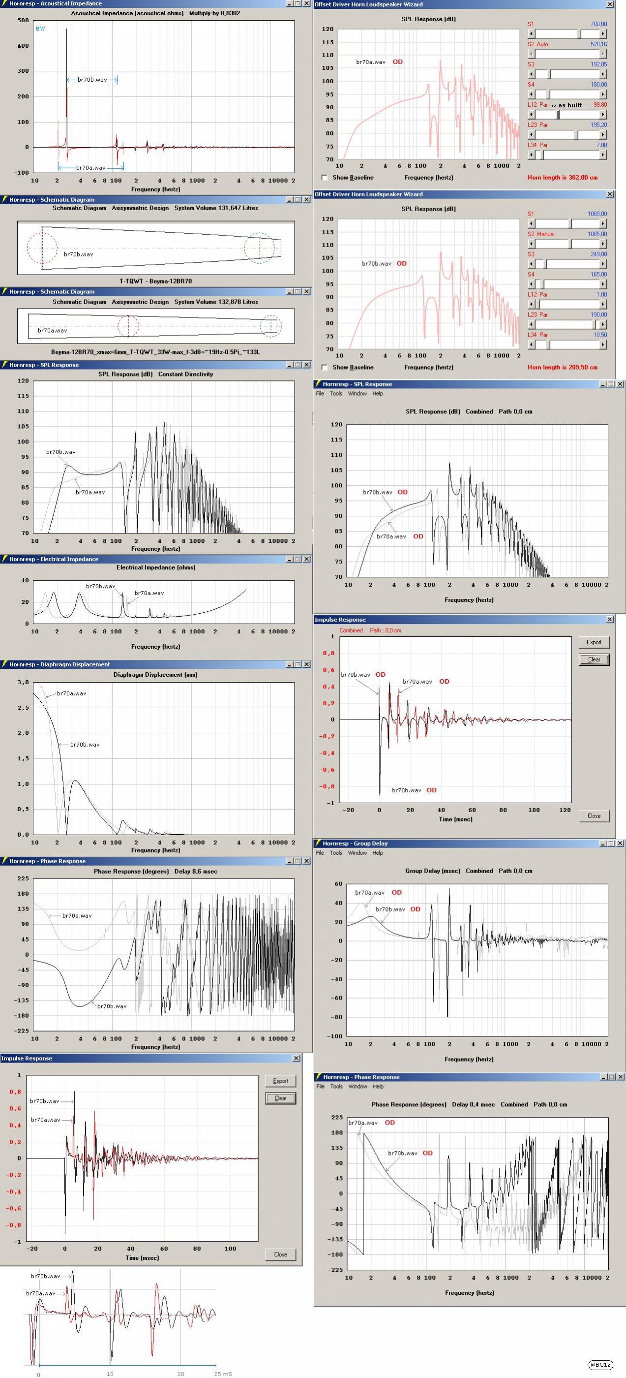

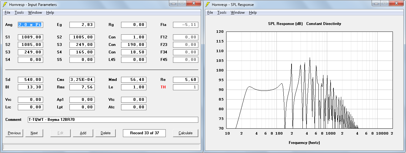

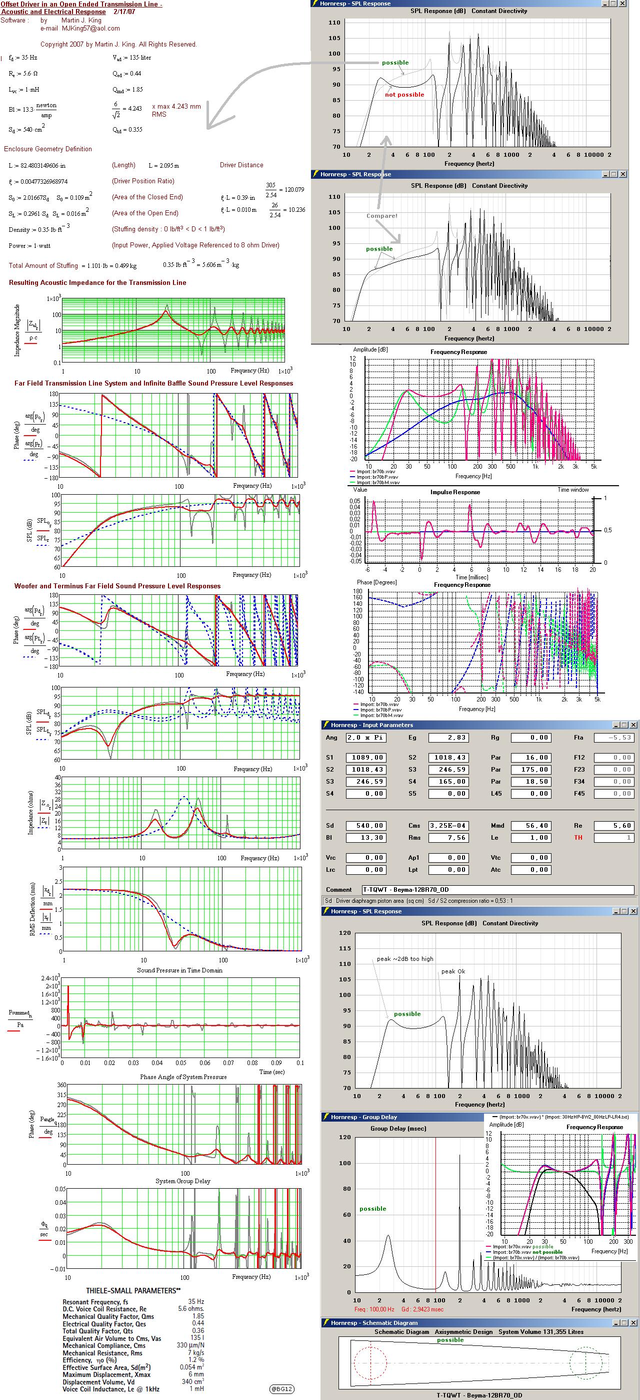

KaffiMann,
Have a look at the following simulations:
b 🙂

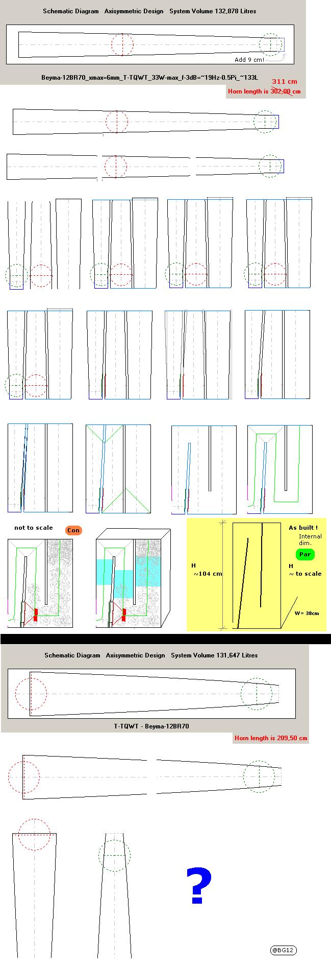

Bjorno:
Thanks for all the work, but that design i posted last is not even up for consideration. As i mentioned it's: a) too deep b) the driver will sag over time, making it another deal breaker for me.
Regarding the possible/not possible part, what i did was take the very beginning of the tqwt, before any sort of tapering has occured, and put the driver there, on a 33x33cm board (1089cm2), big enough for mounting the driver.
Which part of it is not possible?
Sure, i am not even remotely interested in it, but why is it not possible? Is it because of the way hornresp simulates TH? It is still a tapped design, just a different one.
I really appreciate the help, and the frequency response you get out of those double fold simulations are very good and promising. However looking at the box dimensions you are basing it on, it seems like it will be a problem with depth, It will be difficult to have a box depth greater than 40cm here (materials included).
I am still considering the solution from post#15 for simplicity and ease of build as well as size.
A lot of the music I am listening to have extension down to 25Hz, in an ideal world it would be nice to have flat response down to this point. But given size restrictions and room modes it seems like a near impossible task. So again, I am forced to compromise.

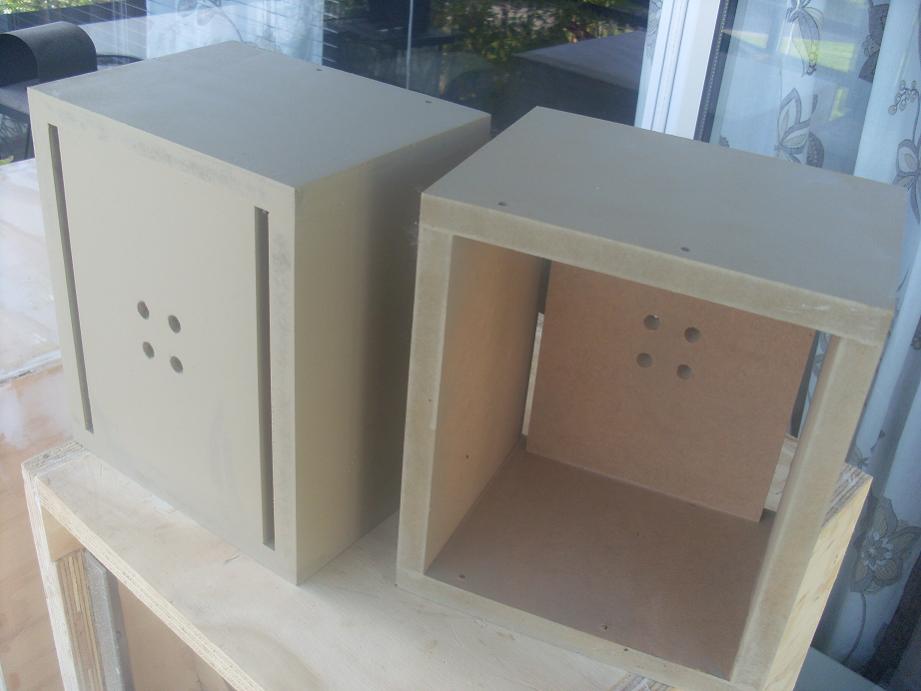

This is taking forever to finish. The kids are having a nap, then we're going over to some friends to eat whole roasted suckling pig, Bali style.

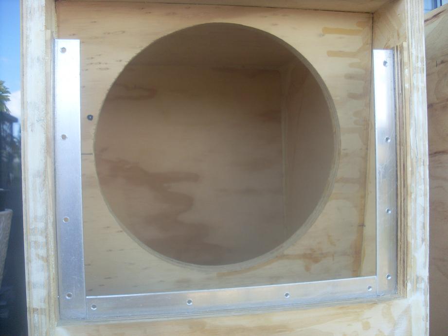

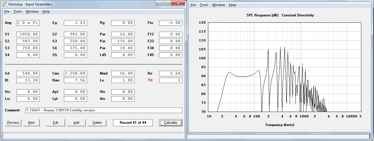

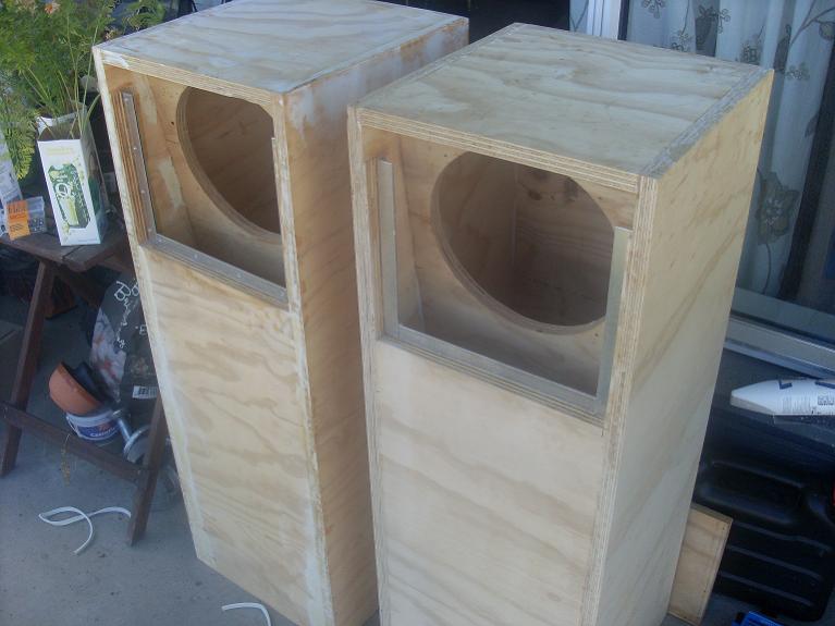

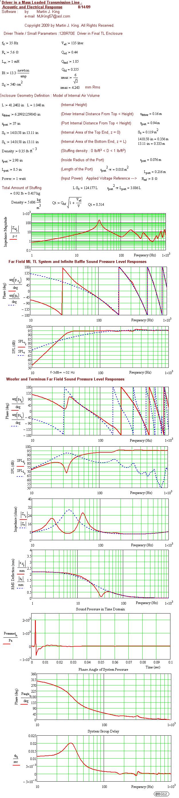

Here is the hornresp of the thingy's I am building, and a photo of the uglies. As well as a close up of the Beyma 12BR70, very much value for the money, I think it is magnesium cast frame? Not sure, it is a very light and stiff material anyway. Also a picture of one of the amp channels assembled including SMPS, and both the boxes that the two amp channels wil go into, not finished.
I have tried firing up one of these, and the two of them may end up beating my big TH into pulp, at least under these difficult room conditions. I gave it hell and it rattles the room evenly down to 23-24hz where it gives up fast after that.

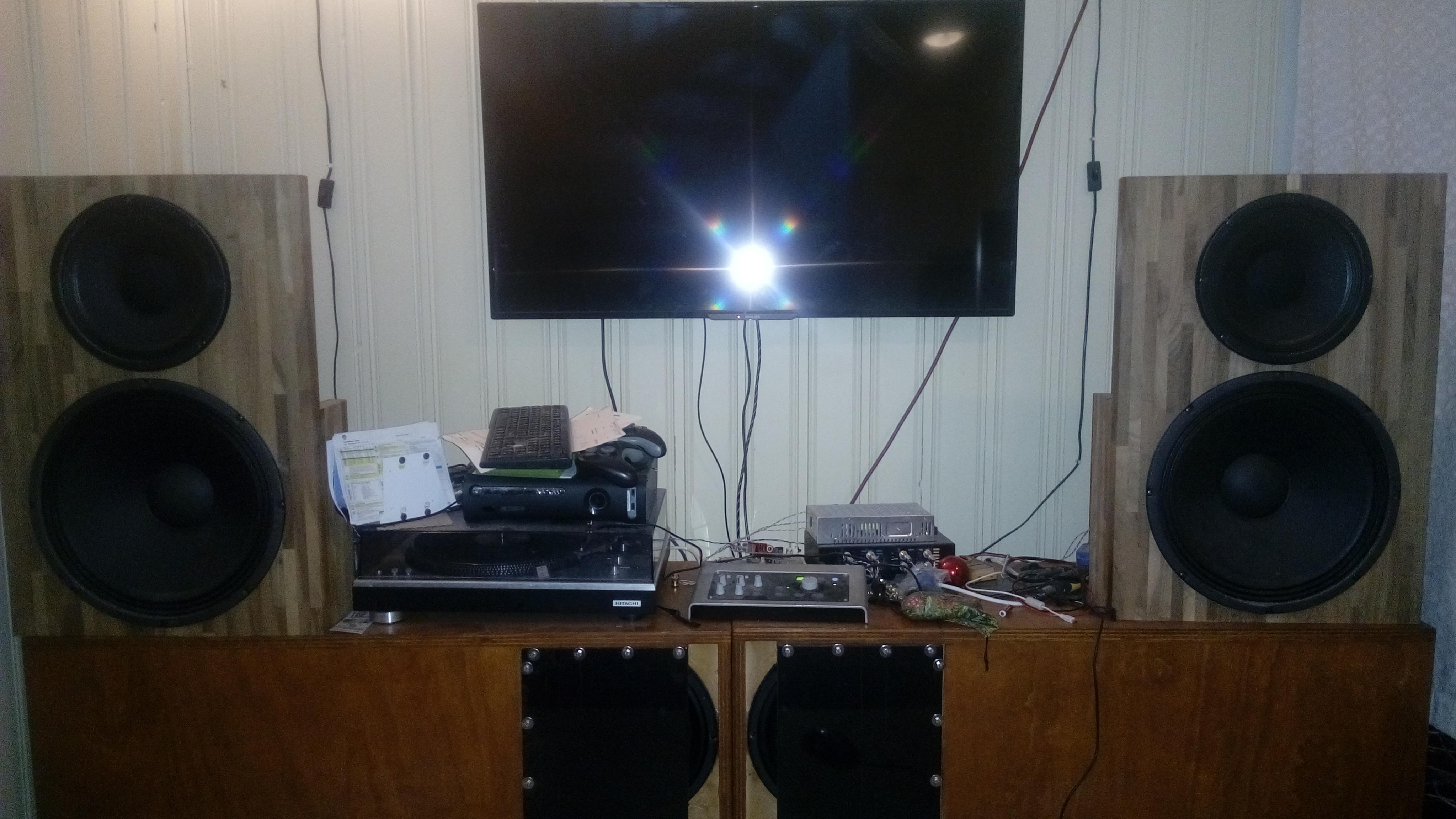

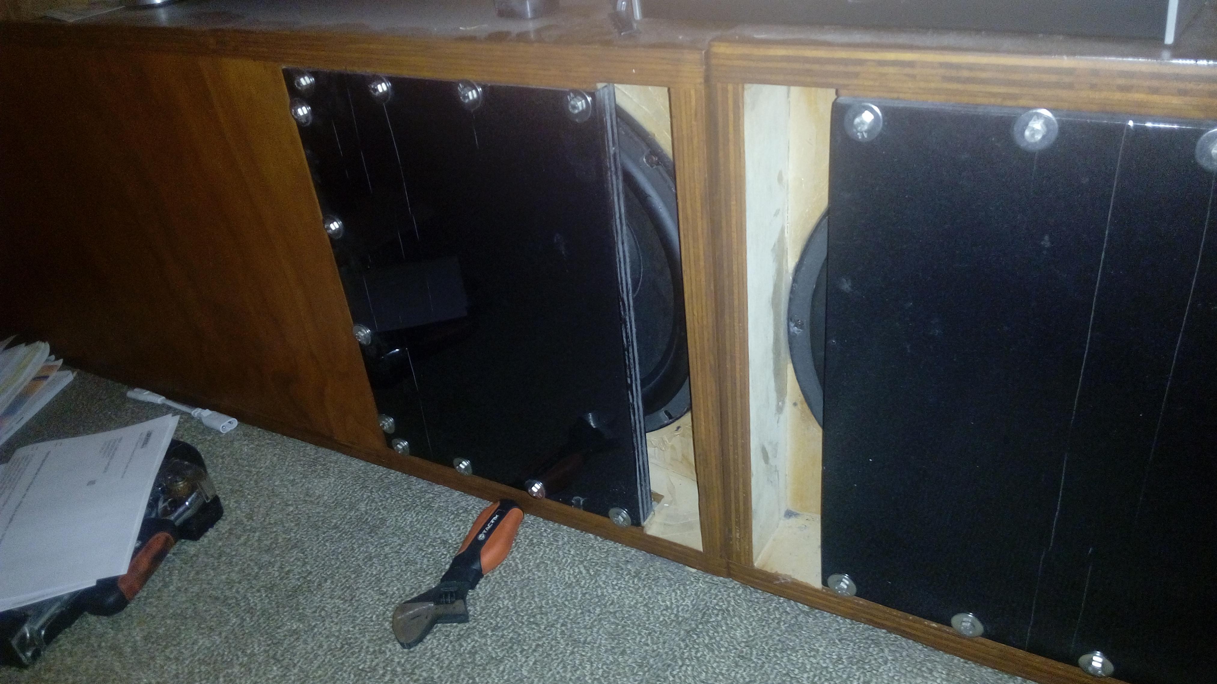

I have built 2 of these T-TQWT's, the brief tests I have conducted so far seem to give way much higher SQ than from the TH. A lot faster response/better timing. But I have not had the time and/or opportunity to test with both at the same time yet, I will take some pictures and post them along with a short comment on the sound when they are finished.
They are currently at a car paint shop, I just got 1 of them sanded down yesterday, took me the whole evening, I have never seen wood shine with no oil, varnish or coating before. It is beautiful. The harder parts of the wood reflect the light differently than the softer parts, we tried sanding the top up to 800 paper, it is very smooth and good looking.
I am torn between finish choices here, the original idea was to use a chestnut+ cherry varnish mix to get a darker and warmer glow, then coat with silk-matte clear finish. I was considering going black metallic for a while (will do that for the amp boxes and the access lid on the T-TQWT's), and now I am considering just adding a silk-matte clear finish to show off the somewhat rough ply boxes sanded down beauty more.

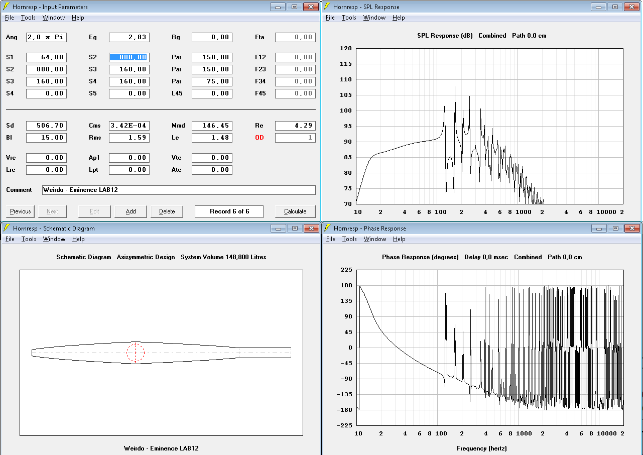

Is this feasible?
I've been playing about with OD designs and I've seen you post some of them as well, have been thinking about how low can you go with a reasonably flat response, dreaming of 15hz at <150L... 🙂
This is scalable up or down in frequency, just keep all the lengths at the same ratio to each other.
Edit:
I experimented with lengths and sizes A LOT to get to this point, it seems that if you find the correct size for S1, it can be scaled down and not impair frequency extension much, this seems only valid if you have similar lengths at L12 and L23, but I have no idea if it will work.
Edit2:
there is nothing in the way of adjusting L12 to reduce size, but smoothness, extension and phase will be heavily influenced.
..Is this feasible?.. but I have no idea if it will work..

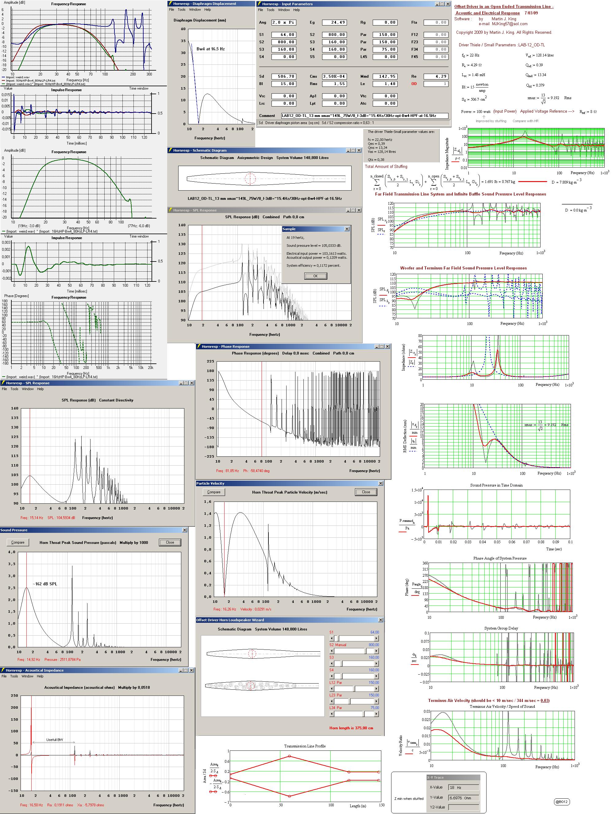

Hi Kaffiman,
Your design is feasible and will work fine! The submitted picture:
I've made quite a few of very similar designs starting ~ 30 years ago.. ended using the Peerless 830452 when first released with designing a IME very good sounding Sub used from ~ 15 Hz to~ 50 Hz that I had tailored to fit a huge bookshelf, placed at the dead center in the system set-up.
Later I started to use Aluminium drivers in OD-TL and recently( a few years) only in T-TQWT's/T-QWP's or T-MLQWP's that sounds IMO superior and act like point-sources.
b🙂

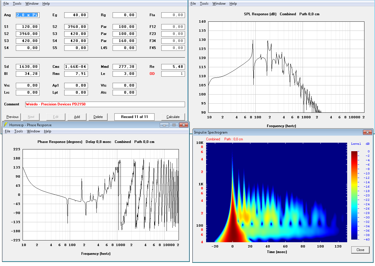

Very interesting.
Since I am getting rid of my TH I have nothing to put my TV on, considering building something "extra" to act as a stereo and TV bench 🙂
Not sure if my wife will approve yet, but she was the one complaining over moving out the over 300L TH in the first place 😛 She likes it, and it keeps the kids away from all the wires.
So all in all I have about 200-250L worth of space if I fold it right + materials(preferably 150x60x36 cm or less including material, a little bit higher than the TH), looking to press out a little extra in the lower regions if possible. Goal is basically as low as possible from 30hz down at 110DB or better in halfspace, max power 300W regardless of impedance. Silly and near impossible, but still a goal.
So I am just going over the options. Waste of time?
Acoustic peak at 12,22hz, the simulation is below xmax all the way down at 40V.
Maybe a 10hz HP would be smart, I imagine LP at 50hz, phase=0 there.. May also be a benefit to glue the driver tight to the enclosure, I've found this to reduce needed xmax before.
I do not have enough room for this, but a guy can dream.
Edit:
Not bad for 490,2L?

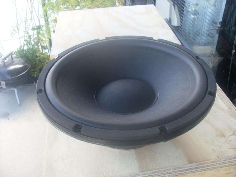

I got some questions regarding the beyma 12br70 and thougth I'd better post some pictures of their current life. Works pretty well, certainly given me a reputation in my new neighbourhood.
