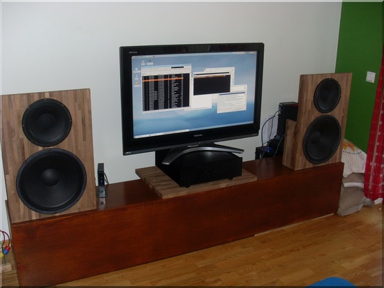

Long story short: buildt a >300l th with 2xpi sensitivity at 95db 70hz -5db 19hz. aka my stereo bench. placement is highly limited, i can not put it anywhere else. the placement is into corner and it seems like room interaction is insane, i can hear sound out of the sub just fine up close, when i move about and sit in listening position i get mainly 40hz. the suspects are a door very close and an air duct near the ceiling, bass is better (more even) outside the apartment...
I need directional speakers!
will post picture of setup later, but i need suggestions to new builds. if you have any good alternatives please do not hesitate to post them.

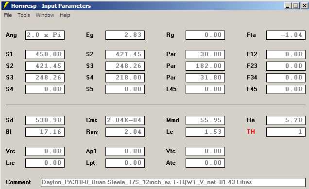

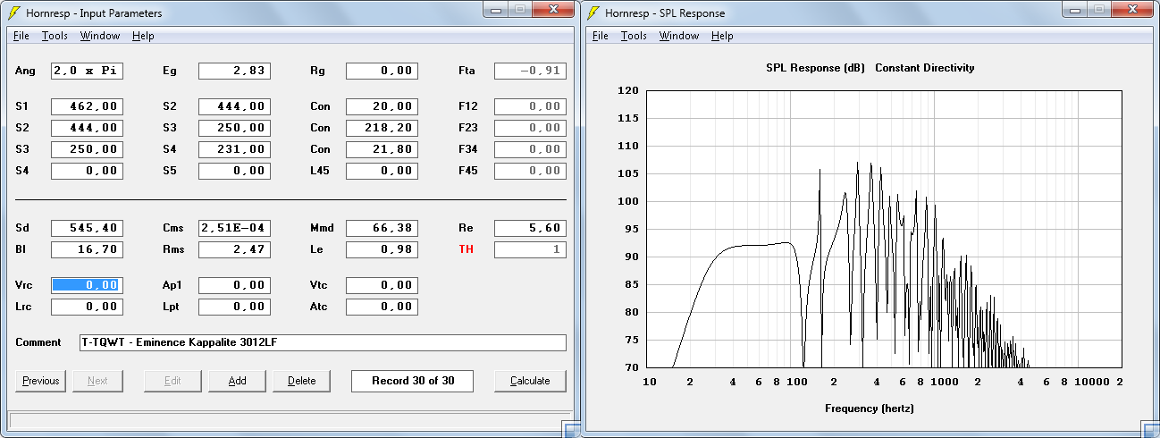

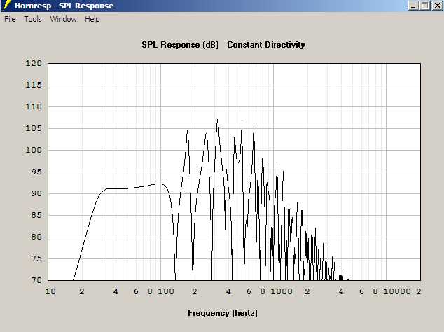

Hi KaffiMann,
People seem to have very good results with bjorno's T-TQWT. I'll attach a quick Hornresp simulation for the PA310-8:

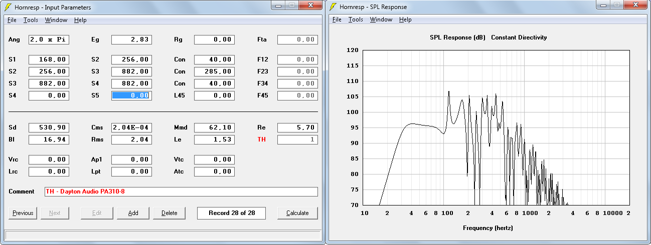

I've got the PA310-8 (it's the driver I used in my POC TH). I wouldn't consider it for a 30 Hz design.
Thanks for the heads up Brian.

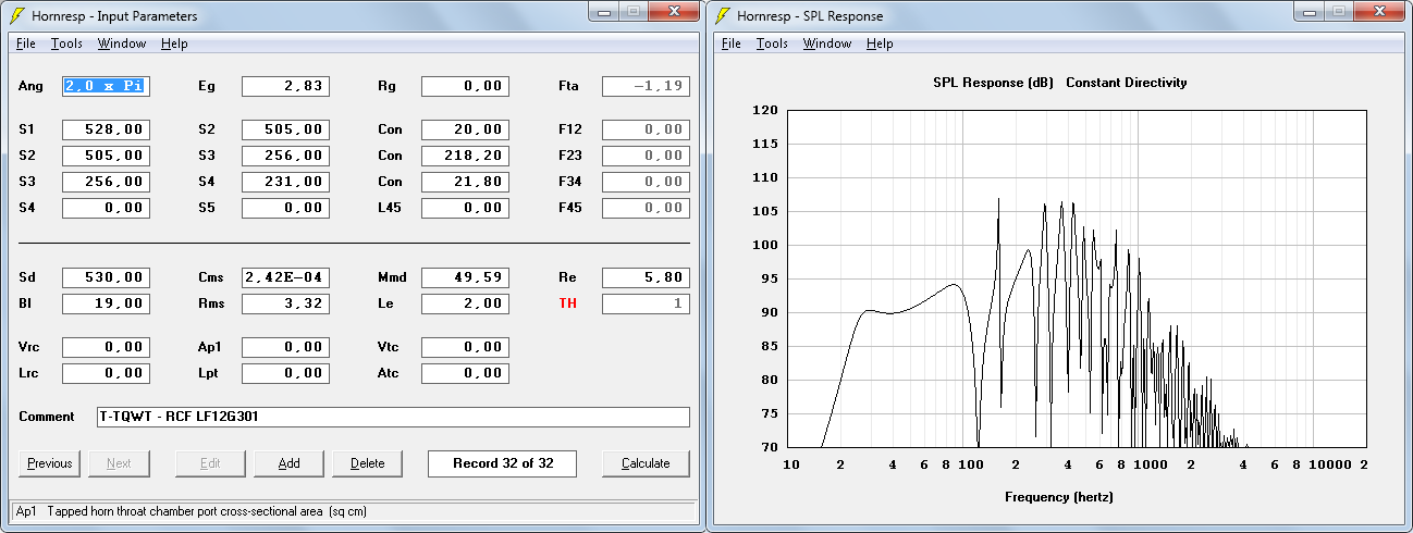

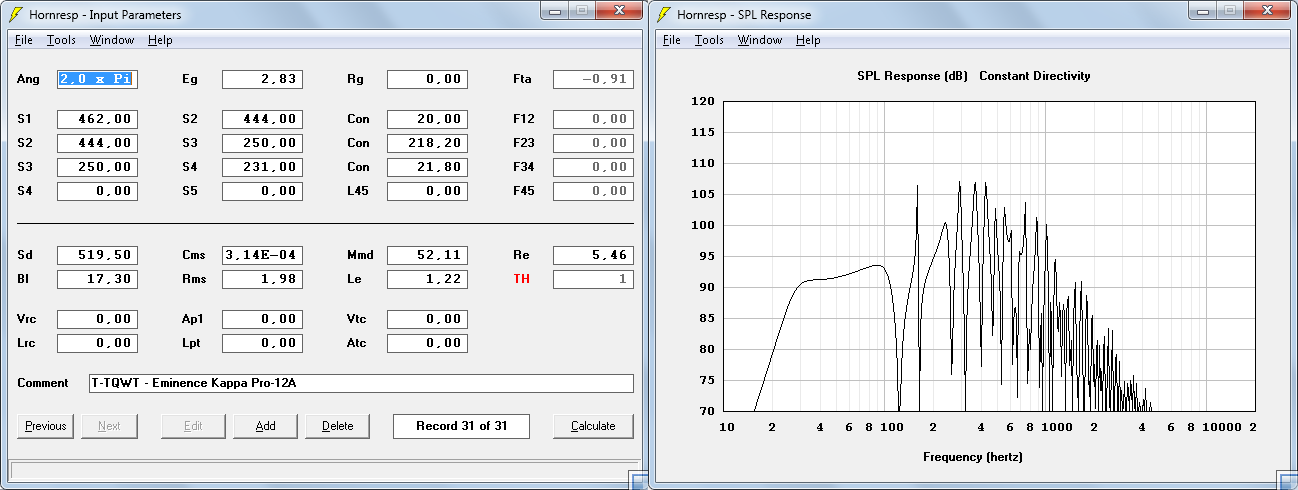

Exact same design with Eminence Kappalite 3012LF and Kappa Pro-12A.
Edit:
Not taken into account mounting of driver (Depth)
Edit3:
RCF LF12G301 looks really nice, mounting depth accounted for.

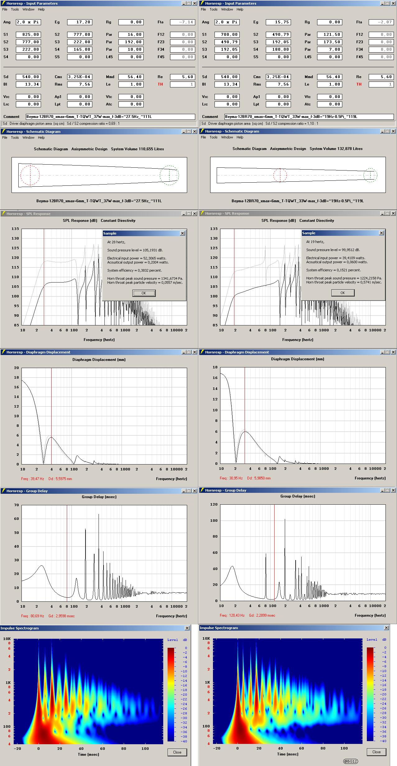

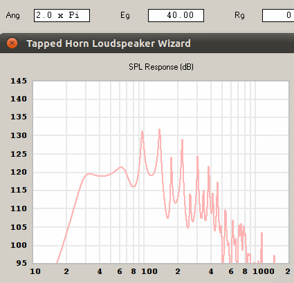

Titanic MKIII 10" in tapped horn maybe?
It comes close to the 95dB sensitivity requirement, has a usable and effectively flat 30-80hz bandwidth, box size isn't too terrible huge for a horn either (under 200l).
I honestly don't know enough about horns to say whether what I am proposing is a good idea or not, but it is an idea
Get more opinions.
I'm thinking a pair of such units would probably be more at home as bass bins in a sound reinforcement system, but hey, they could double as house deconstruction duty.
Eric
[PS: attachment #5 below is peak particle velocity @40V]
Eric
Dangus:
Tactile inducers are interesting, but it would only be as an addition/supplement.
mdocod:
That is not really interesting at all, the box is significantly larger than what i posted, the frequency response is poorer (from my point of view), it will be difficult to place the box properly in-room, i am trying to get bass in ear height.

As promised, I am posting the design I have decided on.
The box will be 38*37*115 cm with 2,4 cm material thickness, choice of material will most likely be baltic birch ply, 12mm doubled up. Total volume of box including material is 162L. Changing to 18mm single would reduce the volume a lot in theory, but in reality the difference is at most 1,5cm in any direction.
So to sum it all up, i have decided to trade low end for wider frequency extension, and spl for flat and even response.
Thanks to Bjorno for coming up with this, and tb46 for reminding me.

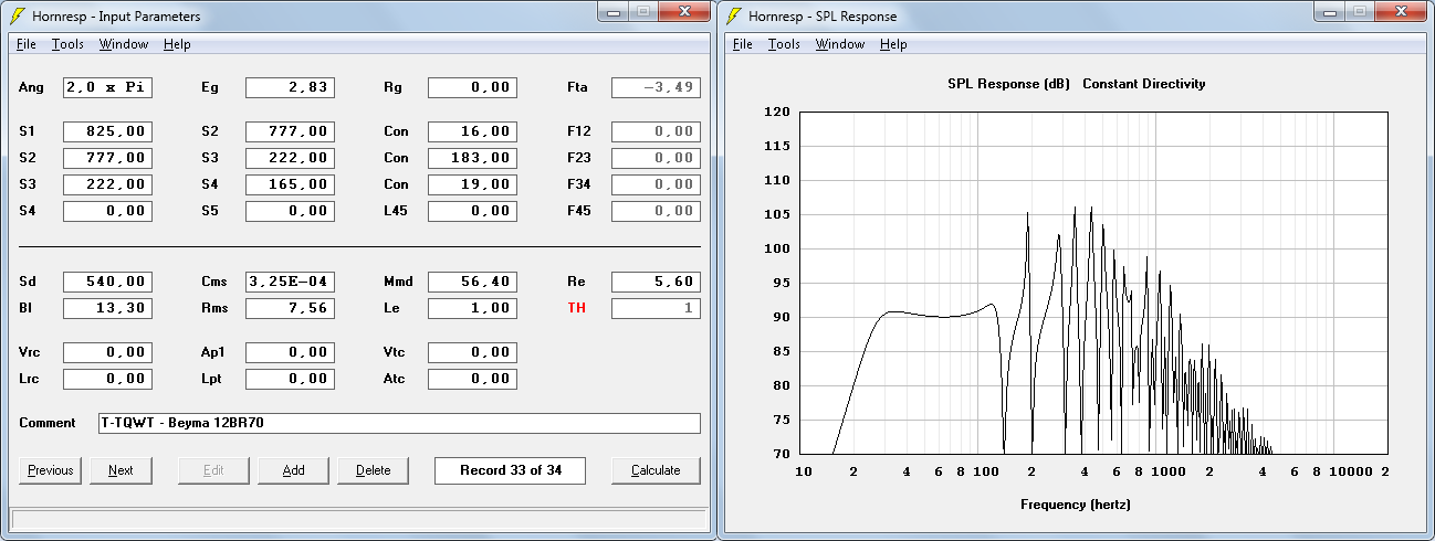

KaffiMan:..Sorry about the bump!..

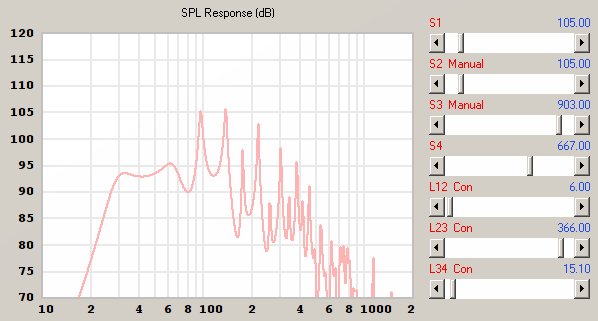

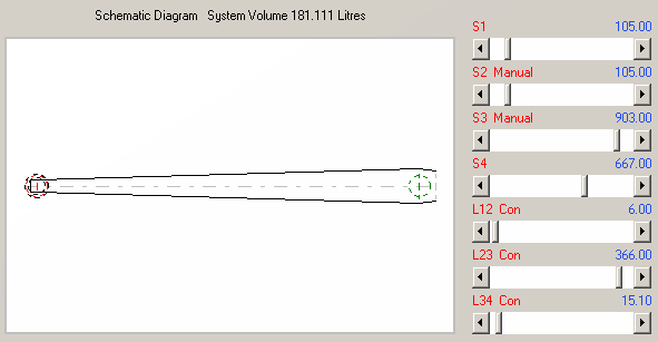

Hi KaffiMann,
I'm bumping too..Submitting a simulation using the preffered Beyma-12BR70 drivers.
I believe the OD_T-QWP corner placed would be a good choice if combined with FR drivers:
b
Those are very nice looking.
But i have some questions:

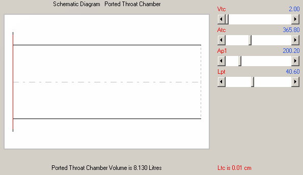

How can you get L34 at less than radius of the driver? If you just made a hole more directly in front of the driver instead of at the end of the box, would you not get any side effects from the cavity, or is part of the driver out in the open? How can this be calculated? And what about material thickness, should i not account for it?

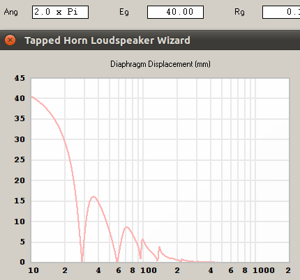

I am also wondering about the xmax when using hornresp.
In the TH i built last year the membranes have never been moving more than maybe 2-3mm total (both ways combined) at levels that should give 6-8mm excursion (enormously present bass, very physical, seems correct), and on the Tangband "horn" i made the year before (flat to under 25hz), the membranes of the drivers are moving no more than 4mm total (both ways combined) when the predicted movement should be far higher,around 10mm.
The response seems just fine from both designs, it's just that the drivers seem to use far less excursion than they simulated in hornresp. This is also the case when using 5hz, they are moving more, but less than half of what my simulations gave, and still well within xmax at high levels, even though i should be exceeding it by a few times.
So either i did something seriously wrong when building but still got the same frequency response, or hornresp have big trouble calculating excursion for tapped designs.
So on this next project i will be aiming for xmax *2 on the simulation on my desired maximum power rating of 28,3V in 8ohm, i assume i will (hopefully) still be under the xmax of the driver, and if i am wrong then i just have a good excuse to try something new and improved yet again.
