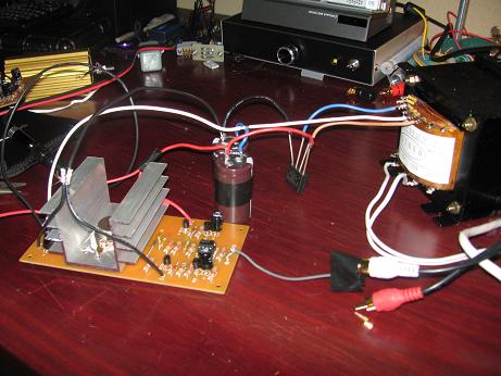

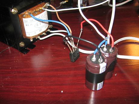

ok, well i used the 17.5 volt leads on the transformer (for some reason they were reading just below 10vac) and wired it with the center tap connected to the connecting wire on the capacitors, tested it with a dummy load first and connected to the amp across +vdc and -vdc i get about 47vdc, and the center tap to either positive or negative is about 24vdc and the amp is working just fine, thank you guys for the help and again sorry about the noobie questions. and here is a picture of the rough wiring, next step is to clean it up and get an enclosure.
don't connect that 3r0 resistor across 24V.
It will try to draw 8A.
the transformer is not rated for that,
the diode bridge cannot recharge the caps fast enough to support that load and the ripple in the caps will overheat them.
Start with measuring the DC voltage on each half of the dual polarity supply. Check that the voltage across each cap is correct and of the correct polarity.
Add a 1k0 resistor and measure the change in voltage across the caps.
Change to 100r resistor and again check the voltage.
Now try a high load current using 30r resistor. Preferably two of them so that each half of the PSU is loaded. Power rating required>=24*24/30=19.2W (minimum ~=25W on a heat sink).
