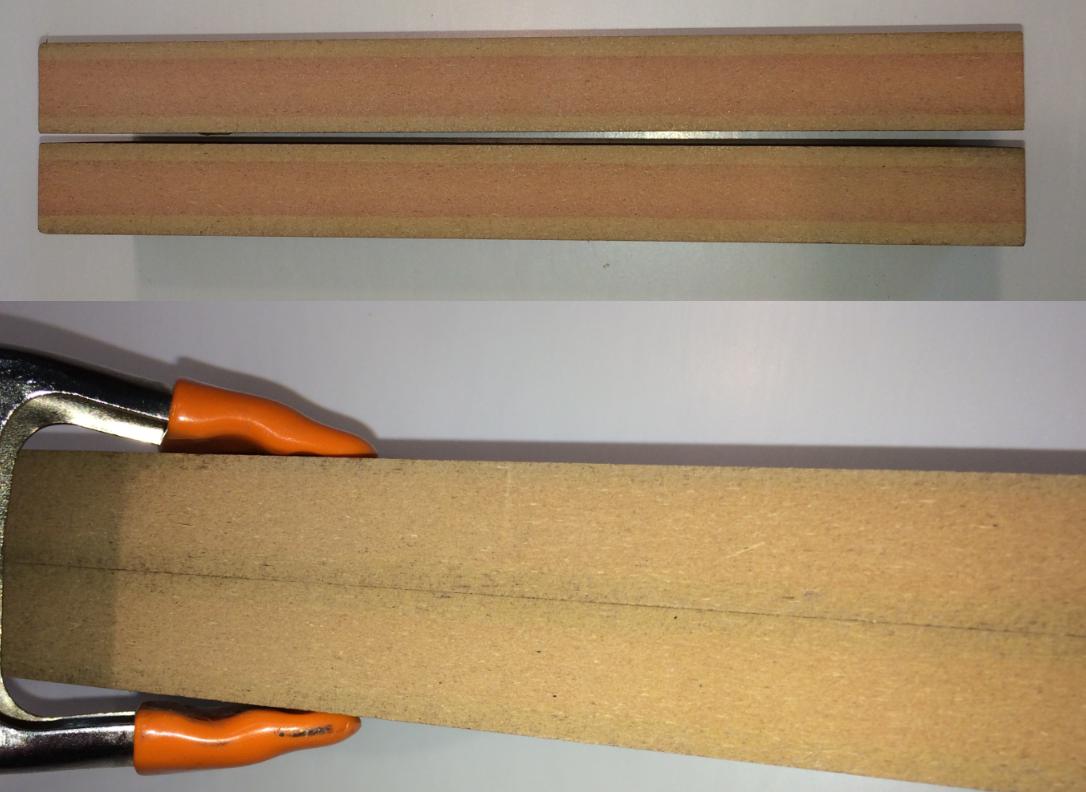

Not a bad idea to make up a pair of mdf test boxes before committing to multi-layer plywood/veneer boxes. E.g. my next project is a Russian Baltic Birch Ply MTM Rendition set.
(btw, Rendition link: http://www.diyaudio.com/forums/multi-way/274085-renditions-anarchy-tmm-mtm-build.html)
Although mdf has a bad reputation, it's not all the same, pic below is a sample of cabinet grade mdf.
In this area the box stores are loading their racks with a low grade mdf, it just looks like rubbery-junk; will never use that for a speaker project! There's also the really dark brown product, it just disintegrates when cutting and dust goes everywhere in a few seconds.
