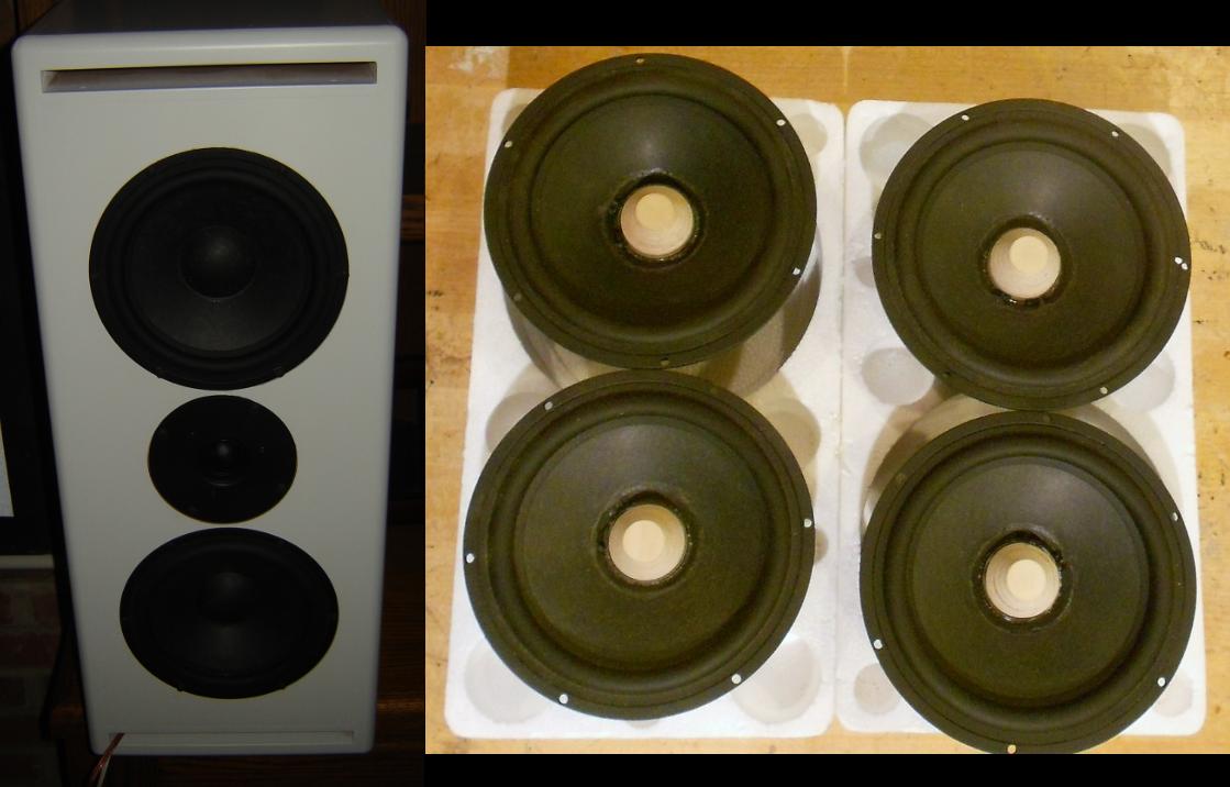

What I'm seeing is a need for 3 medium size mtm's, $166 each, they must be 6 - 16ohm.
This is the direction I'd head:
2 sf 6.5" 4ohm 2x30 = $60
SB 29 RDC =$51
$55 for xo parts
https://www.madisoundspeakerstore.c.../silver-flute-w17rc38-04-ohm-6-1/2-wool-cone/
https://www.madisoundspeakerstore.c...b-acoustics-sb29rdc-c000-4-ring-dome-tweeter/

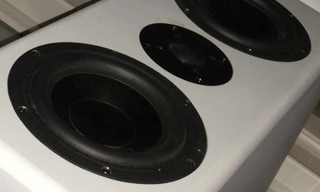

I've been taking the dust caps off and making phase plugs, several ways to make them easily.
Maybe later today i'll put one together and measure (active).
These are incredible sounding HT speakers, the power and clarity is amazing.

My buddy got into using felt dustcaps.
I'm thinking the 8" sf would be as good as my flatish 6.5's if the dustcap was removed.
I'd love to see a before and after freq graph for the phase plug vs dust-cap.
Can you make a bullet shaped phase plug ?
In the white, that's a nice looking speaker there.
Is the rendition better when both crossed at say 100hz ?
Norman
Norman
