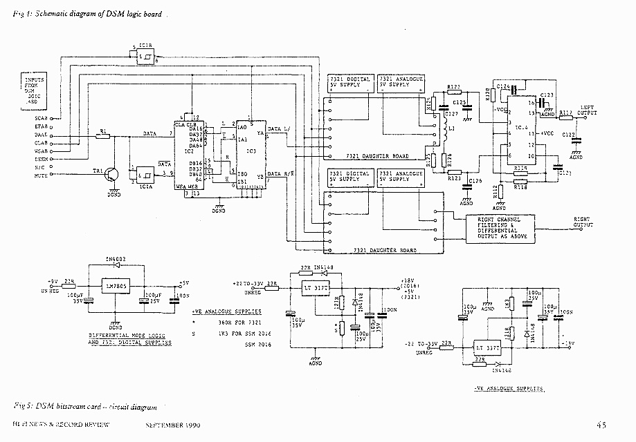

he scematic was published in
hi-fi news & record review, september 1990
part is balanced I2S splitter circuit
the chips are not marked but those are the same chips like in other similar cir.
HEF4517, 74HC157

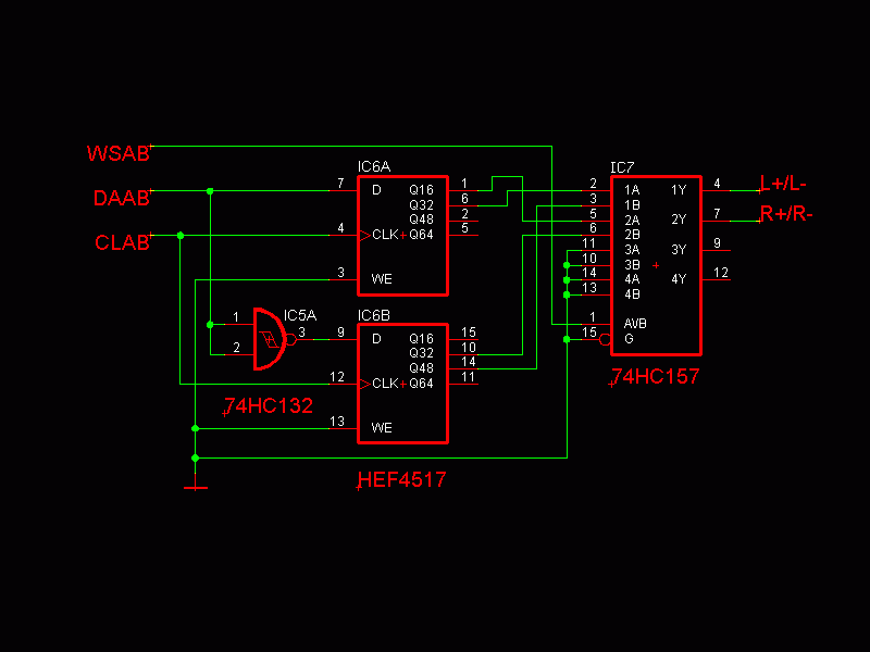

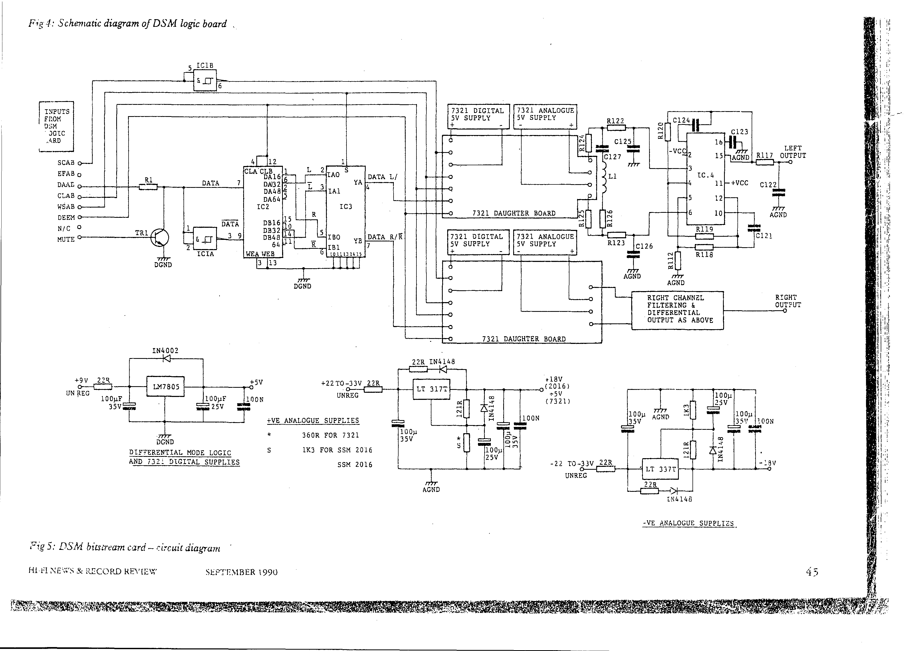

Hi
here are attached few items:
1.the same picture published in 1990 HiFi News, but in better quality - easier to see number of input/outputs.
2. Second picture is same circuit but balanced I2S splitter part only.
3. the article of Pedja Rogic, where is mentioned this 1990 HiFi News schematic.
Please take into account 1990 HiFi News shematic is ok only for 32 bit word (all L and R bits transferred per 32 BCK, as after SAA7210 and SAA7310).
So, if you are going "to steal" I2S directly from CD player based of SAA7210 or SMD SAA7310, this is realy operational schematic.
For 64 bit word (most of SPDIF receivers) we need to use schematics proposed by Pedja.
Those two shematics should operate ok, but with 5V power suply for HEF4517 only for 44.1kHz sample rate. And mainly for NXP HEF4517, other clones of 4517 can be simply to slow.
For higher sample rates here is a way to increase power supply to 10 - 15V, almost proportionally decreasing propagation delay, but then you need to play with pull up resistors and diodes to protect 74HC157 inputs from overvoltage. The you can freely use not only NXP IC.
I'm going to use in my project both schematics as I have both types of I2S source - 32 and 64 bit frame.
